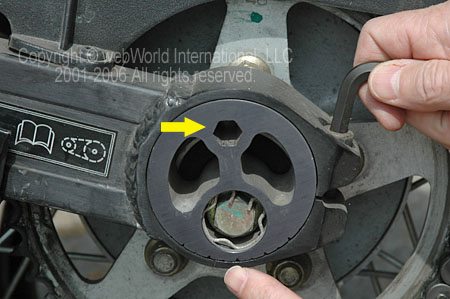

      Hi,
      I'm making a pair of eccentic chain tensioners for a project I'm working on. The piece is a 38mm stainless steel bar. I have drilled a 12mm hole for the axle and 2 x 8mm holes for the tensioning tool to tighten the axle.These are like a trangle inside the diametre of the piece. I have a small clarke lathe. I tried parting off and the moment the parting tool (It's a glanza tool with inserts and a 2mm wide tip), broke through the first hole it jamed and bent the tool holder and the tip fell out. Before that it was curling off swarf perfect. I reversed the tool in the holder and fed it in at a slower rate and near the centre I heard a crack and the tip of the tool broke. I've no formal training on the lathe and any help to point out where I'm going wrong would be really appreciated.
      Image of something similiar if it helps
      http://www.webbikeworld.com/motorcycle-maintenance/chain-adjustment/pinch-bolt.jpg
      Thanks,
      Aidan.

          The tool tip is under pressure… everythings going great with a steady stream of swarf…
          tool breaks into first hole and pushes forwards, tool tip now cutting 2x 3x 4x the amount it was a millisecond ago, and bang
          an ultra slow feed rate might help, but it would probably blunt the tool
          Doing anything you can to maximise stiffness would reduce the amount the tool "springs" forwards when it breaks through
          If you can't improve stiffness then an upside down tool at the back will have more chance of survival than a tool at the front

              Thought 1 – take the work out of the lathe, saw it on a bandsaw, return it to lathe to face the end to size. This is by far the safest and easiest way, and there's no shame in sawing when parting is not working out.
              Thought 2 – make close fitting bungs of the same metal, loctite into the holes (to make a workpiece as solid as possible, no holes in the area to be parted), part off, heat the work to release the loctite, pull out the bungs. The bungs could be made a little long to help the pullout, or made with short threaded holes to jack them out.

                    You could plug the holes with a rod of the same material superglued in place, then it would be just like parting a solid bar. A little heat will allow the bars to be pushed out afterwards.

                          I think the best suggestion on the board is to take it out and cut it witht the band saw and face it. I think because it's 19mm to the centre my parting off tool is out further than I've ever had it out before and is vibrating a lot.

                              Got sorted anyway. I took the advice above and cut them with a stainless cutting disk in the small grinder then faced them. Worked out nicely, just had 2mm of extra stock when finished.
