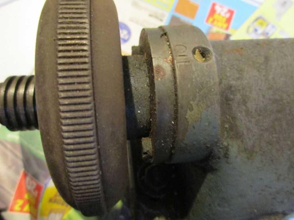

                  OK next question the chuck end has a large drill chuck which is held within a collet which is screw fit the question is is it liable to be just a screw fit or possibly be grub screws. I also assume normal right hand thread that end. I know its difficult to see but wondering if anyone else has had same thing. Bonus no chuck but have collet holder.

                  Ian Usmar
                    @ianusmar79339
                    Hopefully these photos may help The 3rd one is the actual collet66b60770-39af-4884-88e2-6ddf0103c5ff.jpegb3878c9d-6de9-4669-9f03-d4ecf2f1e85d.jpegadec6757-ec61-4499-92ef-e4bc4e6b1eff.jpeg

                    Hopper
                      @hopper
                      Your collet chuck adaptor should screw off the spindle. It's a right hand thread and normally no grub screws involved.

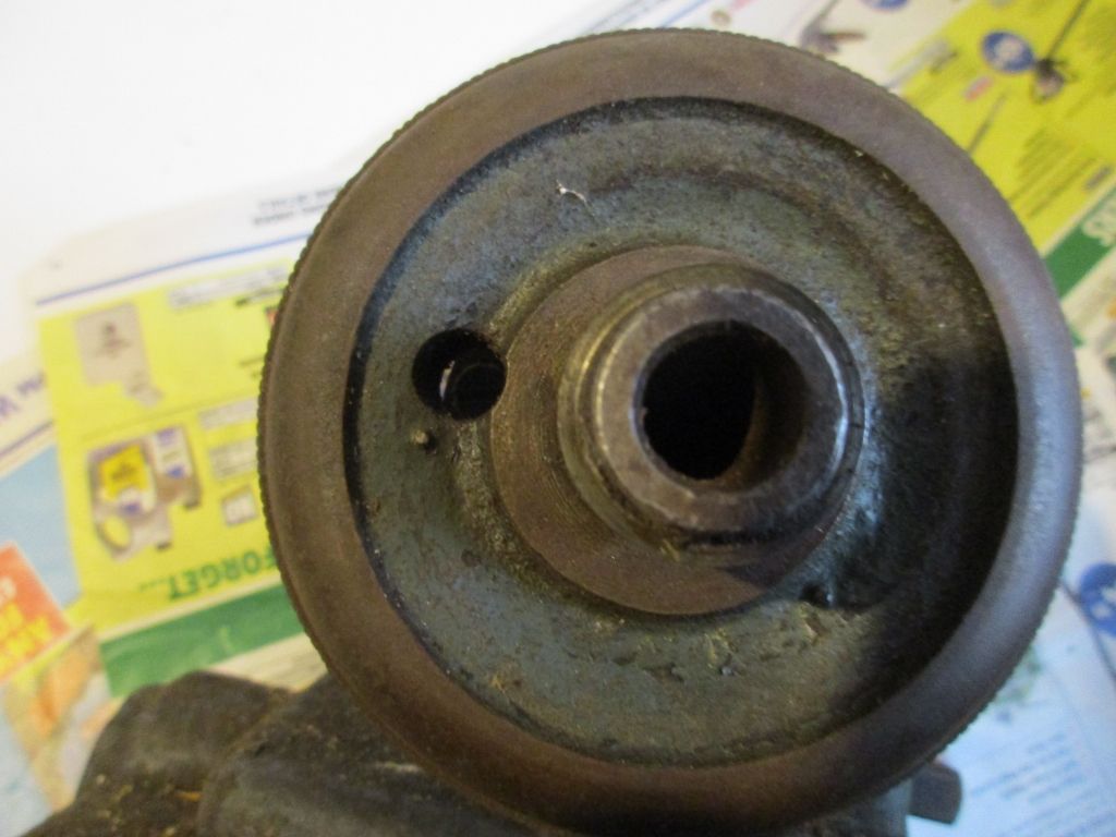

                        Can anyone enlighten me ref the colour, is this a original colour have had a look and seems to be only the one coat?

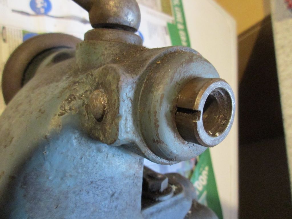

                          So I Ann now the proud owner of a Drummond but I have more questions well two at the moment, 1 My serial number has an "A" at the end any idea what it means? And 2 the tail stock as a small chuck in it but there is no through way to knock it out with a drift what's the easiest way of removal or should the tail stock not be closed off ??

                          Nicholas Farr
                            @nicholasfarr14254
                            Hi Ian, the tail stock barrel should have a 3/8" clearance hole through its length and a drift is used to remove anything that is used in it.
                            Regards Nick.

                              Thanks for your reply Nick the issue I have is it does not !!!! Any suggestions on removing said chuck! I could then workout how deep I will need to drill to make it workable with a drift !

                              Nicholas Farr
                                @nicholasfarr14254
                                Hi Ian, that seems a bit odd, have you wound it out to see if there is a slot in the barrel for a flat tapered drift? Maybe someone has made a new barrel for it at sometime and have only made a taper deep enough for the chuck to fit, or they have turned the end to fit either a screw on or tapered chuck. If it is a normal chuck with a tapered arbor, you could try cutting a slot in a flat bar wide enough to fit over the short bit of the arbor between the barrel and the chuck and then draw the barrel back with the wheel, so that the flat bar will be pushed onto the tailstock body. If the barrel won't go any further into the tailstock body, then you could make another flat bar with a slot to fit over the barrel, thick enough to make up the difference. Another option would be to make a pair of slotted wedges that will fit between the end of the barrel and the chuck, but use them opposite each other, so that you put a parallel force between the end of the barrel and the chuck. One problem you may have though is, if the chuck is a tapered fit onto the arbor, that may come off before the arbor comes out of the barrel. If your left with the arbor stuck in the barrel, then maybe you will be able to drill a hole crossways in the arbor for a pin, far enough away from the end of the barrel to get your slotted flat bar/s or wedges or a piece of tube in.

                                  Nick thanks for this I have tried putting something between the barrel and the chuck and wound it back to put pressure on it with no effect. I even tried a small pair stilsons on the drill chuck both clockwise and anti clockwise again with effect. I tried a little heat again nothing. I am running out of options although I may remove the tailstock completely and taking it from there, unless you have any other ideas. I am starting to thing it may not be a Total Drummond ( The colour is definitely incorrect !!)

                                  Bazyle
                                    @bazyle
                                    Wind the tailstock right in so the screw that is pulling it in eventually hits the back of the taper that has the chuck on it and pushes it out. This is normal on many lathes, eg Boxford, Although most Drummonds have the hole down the middle there are some exceptions. Sometimes the drill chuck taper is too short for this to happen.
                                    If this doesn't shift it skhave to persuade to come out.crew the barrel right out. There will be a screw in the side that stops the barrel rotating, undoing that may still not allow the barrel to completely come out if there is a little slug of brass at the bottom of the hole which you will have to persuade to come out.

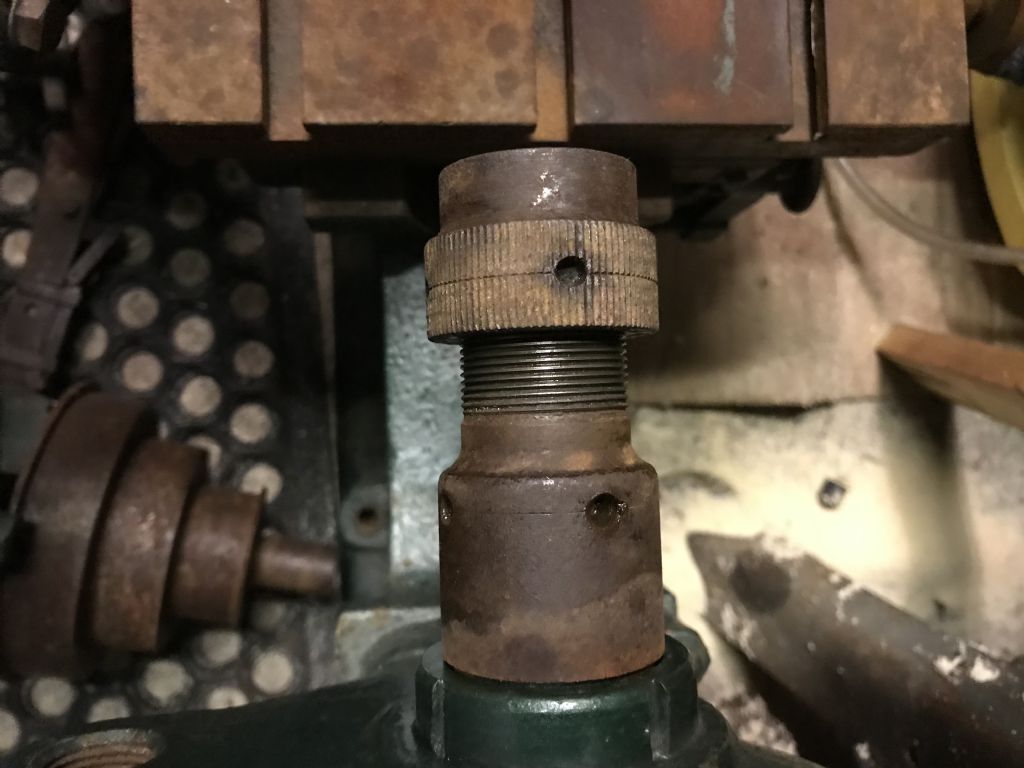

                                    Nicholas Farr
                                      @nicholasfarr14254
                                      Hi Ian, below are a few photos of my Myford tailstock barrel, the first one shows the front end with the No. 1 Morse taper and the keyway on the side of the barrel to stop rotation. Just to the left can be seen the pin through the body, which has a key cut on the inside end which will prevent the barrel from coming out of the front end. this pin doesn't seem to be easy to remove, but yours may have a screw in it as Bazyle suggests, if it doesn't have a screw, you will have to take some drastic action and cut the chuck off to enable you to remove the barrel from the back end.
                                      To remove it from the back end you will have to remove the two screws that hold the keep plates in position.
                                      These should be accessible through a hole in the handle.
                                      Once they are removed, the barrel and handle will be able to be removed from the back end.
                                      Once removed you should be able to deal with the barrel, but of course you might need another lathe or take it to someone who can do it for you, or find another barrel from somewhere.

                                      #389817
                                        Posted by Nicholas Farr on 07/01/2019 10:00:24:
                                        Thanks for posting those photos, Nick
                                        When I dismantled my Drummond round-bed tailstock, I was initially surprised by the appearance of the 'keep plates' … but yours look [almost] identical.
                                        Presumably someone at Drummond Bros. was employed to break cast iron washers in half, and keep them in pairs.
                                        [ if I recall correctly, some engine con-rods were 'mated' in a similar fashion ]
