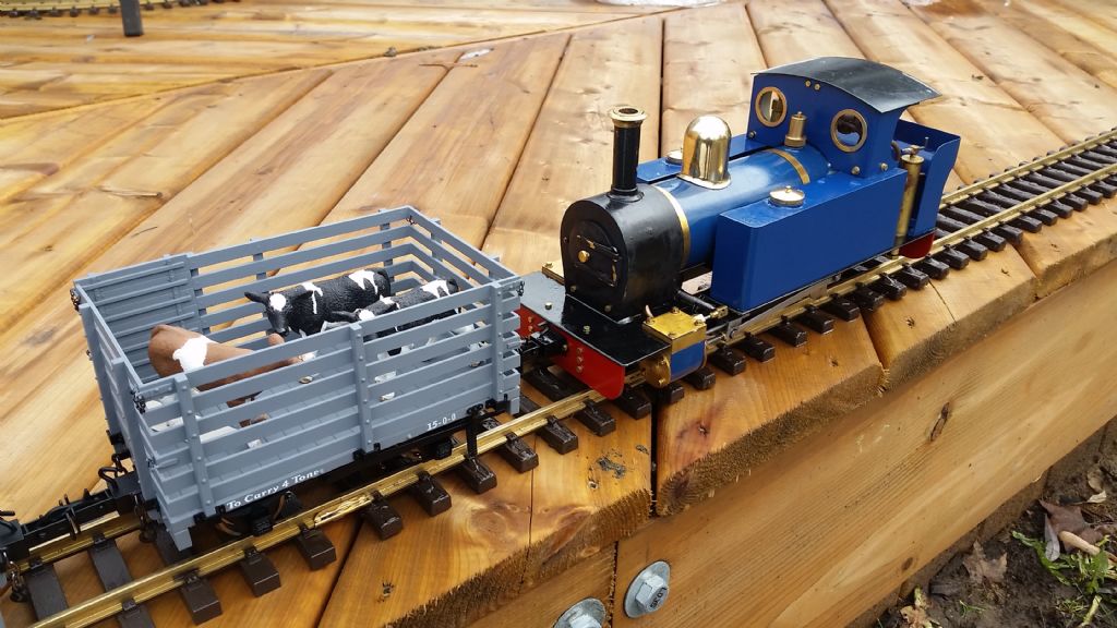

            I'll assume you intend to run on 32mm track. ("Gauge" and "Scale" do not mean the same thing.)
            De Winton type locomotives are a popular subject particularly with those wanting to build something from scratch. If you want something that looks more like a regular locomotive (i.e. horizontal boiler and cab at the rear) a Kraftlok is about the simplest design. face 1

            Robert Turner 1
              @robertturner1
              If you are looking for something one size up from the Cracker, I have just finished a revised version of the `Homemade Dacre` by Erik-Jan Stroetinger. If you google the names, you should be able to find free plans in AutoCAD format. I revised the drawings and expanded them for the imperial sized stock and fasteners available in Canada and to include all of the bodywork which isn`t shown on the original drawings.
