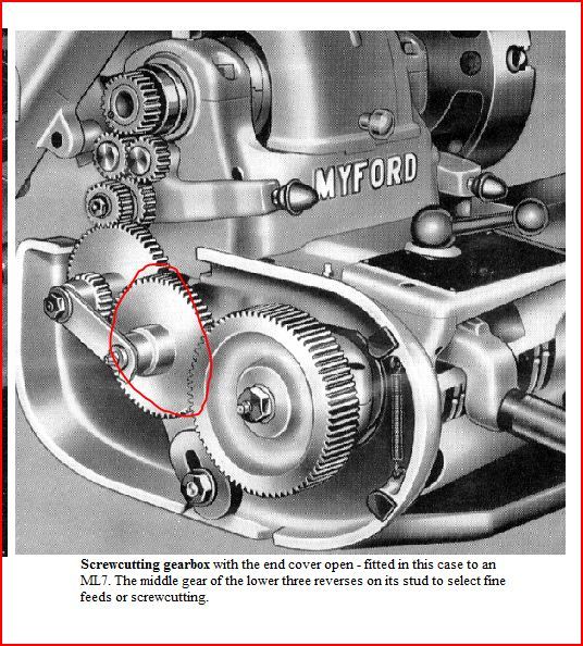

        Can anyone help me with a problem that I just do not understand,
        I am trying to cut a 10 tpi BSW thread on my Myford Super 7 fitted with the Norton quick change gear box, However rather than the thread starting, what is happening is that a very rough cut is being carried out along the work
        I have tried different thread settings but on all occasions I have the same problem.
        To my eye it appears that the travel speed ratio between the lead screw and the work in the chuck is out of sinc?
        I would be really grateful of any advice please,
        Tony

          Have you reversed the compound gear in the train from fine feed into threading mode?

                  John, Now I am going to sound a real novice now so please forgive my lack of knowledge, please could you explain in simple terms how I go about reversing the compound gear, I do not actually know what this is or indeed where to locate this gear, on looking at the work in the chuck it does actually appear to be cutting a fine thread not the 10tpi I am aiming for.
                  Brian, I am trying to achieve a 3/4 10tpi BSW thread, Firstly I select the gear ratio and hand turn the head stock, the gearing seems to all fall in place, I am using the indicator coming on the cut at 2 or 4 gear speed set on slow with back gear in off position and I have also engaged the back gear, this make no difference, Best Regards Tony PS Having a problem uploading photos, I will keep trying.PPS Yes in all gears. Thank You

                    Go to http://www.lathes.co.uk and select Myford from the top menu or the list
                    In the sub menu that comes up, select Super 7
                    First page about 3 photos down,RH side is a very clear picture of the gear train and the compound gear in question.

                        Thank you John, got the info from lathes.co.uk, I now understand, I will try as you advise and keep you posted.

                                A massive thank you all now threading perfectly, your knowledge was invaluable,
                                Lambton, I will do this, thanks
                                Jason, New owner so the pic was helpful,
