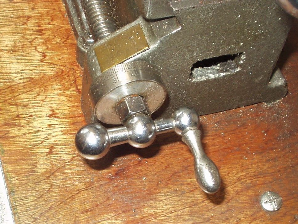

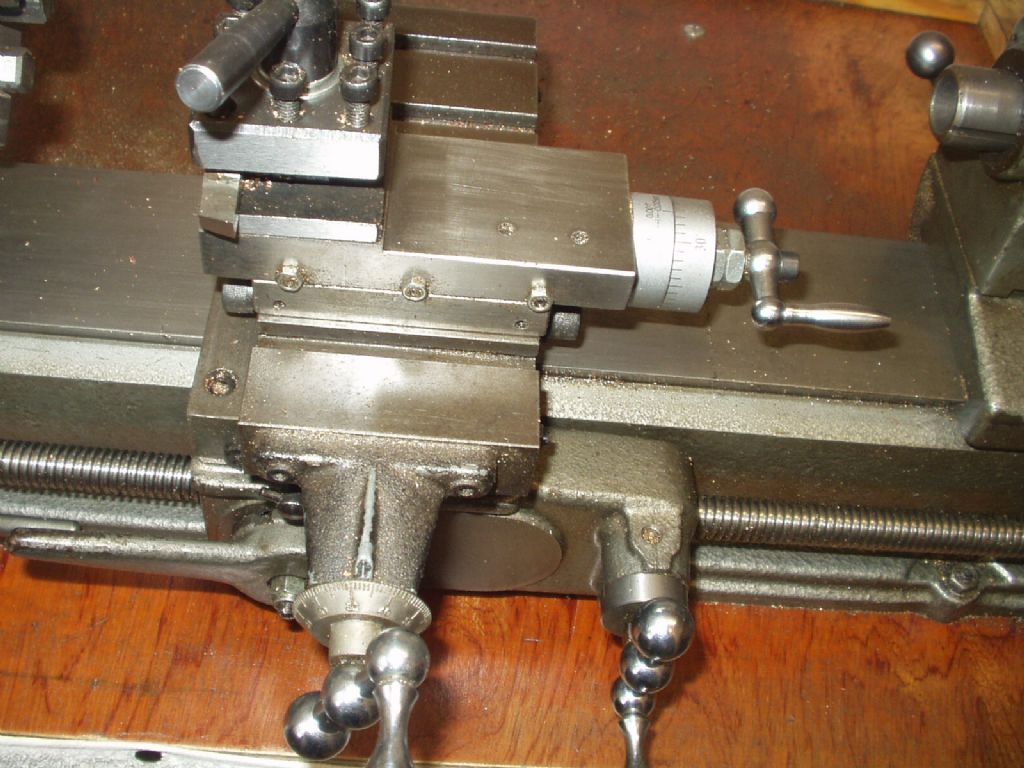

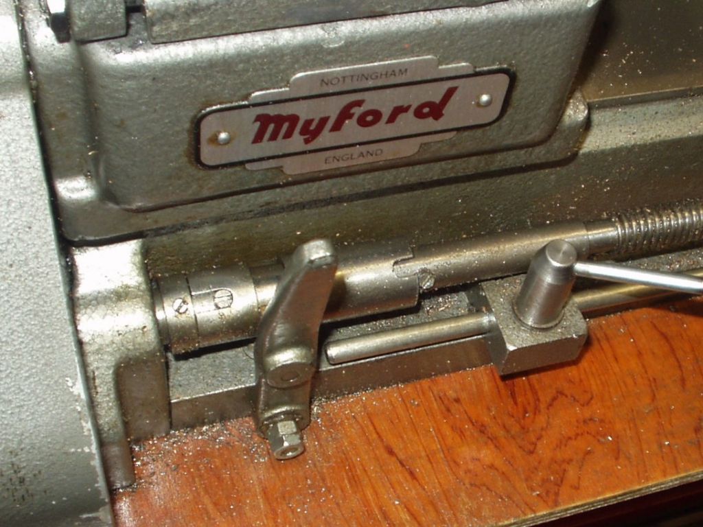

                    Not the best photos but these may be of interest.
                    Leadscrew dial – With an 8tpi leadscrew 1 revolution = 125 thou, so I made the circumference of the dial 125mm and used a section cut from a thin steel rule as the scale, so 1mm on dial = 1 thou. It is accurate enough, and works for me.p1010007 (2).jpg
                    Clutch – the lever obviously is Myford, otherwise from scratch. The lever pivot is mounted on a length of steel angle, shaped to a close fit with the bed and retained adequately by just one holding-down bolt. The lever isn't essential as the clutch should only be moved when stationary. Carriage stop mounted on the RH end of the angle piece – this is another easy thing to make and very useful.p1010009 (2).jpg
                    Top slide/toolpost – this was missing from the lathe when I bought it, so I adapted a Mini – lathe assembly. This needed quite a bit of modification but works well and cost very little. p1010007 (3).jpg

                            Joshua, I'll reload the photos here.p1010007 (2).jpgp1010009 (2).jpgp1010003 (1).jpg
                            Hope that helps.
                            As Howard says a clutch on the motor isn't really necessary for our sort of use, but is a nice luxury, although a little difficult to arrange on the ML10 because of the countershaft design.

                              Higgins1994
                                @higgins1994
                                ah that makes a lot more sense ill be very honest i thought they were the same thing (back/change gears) shows how much i have to learn still haha
                                i like the dial defo on my todo list, i presume you made the brass shim then bored the dial a bit at a time untill you got a good fit or did you work to a specific clearance?
                                    I can't remember exactly, but yes, basically just made it to fit.
