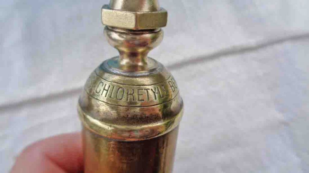

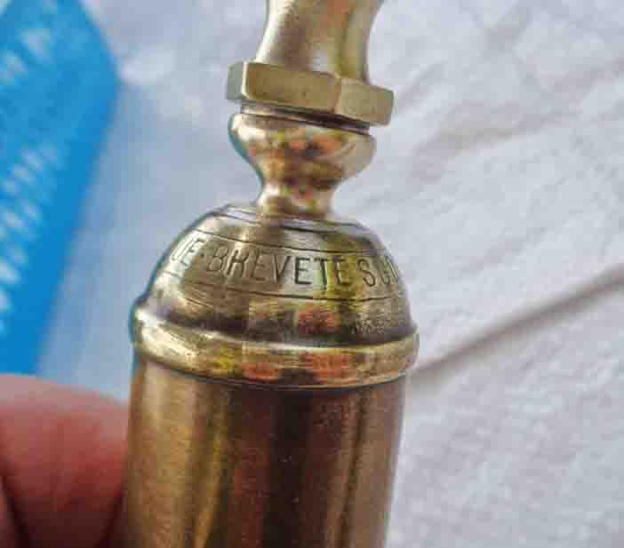

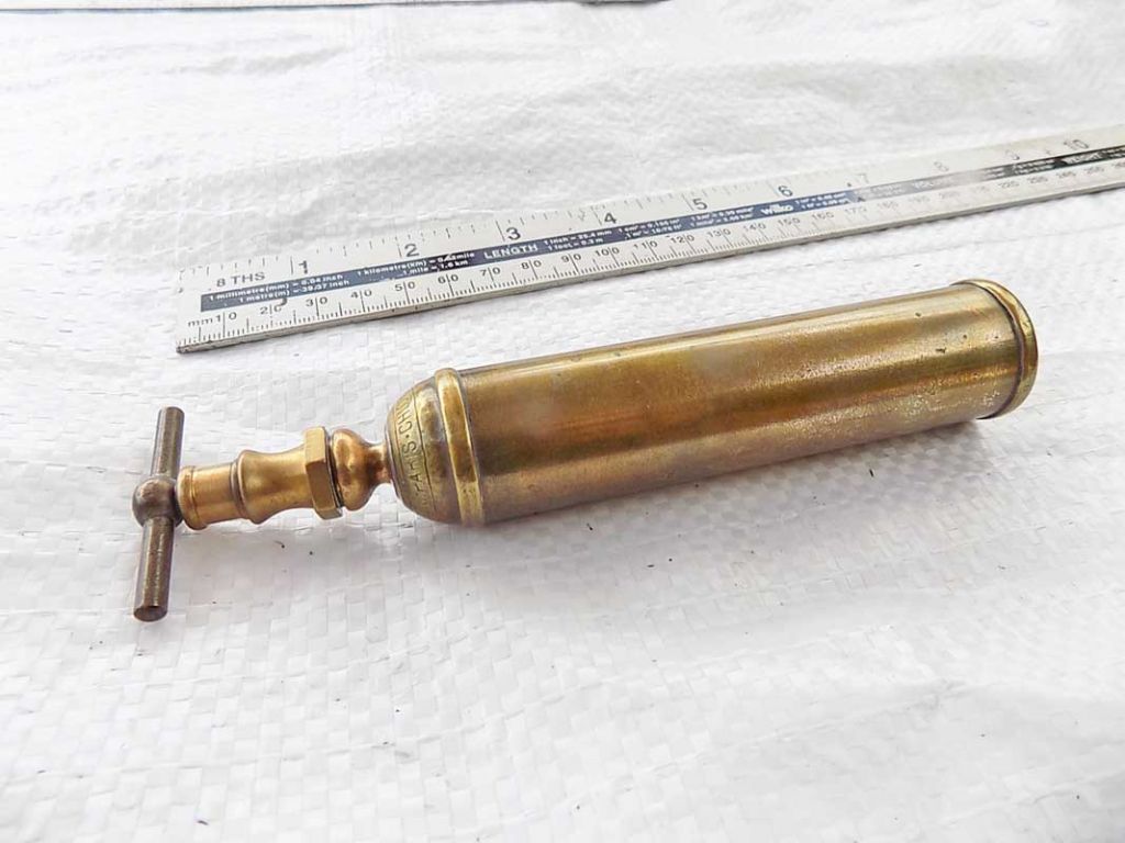

      Hi all, Have had this for some time but had no luck finding out what it is for.
      it came from a French vide grenier last year and is very well made as can be seen. I thought it was for some sort anethstetic use as it has "CHLORETYLE BENGUE' alng with the usual Brevette SGDG marks.
      However there is no venting hole or vavle to the top, it just comes straight off so all contents would be gone in a flash?
      Any thoughts are most welcome.
      Cheers, Martin

          Ethyl chloride was and still is, used as a local anaesthetic e.g for piercing ear lobes and other bodily parts I prefer not to think about.
          Quite possibly that's not the original top/valve (brass different colour?).
          You can see a few 'antique' cylinders in Google Images>
          **LINK**

              Michael. many thanks indeed, lots of info there including an exactly similar photo. Seems there were several different sorts of this device, i liked the one with different ends/nozzles.
              Cheers, Martin

                Fowlers Fury: many thanks for the link, top does appear to be original as per one of Micheal's links.
                Cheers, Martin

                  Michael, FWIW this came in the bottom of a box of grubby scrap spanners! Wrapped in an old copy of a French newspaper!

                      As it boils at about 12.5C, perhaps it was partially filled with liquid which was allowed to evaporate and provide a mixture for general anaesthesia. A bit rough and ready by today's standards.

                        Hi Brian, It is a portable way of allowing local anaethstetic to be administered, i guess by dropping it on a mask over the patients nose & mouth. I do not think it could last very long as it evaporates so fast?

                          This would just be a storage tank.
                          I've only ever seen ethylene chloride used for it's evaporative cooling effect.. in dentistry on a pledgelet of cotton wool applied to teeth when unsure which is the sensitive one or sprayed topically prior to minor surgery.
                          This link to the anaesthesia journal describes it's general anaesthesia uses **LINK**
                          I'm guessing it would have been dripped onto a simple face mask. Indeed in my youth it was common for vets to anaesthatise cats for minor procedures using a pledglet of ether soaked cotton wool dropped into the bottom of either a golden syrup or fowlers treacle tin which had multiple piercings in it's base. The patient would inhale through that base and cotton wool and vapourise the ether. There is an art form in controlling mutiple feline weaponry with one hand while hanging on to the scruff and holding tin over face with the other.
                          After the procedure (typically a quick castration) the cat would be put back in it's basket and handed to the owner with instructions to drive home with the windows open a little – not enough for the cat to escape but enough to vent the cat's expirations lest the driver pass out.

                            "As it boils at about 12.5C, perhaps it was partially filled with liquid which was allowed to evaporate and provide a mixture for general anaesthesia."
                            It was in common use as a GA at the beginning of the 20thC but even then only administered as a spray onto a gauze mask. It is a potent anaesthetic but the induction is rapid and dose/response very steep so easy to administer a lethal dose. Like all volatile chlorinated liquids it was found to cause cardiac sensitivity. As a young apprentice pharmacist I remember local jewellers coming to replace their empty glass vials for LA ear-piercing.
