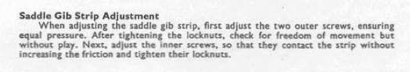

          Posted by blowlamp on 21/06/2015 10:51:34:
          It's not something I personally thought of, it's what Myford did from new at their factory.
          The procedure was to adjust the saddle centre gib screws first, working outwards, leaving the tailstock 'unsupported' end screw until last, which was then merely nipped to provide contact.
          Sorry, Martin; I still don't get it … What you describe is exactly the opposite to what's written in the ML7 book.

            Posted by Michael Gilligan on 21/06/2015 12:57:47

              Micheal,
              I agree with you entirely, knowing the Myfords as I do (over the last 50 +odd years), I have always ignored those words as illogical and have set the gib centre screw first and then left screw, in balance. The right hand screw to engage but not force so as to counteract any potential carriage rotation with increasing tool pressure.
              #194319
                Posted by KWIL on 21/06/2015 14:39:59:
                … I have always ignored those words as illogical and have set the gib centre screw first and then left screw, in balance. The right hand screw to engage but not force so as to counteract any potential carriage rotation with increasing tool pressure.

                  I think Myford's statement makes a lot of sense if everything is perfect, less messing about. Trouble is following use things probably wont be perfect. There seems to be some ancient law about how lathe slides should be set up – rather loosely. That results in faster wear and even bent gib strips, same problem as guides that can tilt, pressures are applied to small areas. I suspect the main reason this is done is to reduce lead screw wear and if high class work is needed the slides can be tightened up just for that purpose and then loosened off again. I'd guess that some lathes never get tightened or even set correctly in the first place. Not that the usual grub screw and lock nut is that easy to set anyway. Taper gibs are much much better in that respect.
                  I set my slides on the firm side and expect to have several goes at it before things settle down. I start by setting all screws moderately tightly to take out play and then backing off. If the cross slide tightens a bit when wound right out I accept that as I feel it's a better option than more play and higher wear rates elsewhere. Ideally I think slides should be set with any lead screws out pushing by hand. Some lead screws provide a lot of mechanical gain.
