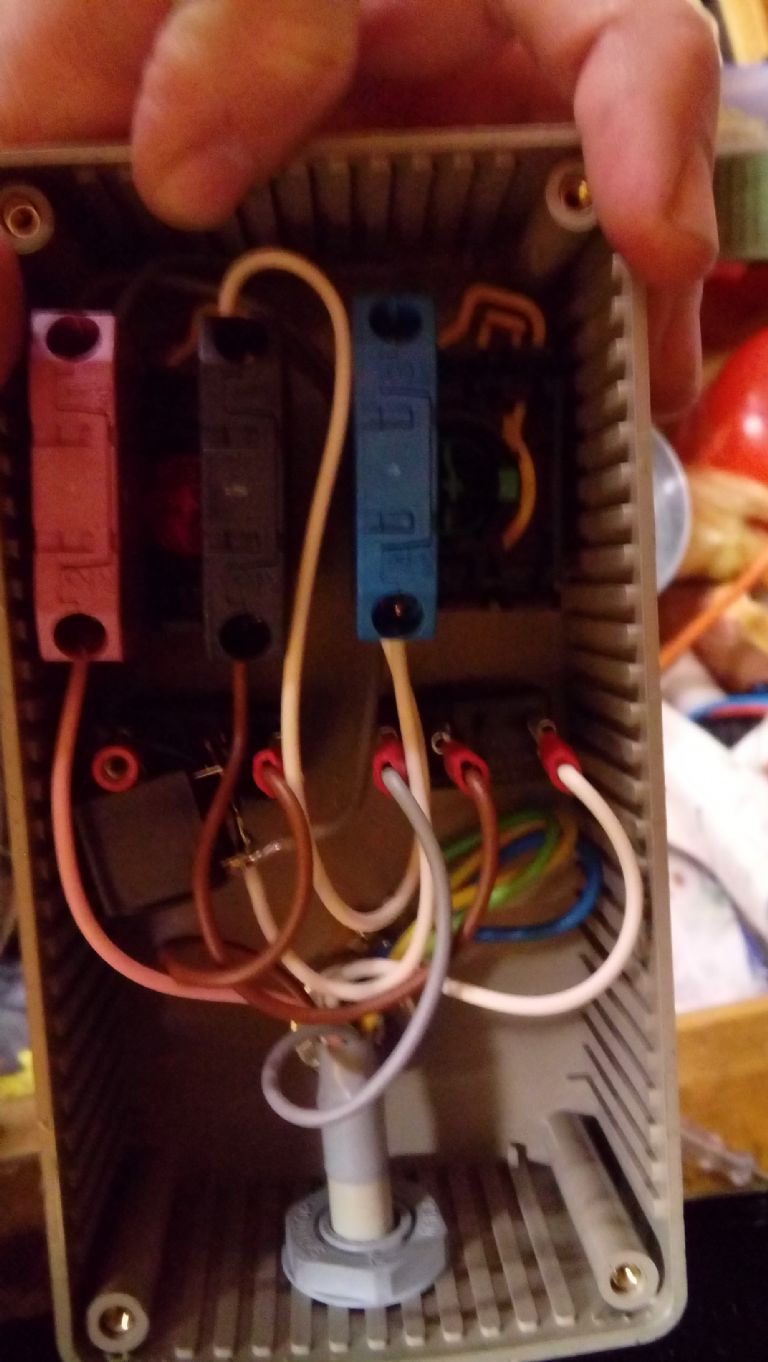

      I will show you all a picture shortly as I dismantled the pendant so I could show you, it has toggle switches for FWD/RVS and JOG/RUN, the start and stop switches are buttons and theres a vario for speed.
      The inverter can reduce it's coasting for start/stop to literally nothing so it just goes dead as soon as you hit stop, (although this can send a backwards current through the inverter due to the fact the machine will still be spinning after the power is dead) The manufacturer recommends that you use a mechanical break, as it does not have the capacity to do that electronically on this model.
      Michael W

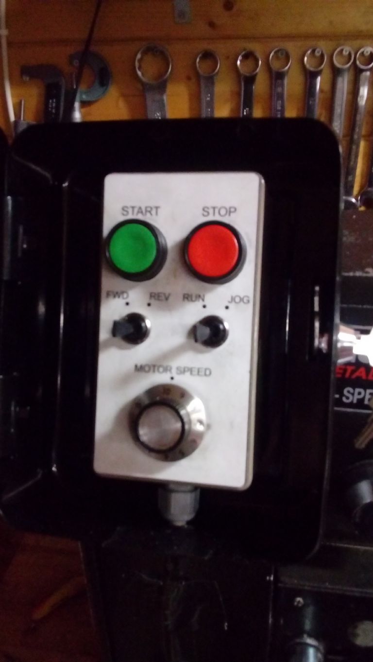

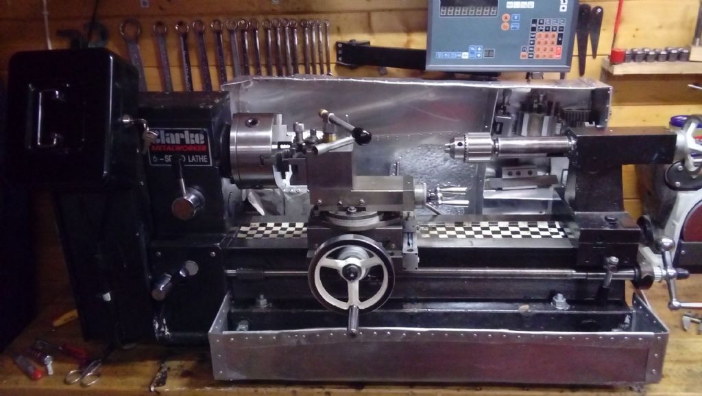

        Okay,
        This is the machine..
        This is the pendant front view..
        Here is the Inside of the pendant..

          #291560
          MW
            @mw27036
            So Blue, Yellow, Green (10V, AI, GND) All go to the potentiometer which is obscured by the main cable,
            White and Grey (S1, S2) are the toggle Switch for FWD/RVS. A third common cable connects this to the stop switch
            Pink (GND) connect to terminal on the STOP switch.
            This is where it gets messy. Brown (24+) goes to one side of the JOG/RUN, however the second terminal for the toggle has a relay, this connects to both start and stop, through white wires, one going to stop and two white ones going to both terminals for the START switch.
            Michael W

            Les Jones 1
              @lesjones1
              Hi Mitchael-w,
              I've not managed to trace out the schematic from your description and picture. I have not even worked out if it is switching the forward and reverse inputs to ground or +24 volts. (Most VFDs allow you to select this option from jumpers or a configuration setting from the buttons on the VFD) Can you measure the voltage between GND and S1 both with the motor stopped and running in the forward direction. This will let us decide if the emergency stop should be put in the +24v or the GND wire to the pendant. This is assuming you want to trust the VFD to stop the motor rather than John's method of removing the power to the VFD. I would think in a factory that his method would be the preferred way.
              Les.
              #291644
              MW
                @mw27036
                Posted by Les Jones 1 on 01/04/2017 12:20:04:
                Hi Mitchael-w,
                Les.
                Thanks les, you have pointed me on the right track at least, i'm sure I could try making a diagram of it but maybe I already know now which two connections(brown/white) concern the running of the motor, and logically placing a normally closed switch between it would provide a means of interrupting it. I'm going to stake a bet on that a switch between +24V and the fwd/rvs switch would do exactly that, it isn't a large burden to repair the connection should it prove unsuccessful and the GND could be tried.
                The relay has complicated the situation by scrambling the connections between the START, STOP and jog/run toggle switch, I believe this is because when you switch from running to jog mode the pendant is designed to change how the stop function works. In fact the only thing with straightforward connections is the rheostat!
                I'm definitely in agreement that the most straight forward option would be between the live wire of the input and the inverter, which would mean the inverter would switch off. However, we would probably need more than a garden variety emergency stop(like a heavy duty, metal clad switch) to handle a large current passing through it and the housing/switch construction would also need to be ground.
                Michael W
                Edited By Michael-w on 01/04/2017 14:11:29
