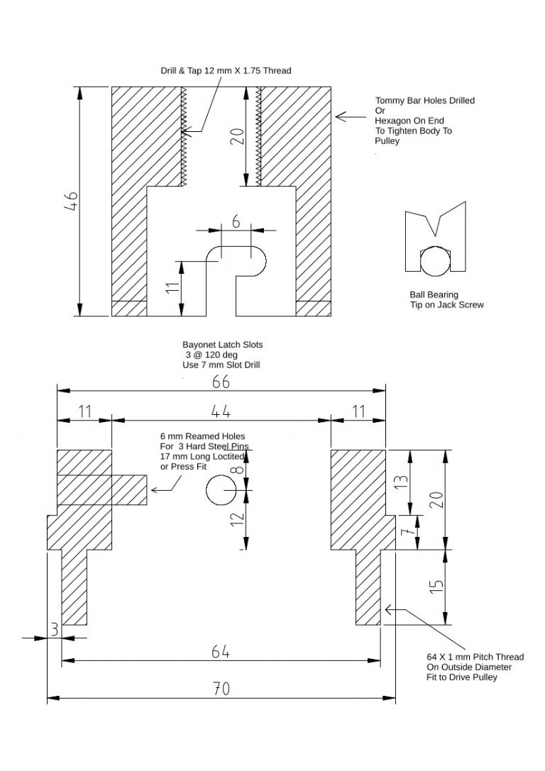

                            #448720
                            David Caunt
                              @davidcaunt67674
                              Hope this modified stolen pic shows how I got round the problem.

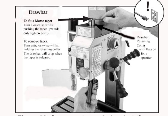

                              #448792
                              Anthony Knights
                                @anthonyknights16741
                                You could always make something similar to this **LINK**

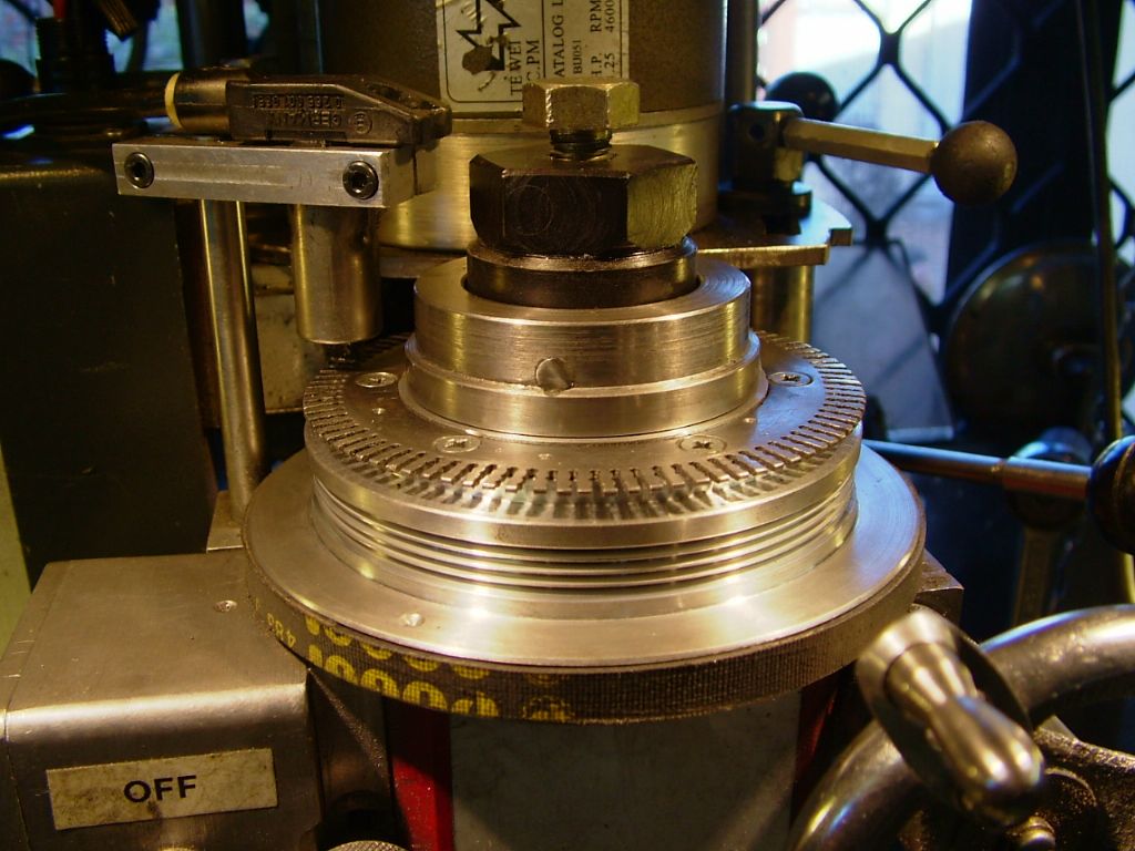

                                  #448829
                                  Howard Lewis
                                    @howardlewis46836
                                    For my elderly Mill/DRill, I removed the Left hand Threadede nut that holds the pulley to spindle. Turned back 1/8"
                                    Took a piece of 1/8" steel, plate and bored a hole in nthe centre, to just fit over the nut.
                                    Tapped two holes about the centreline. (1/4 BSF in my case )
                                    Replaced the nut with the plate under it.
                                    Took a similar piece of plate, drilled two 1/4 clearance holes on the same centres as the tapped holes.
                                    Drilled and tapped a 1/4 BSF hole in the cemtre.
                                    Fitted a long 1/4 BSF setscrew to the tapped hole, and two 1/4 BSF setscrews, of a suitable length, through the clearance holes..
                                    When the time comes to remove 3MT tooling from the quill, slacken the Drawbar about a turn.
                                    Screw the two 1/4 BSF setscrews into the plate, and tighten the central 1/4 BSF setscrew onto the top of the drawbar, and tighten. This should push the drawbar, and the tooling from the taper.
                                    If, with the central screw really tight, the taper does not "break", a tap with a light hammer will do the trick.
                                    This should subject the bearings to no or little force when removing tooling.
                                    Howard

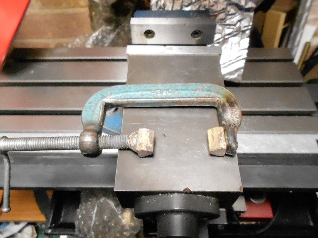

                                      #448876
                                      oldvelo
                                        @oldvelo
                                        4-pull.jpgHi
                                        There are More
                                        photos in my albums of a "Morse Taper Removal"drawbar-release.jpg for an X2 mill that may be of some use.
                                        Eric
