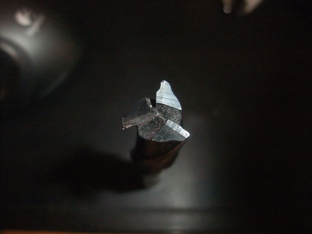

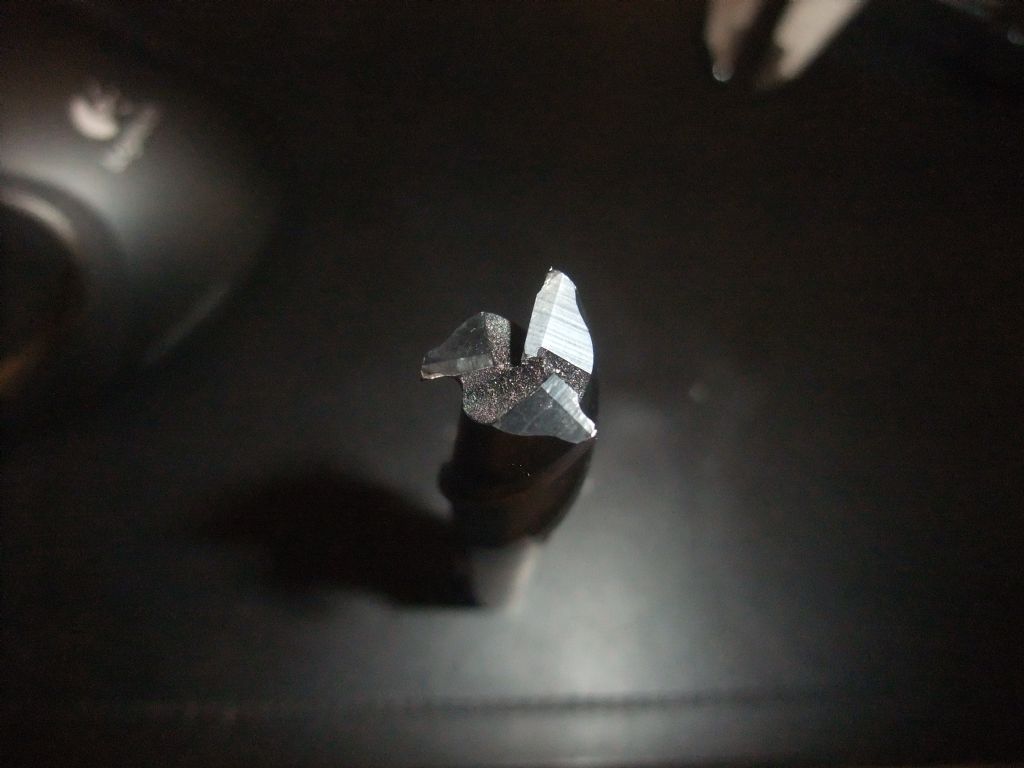

                              #287043
                              petro1head
                                @petro1head
                                I removed the tool and took a couple of photos. oh dear its fooooked
                                So so far I have learned that I need to lock the quill etc. I must only take a max of one flute width off. I need to feed into the direction of the rotating tool. This however leads me to a question, on the job I was doing the bottom was correct, feeding into direction of rotation but how would you do the top?
                                I needed to machine down a total of 12mm, should I be taking heaver cuts, ie 2mm each time (Jason?)
                                I am going to need a new 14mm cutter, should I buy another HSS from ARC or a carbide cutter?
                                Edited By petro1head on 04/03/2017 09:47:07
                                #287044
                                RICHARD GREEN 2
                                  @richardgreen2
                                  In the first picture on this thread, the cutter is not square to the work, perhaps a swivelling head is rotating due to the feed forces,
                                  #287047
                                  petro1head
                                    @petro1head
                                    Posted by RICHARD GREEN 2 on 04/03/2017 09:48:57:
                                    I think its just a bad photo. Everthing was setup before use, but will check just in case, thanks
                                    Edit: Just check and its ok
                                    Edited By petro1head on 04/03/2017 10:16:42
                                    #287048
                                    John Rudd
                                      @johnrudd16576
                                      Here is my advice fwiw, others will no doubt tell you different.
                                      I would in no particular order,
                                      Buy a roughing mill cutter from Arc ( they are the dogs at removing metal fast)
                                      Insert cutter into chuck and tighten.
                                      Align new work piece.
                                      Set the cutter for the first cut, lock Y axis and Z axis, use a reasonable cutting speed, and a decent feed rate. Listen to the machine, it will tell you if the feed is too fast or the speed is too fast ( or the opposite… ) ok this is subjective because you are inexperienced, but its a learning curve….
                                      You may need to take several cuts to get near to size.
                                      Once you are close to the finished size ( 10 thou….) use a normal 4 flute cutter to clean up to finished size….
                                      Turn the part around and start the 2nd face/side whatever…..
                                      In one of HH's books, there is an excercise on producing tee nuts, you'd do well to heed his instruction ( milling a complete course?)
                                      #287050
                                      Anonymous
                                        Posted by petro1head on 04/03/2017 09:46:11:
                                        …………. I must only take a max of one flute width off. ………..
                                        That's wrong; you can take whatever width is required, although 50% is about the worst value to use. Width of cut should generally be less than 40% or more than 60% to minimise shock loading of the teeth. For shallow facing cuts I normally use around 75-80% WOC.
                                        However, if you need to take off a depth of 12mm I'd be inclined to take pretty much full depth each pass and use smaller widths of cut. You're paying for the full length of the cutting flutes so you might as well use them rather than always use the bottom millimetre or two.
                                        There are several rules associated with cutting tools:
                                        1. Don't buy cheap cutters, they are often badly ground, will never give a good finish, and don't last
                                        2. See rule 1
                                        3. Cutters are consumable items -don't tiptoe about trying to make them last for ever, you'll just wear them out quicker
                                        4. As mentioned above feedrate is single most important parameter – most people run too slowly with the result that the cutter rubs rather than cuts
                                        For your case of a 14mm cutter I'd be running at 800rpm and 200-250mm/min feedrate.
                                        Give it some welly! The same rule applies to chatter. Many people instinctively slow down, often the solution is to increase feedrate and make the cutter work. You're inevitably going to break cutters at some point, it's part of the real world learning process. Get it over with quickly and learn from it.
                                        Andrew

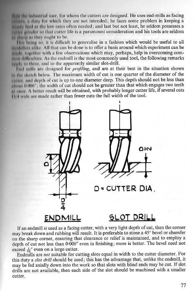

                                          #287054
                                          mechman48
                                            @mechman48
                                            Hi
                                            FYI …
                                            ​… from Model Engineers Handbook… Tubal Cain, 2nd edition
                                            George.
                                            #287057
                                            petro1head
                                              @petro1head
                                              Thanks, rotated so other may read it
                                              #287058
                                              Muzzer
                                                @muzzer
                                                Strange advice from TC. Clearly practice has changed, as tooling and machine technology has evolved. Plenty of examples of end mills taking much deeper cuts out there, including slotting at 100% width.
                                                For what it's worth, Mercans don't recognise the concept of the "slot drill" – everything on the other side of the Atlantic is an end mill although of course they have centre-cutting versions and the same choice of numbers of flutes.
                                                Part of the learning process is exploring the limits of your machines. I suspect that machine could remove a lot more metal if the width and depth of cut were increased. At some point the motor will stall or the possibly the tool will break but before then it's likely that a glorious rate of removal will be seen. One clue might be the rating of the motor – how could you get anywhere near the rated power without taking enough of a cut?
                                                My Bridgeport clone has a fairly modest 1.5hp motor but I have made full width slotting cuts with 12mm 3-flute HSS cutter at a depth of 15mm or so, using power feed for a consistent load. That was pretty much the limit and I used coolant otherwise I suspect the tool might have overheated before the full length of the lot was completed (about 300mm, roughing out a tee-slot). You may be surprised what your machine can achieve.
                                                As pointed out, you should try to use as much of the flute edge as possible, otherwise most of your cutters will wear out near the corners and you will be paying for something you aren't using. And failing to take a heavy enough cut will increase wear due to rubbing, particularly if you use conventional milling. Climb milling isn't a problem if you tighten up the gibs just enough to overcome the self-feeding.
                                                Murray
