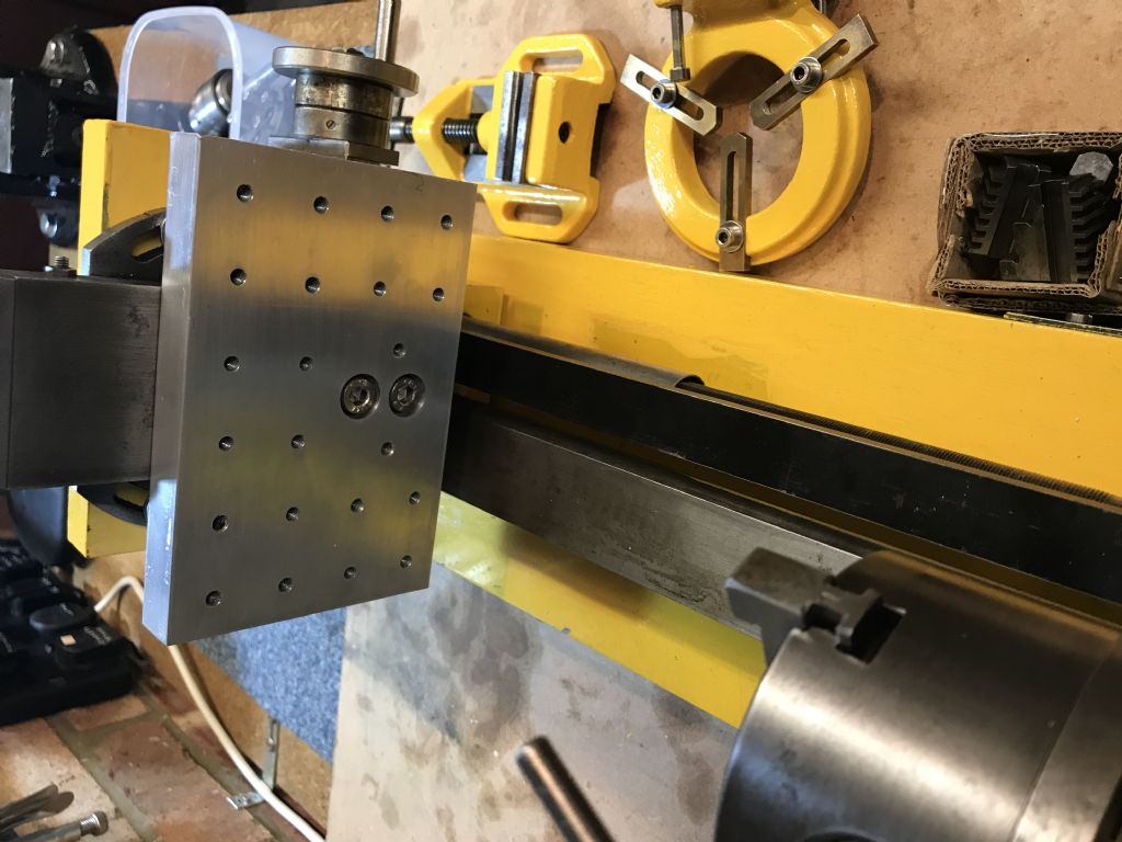

      mill plate.jpgHello, looking for some advice on a clamp kit for a small mill plate I have knocked up & tapped M6, for a Hobbymat. The plate is only 150mm x 100mm
      I would appreciate advice on where to enquire for a reasonable cost, I have searched ebay but picking seem to be slim, I might be using the wrong terminology?..
      Thanks

          This doesn’t seem unreasonable: **LINK**

          Ian Johnson 1
            @ianjohnson1
            Have a look at this set from Warco. The studs are M6 and will screw directly into your table, but you can make studs out of any M6 bolt or M6 stud iron (all thread)
            **LINK**

              Thanks both very much! Way better than anything I could find on ebay.
              I went for the Warco set as its UK based and same price.
              Thanks again cheers Chris

                Chronos do a M6 set, the Unimat 3 clamps would also fit.

                  The Warco set is the same one I use on my milling machines, I've made lots of different height / length studs depending on what I want to hold.
                  Nice job on the plate by the way

                    Thanks Ian, the plate was cheap & easy enough for me to knock up, however the tooling is starting to add up, but I knew this smiley

                      Given the small size of the plate and (mostly) small workpieces you may find some home brew additions worth the effort. Although effective bar and step block clamps tend to need fair bit of real estate.
                      Way back the I had my BCA I made some simple L shape clamps from 8 gauge (4 mm these days) strips perhaps a little under 5/8" wide with a 1/4 clearance slot down the middle of the long side. Lengths of short and long sides were whatever seemed useful. I suspect I made them ad hoc fashion when I had nothing suitable to hand to whatever size I needed for todays job figuring that what suited one job might well do for something else so I'd eventually build up a set. As I recall it the long sides would have been in the region of 1 1/2 to 3 inches, but 2 inches sounds most likely to be a common one, and short sides between 1/8 and 5/8 inch, probably mostly 1/4, 3/8 or 1/2 inch.
                      I also made some thicker plain bars with a jacking screw at one end. Probably 1/4 inch thick and again between 1/2 and 5/8 inch wide. Similar 1/4 inch clearance slot and similar lengths. Probably 1/4 BSF or 2 BA jacking screw with a permanent, free ly rotating foot on the end. I imagine I put a small groove a suitable distance from the end of the screw, made the foot a similar shape to that on a G-clamp and peened it over to keep it in place. Long time ago tho'.
                      Where possible bolt through is more effective than clamping although rarely enough on its own as, generally, only one bolt is possible.

                        The size scope for milling is small indeed, I need a starting idea of what size material can be reasonably clamped and the initial clamp kit will provide perspective I hope. I'm under no illusion that bespoke clamps and aids will be needed for specific projects but at least I will have a clamp start to practice with.
                        I have some material sizes that you mention for ad-hoc jigs/ brackets, which could accumulate to a bucket full of useful stuff I hope over time.

                            One reason I suggested teh Unimat type is similar to what Clive says as they use a captive jacking screw rather than stepped packing blocks so a lot easier to work with on a vertical surface and easy enough to make from flat bar, in your case just use studs inplace of the tee bolts.
