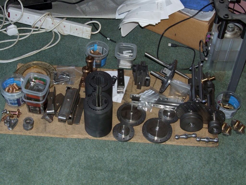

                  Posted by SillyOldDuffer on 30/03/2021 10:33:23:
                  …….I'd get the plans of a suitable candidate and study them carefully, asking of each part, what do I need to make that?
                  That's what I did – bought the plans and then decided what machines to buy. The swing of the lathe was set by the flywheel and the distance between centres by the front/rear axles. To some extent it depends upon how much the OP wants to do himself. Making spur, bevel and worm gears for instance will dictate sizes and capability. I had to drill/bore the hornplates for my engines in several steps as the Bridgeport wasn't big enough, particularly in Y. I didn't turn my wheels but made them by the fudgeit and bodgeit method and hoping for the best. Most spoke/strake holes were freehand drilled, but I had to get creative for the first row of strake holes, even with a 12" rotary table:
                  The biggest issue will be Z, followed by Y and then X. I've run out of Z several times and have needed to buy stub drills/mills or collets. I've also run out of Y a few times, but X only when machining the rear rims before rolling:
                  I also ran out of Z on the horizontal when cutting the final drive gears:
                  i suspect size of mill will be dictated by a 2" scale traction engine – in general parts for a 5" gauge loco will be smaller. I'd also echo SoDs note about clamping. It can take up a surprising amount of space/travel, not just on the mill but also on the rotary table.
                  Andrew
