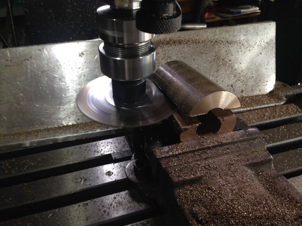

      Hi Everyone,
      I have two questions regarding the milling machine about which I would like some advice:
      A I want to mill grooves or keyways along a piece of 40mm round. The workpiece is mounted in a 3 jaw chuck fitted to a rotary table,mounted vertically ,so the work is horizontal,the overhang supported by a tailstock. The cutter is 5mm two flute and the machine is a Chester Lux.
      What I want to know is,how deep a cut can I take at each pass,using powerfeed.?
      B i am also experimenting with slotting saws,which I find do not always run true [I think someone mentioned this before ]. I find that they tend to cut on some of the teeth but not on all of them. I have clocked the spindle and the saw holder and both are running true,so I presume the error is in the saw
      Nothing I can do about that,but how deep a cut should I aim for,using a 3" dia x3/16" thick saw? I have tried a speed of 100 rph,just to see how it went. Should I increase or decrease ? I forgot to mention that the material in each case is mild steel,nothing fancy. I have not yet tried using powerfeed for the saw,just feeding by hand.
      Any advice ,of which there is loads out there,much appreciated.

          For the 5mm cutter I'd be running a DOC of 1.5 to 2mm.
          Whatever you do, on any machine, slitting saws never run true. And in my experience on anything other than a horizontal they have a tendency to go walkies and not cut straight.
          A cutter speed of 100rpm is on the top limit for a HSS steel cutter and low carbon steel. I'd back off a bit, say 80rpm. Depth of cut depends on whether the cutter is fine tooth or coarse tooth. In this picture they're coarse tooth except bottom right and possibly bottom middle:
          If the cutter is fine tooth only a shallow DOC will do, say around 1mm. For coarse tooth DOC depends on how much power is available; I wouldn't be worried about DOCs in the 10-15mm range.

                                  I have had good success with a slitting saw. This one has had a lot of use, mainly cutting bronze and brass but also has been used to cut steel. Slow speed, light cuts and lubrication to overcome friction and heating.
                                  Paul.
