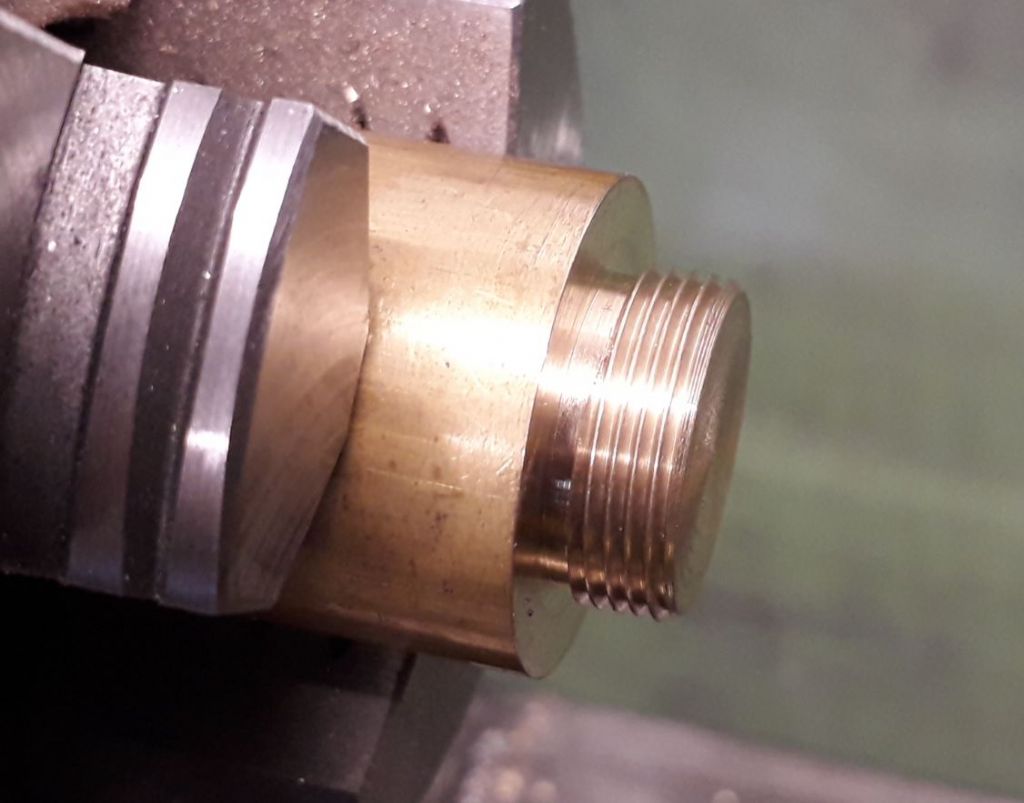

            The metric constant pitches such as 0.5, 0.75 and 1.0mm are much the same as ME 40tpi, 32tpi and 26tpi brass where the pitch is constant over a range of diameters.
            Just so happened to be wanting a M18x1 thread this weekend so brought it forward to today. Started with 18mm dia, went into the tapped hole snugly with 0.051" off dia so took another 0.001" for comfort so that is 0.052 cut or 1.3208mm which equates to 0.6606P that was with a partial form insert
            Edited By JasonB on 25/01/2019 16:36:51

                  #393024
                    Posted by Howard Lewis on 25/01/2019 18:05:23:
                    And for screwcutting, a 12 x 1mm thread, use, again as a rule of thumb, having turned the OD to say 11.95mm, depth of cut will be 1mm (NOMINAL). Allowing for the 0.05 truncation, the depth of cut will actually be 0.975 mm (0.05/2) from contact with the O D.
                    Are you sure about that or is your thumb a very loose fit in the nut.
                    Even if the threads went to a complete point you would only need to feed in by the height of the triangle which is 0.866mm for a 1mm pitch.
                    Edited By JasonB on 25/01/2019 19:56:45

                      #393035
                        A drill takes 1mm total off the diameter when tapping. a 1mm DOC will take 2mm total off diameter
                        Going further Zeuz gives tapping sizes for approx 80% engagement so teh tapping drill for 1.0mm pitch is 1mm less than nominal in this case tapping will be 11mm dia, giving 0.5mm of thread all round and if that 0.5mm is approx 80% then full engagement will be approx 0.6 ( 1.2 x 0.5) if you look at the above posts it is being suggested that DOC is just over 0.6mm and my own figures from todays thread are just a whisker over that at 0.66mm which is a long way from 1mm.
                        Edited By JasonB on 25/01/2019 20:39:18
