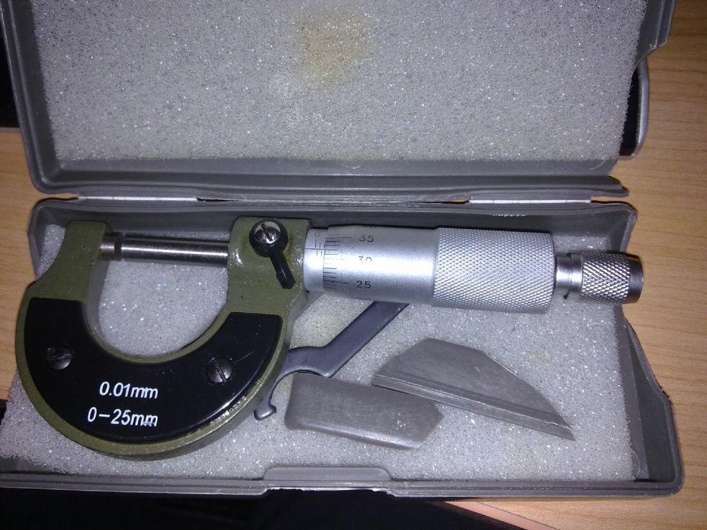

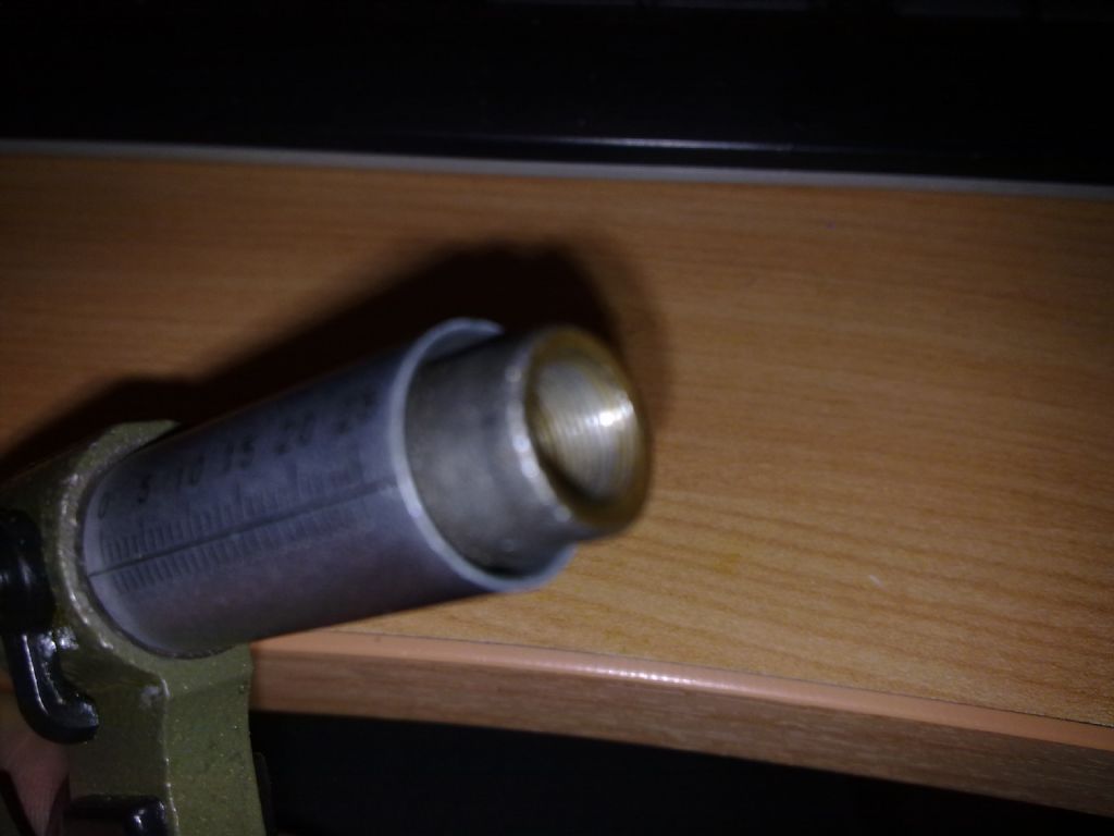

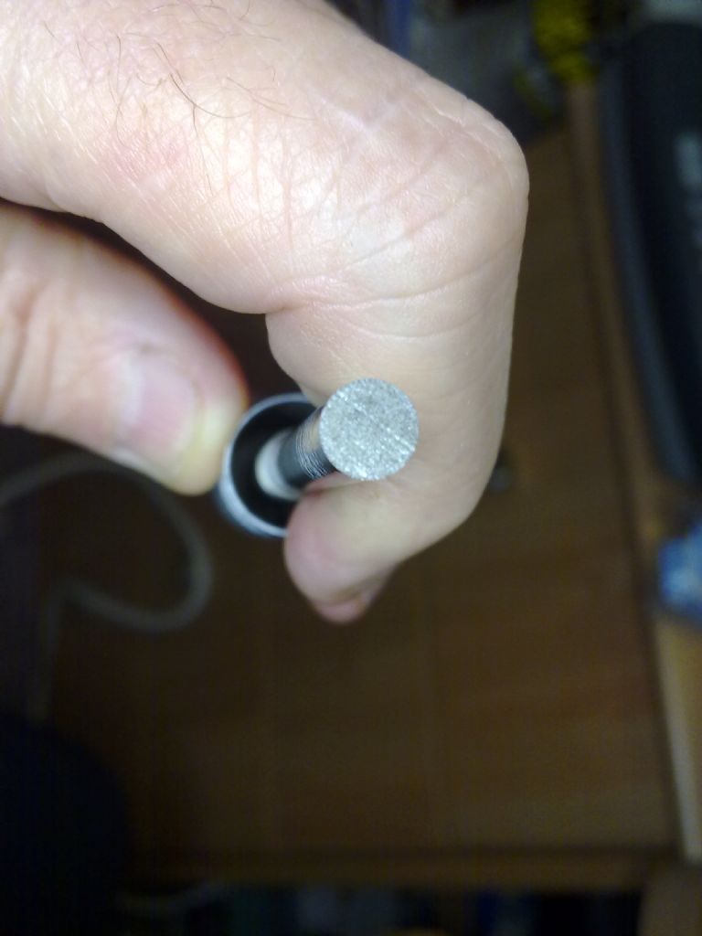

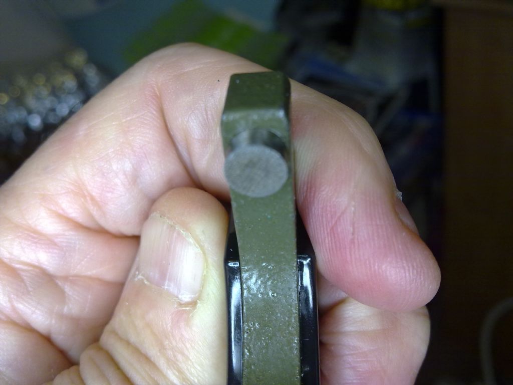

                          The Chinese 0-25mm micrometer I bought from Ebay turned up on Thursday.
                          As you can see, the box didn't survive the journey in the standard grey plastic bag. The micrometer was inside a sealed plastic bag as supplied. There are no makers markings & no paperwork was included. From a distance, it doesn't look too bad – the markings are clear against satin chromed backgrounds, clean knurling & the ratchet is all metal.
                          Thre seemed to be some kind of preservative on the bright parts, so first off I removed the spindle & cleaned it with IPA. Removing the spindle revealed that the female thread is cut directly into the body & has no wear adjustment
                          Sorry for the OOF picture – phone pics ! – but you can get the jist I'm sure. Further examination showed absolutely no attempt to finish the spindle end face or the fixed anvil face. There are burrs from the O/D grinding on the faces of the both the spindle and anvil. Neither face appears to be carbide as claimed and visible in the close-up pictures on the listing.
                          Replacing the spindle in the body revealed that the spindle is a loose fit in the front of the frame & the only bearing provision is via the thread – the spindle can be moved (wobbled) about +/- 0.25mm when extended close to (but not touching) the fixed anvil. It is not possible to get a reapeatable zero due to the rough, unfinished faces of the spindle and anvil & when brought together, the spindle and anvil are not aligned.
                          I don't propose to waste any time doing any accuracy checks on this thing – from a distance it looks like a micrometer, but it really isn't fit to use if you want any kind of accuracy.
                          A bit of searching for "Chinese outside micrometer" suggest that this is a product of the Conic Industrial Co. Ltd of Fuzhou, who appear to do many types of micrometer. The pictures form the Ebay listing suggest that the item supplied is this one
                          but what seems to have been supplied is a lower specification
                          model.
                          I have requested a refund form Ebay of the basis that the item supplied is not as described in the listing.
                          Nigel B

                            Good decision, Nigel
                            Incidentally; I don’t think the manufacturer does anything to lend credibility by publishing drivel like this in the description: [per your second link]

                              Oh dear, sorry to hear that you have a pile of junk mgnbuk, that really is in the G clamp category.

                                    I wish you would make an old man happy and do the accuracy checks! Whilst visual inspection strongly suggests this £6.29 treasure can't be as accurate or precise as a better made micrometer, just how badly does it perform? How far off, and how repeatable are its measurements of standard sizes?
                                    My granny taught me to "Never judge a book by it's cover ", and she was right about everything. In engineering and science, opinion alone is untrustworthy, only evidence matters. Accurate experimental evidence best of all.
                                    Be interesting to compare several examples of very cheap, and the £30-ish type, and the £200+ micrometers. In particular, are mid-range cost micrometers 'good enough' for hobby purposes. Mine is, but I work mostly at the rough end.
                                        Oh alright then Dave.
                                        Given the state of the contact points on the Chinese "micrometer", I really don't want inflict these on the calibrated slip set at work. But I have an assortment of "out of spec" Imperial slips (failed calibration by a few millionths of an inch), a small ground parallel set & some ground HSS tool blanks to run comparison checks against, if not absolute checks. I have second hand KS 0-25 and NSK digital 0-25 micrometers to compare against the misrepresented Ebay purchase, which I have yet to parcel up and return (to a UK address with an Ebay supplied pre-payed returns slip). All have been retrieved from the garage & are coming up to room temperature at the moment.
                                        I'm not writing off all Chinese measuring equipment on the basis of this one sample. As with many other Chinese products, they seem quite happy to make items to suit the buyer's cost expectations as well as quality requirements – theChinese supplier website I linked to has a great many examples from several manufacturers that appear noticably better than the item I bought, including the manufacturer of the "cheap" item. The difficult bit is determining what will turn up, as the same mic I bought is available from several suppliers on Ebay (for example) at widely differing prices. Buying a known, respected brand (new or used) should remove that particular uncertainty & even a well used named mic should be better than this particular new item longer term.

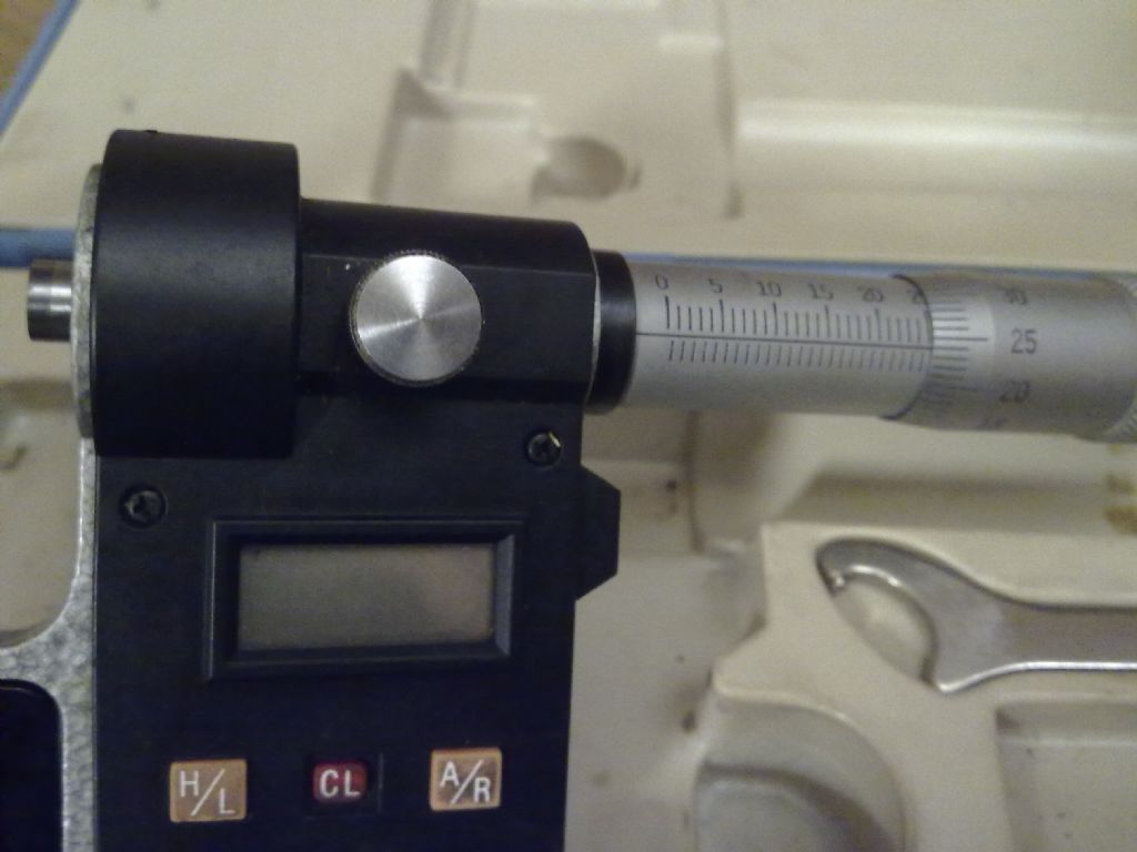

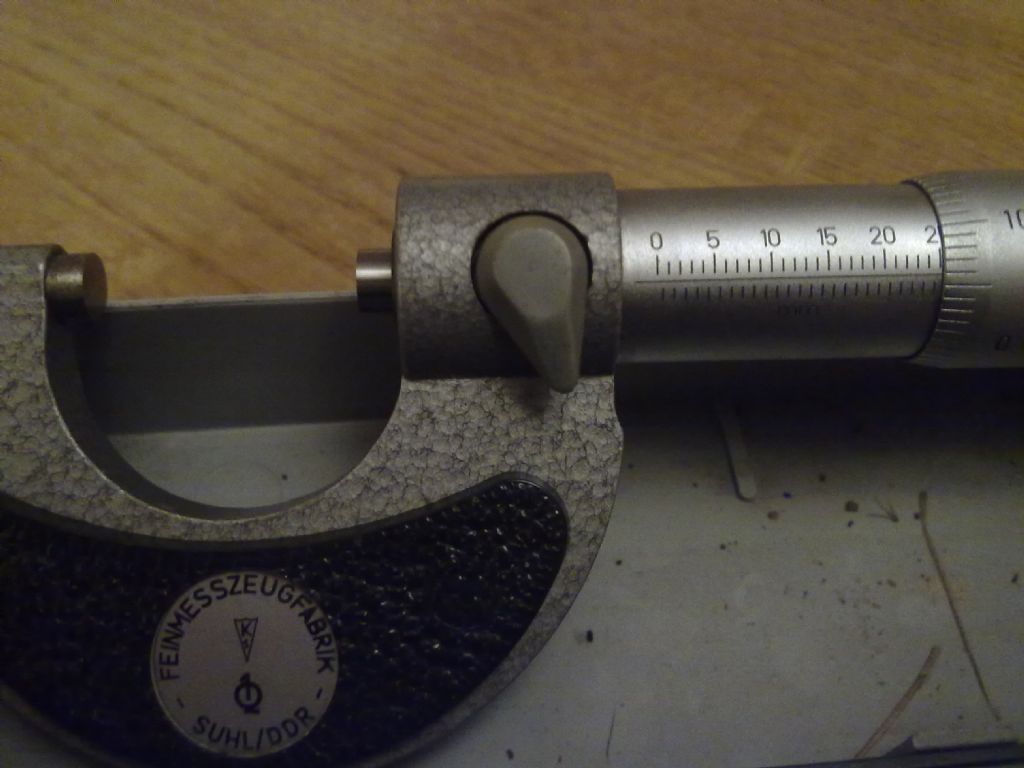

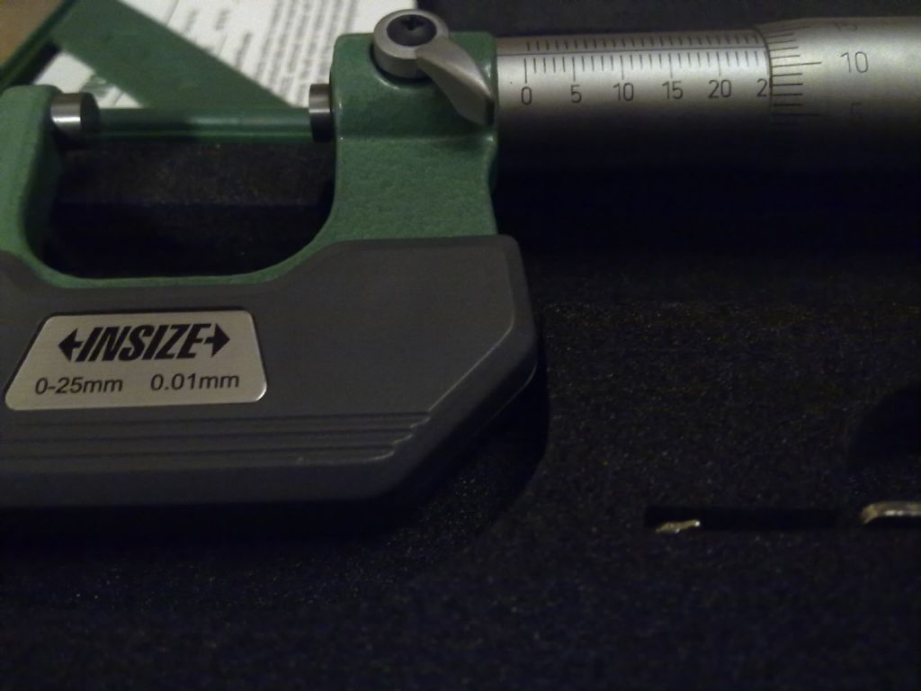

                                            Prepare to be bored ! As requested by Dave, I have run a few comparative test checks on the Ebay micrometer, 3 other metric micrometers I either own of have borrowed and, just because it was to hand, an Aldi 150mm digital caliper.
                                            The test artifacts were variously some inexpensive 4"x1/8" parallels of unknown parentage, some out of spec gauge blocks, a piece of ground HSS and a previously unused 25mm setting block from a KS 25-50 micrometer. All had been in the house since yesterday afternoon to come up to the same temperature.
                                            The 4 micrometers – top LHS my ex-industrial NSK Digitrix II. Unfortunately I found I had no new SR44 cells, so this was checked using the barrel markings only. Top right is my ex-industrial DDR KS, with a new, unissued Insize borrowed from work bottom left. The Ebay mic is bottom right.
                                            I checked a variety of sizes from 0.128" (smallest) to 25mm (largest) – now comes the boring bit !
                                            0.128" slip (3.2512 mm) Aldi caliper 3.25 KS 3.25 NSK 3.25 Insize 3.25 Ebay 3.28
                                            0.145" slip (3.683mm) Aldi caliper 3.68 KS 3.682 NSK 3.684 Insize 3.682 Ebay 3.715
                                            5/16 HSS (7.9375mm) Aldi caliper 7.95 KS 7.977 NSK 7.99 Insize 7.98 Ebay 7.97
                                            1/2 parallel (12.7mm) Aldi caliper 12.70 KS12.715 NSK 12.715 Insize 12.719 Ebay 12.74
                                            5/8 parallel (15.875mm) Aldi caliper 15.87 KS 15.855 NSK 15.86 Insize 15.868 Ebay 15.875
                                            3/4 parallel (19.05mm) Aldi caliper 19.05 KS 19.062 NSK 19.062 Insize 19.06 Ebay 19.085
                                            0.8" slip (20.31mm) Aldi caliper 20.31 KS 20.315 NSK 20.312 Insize 20.312 Ebay 20.345
                                            7/8 parallel (22.225mm) Aldi caliper 22.23 KS 22.255 NSK 22.25 Insize 22.255 Ebay 22.28
                                            0.9" slip (22.85mm) Aldi caliper 22.85 KS 22.86 NSK 22.858 Insize 22.859 Ebay 22.89
                                            25mm gauge Aldi caliper 25.00 KS 25.00 NSK 24.999 Ebay 25.035
                                            The 3rd decimal place numbers are "best guess" interpolations of the markings.
                                            As you can see, the results show that while the Ebay mic isn't great it isn't terrible either. But the results are only half the tale – the Ebay mic was not as easy to use for a couple of reasons – the lousy finish to the spindle and anvil faces and the very "easy" thimble action. The narrow parallels wer difficult to get a feel on, as the striations on the spindle face cuaght on the edges of the parallel. This was not as noticable on the gauge blocks. I should have checked something round as well, I suppose, but didn't think of that till after I had packed up.The thimble just felt loose compared to the others. The ratchet was fine, though.
                                            Other random comments :
                                            The Ebay and Insize both had etch graduations, the KS & NSK were engraved and filled and were noticably easier to read.
                                            The Insize scale was "upside down" compared to the others – the millimeter markings being below centre rather than above.
                                            The KS is by far the heaviest and is decidedly chunky compared to the others. Nice ratchet & easy to read.
                                            Only the NSK & Insize have serial numbers. The KS states it meets TGL10546 Grade 1 specifications (DDR norms) & the Insize documetation shows it is to DIN863-1 & comes with a test certificate. As the NSK & KS were bought used, I have no paperwork for them.
                                            The Insize has by far the best case. The Insize mic came from Cutwel and is not the most basic model in the range (they were out of stock of those when I ordered it). IIRC it was around £22 – £23+Vat (the basic one was £20). Insize don't say exactly where it was made just state Asia.
                                            Having checked several Aldi / Lidl calipers before, I wasn't too suprised that the sub-£10 caliper acquitted itself pretty well – probably nearer overall than the Ebay mic & quite adequate for general checks.
                                            Pics below of the markings of the KS, NSK & Insize mics :
                                            Hope that was of interest Dave !
                                            Nigel B

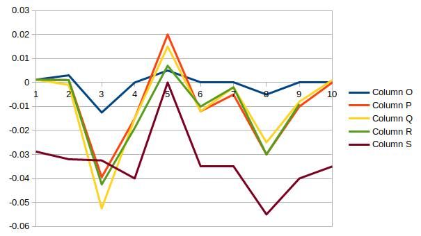

                                              Very much so Nigel, and thanks for the detail!
                                              Here's the results graphically.
                                              I deliberately didn't label which line represents which instrument. Makes ranking the instruments fairer when only the numbers are available. The figures suggest instrument 'O' is best, and instrument S is the worst.
                                              Note that PQ&R are all close to each other in following the same zig-zag pattern. I suggest the zig-zag emphasises the need for standard blocks to be properly calibrated themselves; the instruments are all detecting the parallels are not spot on. (Which is OK, parallels don't need to be accurate, only parallel. Just don't trust them as measurement standards!)
                                              That instrument O isn't following the zigzags with the others is suspicious. O looks good, but I think the instrument isn't detecting variations in the test objects as sensitively as the others.
                                              Measurement is hard to do!
                                              I wonder why people buy these very cheap micrometers? I own an inexpensive one because even though it's workshop class it outperforms my digital calipers when I need better accuracy. If I did a lot of accurate work, it would be worth me going for an up market micrometer, and if it really mattered I'd buy a set of gauge blocks to make sure it wasn't a liar! Don't see much point in owning a wonky micrometer that's only equivalent by a more convenient caliper.
                                              What I've noticed about expensive tools is that they don't automatically do better than cheap ones. Rather they feel better, get results faster, and need less skill to operate. Expensive kit isn't essential – it's amazing what can be done with unlikely tools, skill and patience. Gosh, before milling machines, cold-chisels and big hammers achieved marvels.
                                              Thanks to Nigel I shall sleep easy tonight!
                                              Cheers

                                                    I’m not too keen on the axes on Dave’s presentation of the results.
                                                    For a sensible graph, I would suggest that the true measurement of the part should be taken as zero error. That basically means that other than for the slips, the true dimension has not been used.
                                                    A quick glance at the results indicates a +0.02mm to +0.04mm bias for the micrometer tested. That could simply be a 0.03mm zero error, which is not exhibited in the results.
                                                    But that does not make it an acceptable item. I’ve seen outwardly identical items (perhaps only differentiated by a slight difference in the shade of plastic) which have very different innards – very much related to the purchase price, of course. Buyers beware – some suppliers do cheat!

                                                      The appalling surface finish on the anvils of the ebay micrometer would presumably produce different readings for a wire measured in various orientations [according to whether, or not, it was lying in a gouge].
