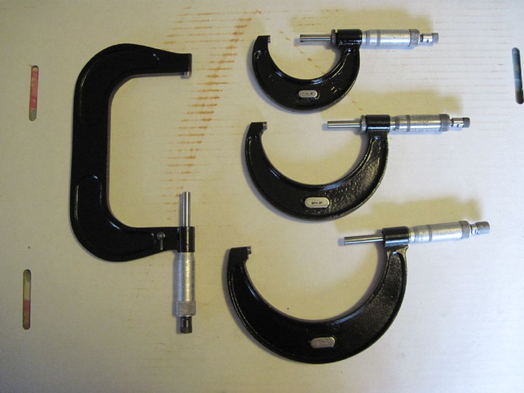

          #437506
          IanT
            @iant
            Posted by old mart on 14/11/2019 18:55:58:
            I have more than enough measuring instruments from when I was working, I actually sold three digital Mitutoyos for an average of £60 each as they were not being used. I did buy a 25-50mm micrometer for only £14 new not so long ago, it was NOS made in the DDR, which means it predates the unification of Germany. It is top quality with instructions, a length bar and a nice box. Worth looking on ebay in case there are any left.
            The only 'new' mic I've ever purchased was many years ago and is a large barrel 0-25mm one by an East German (DDR) company (it mentions Carl Zeiss on the back page of the booklet) and it is not only very well made but also very easy to read – each graduation being 0.01mm. It couldn't have been very expensive back then (as I didn't have much money) but it is excellent quality. I've looked after it and it's still in mint condition – mainly because unfortunately I don't tend to use it very much.
            All my other mics are Imperial in various sizes up to 6" and are most are made by M&W. They were all used (and in very tatty boxes) but have cleaned up very well. I've now calibrated them (using slip gauges) and they are occasionally very useful (e.g. useful to have but not essential). I also have a very old 1" Starrette mic which is basically my Workshop mic and (I'm afraid) just gets used and abused. I don't throw it around but it knows the inside of my pocket quite well – which is always handy…
            I can move between Imperial & Metric quite easily because I can still multiply & divide by 4 just about ( 1mm is about 40thou, 4 thou is about 0.1mm etc). My machines are all Imperial and I find 'thous' easy to work with (e.g. they are simple numbers between 1-999). I must admit, I'm not so fluent with fractions though…but a friend of mine was a wizz at adding a long list of them up but he'd done it all his working life.
            So – Old East German (DDR) mics are very nice to have, used (good quality) mics can be great value – and get whatever type (Imperial or Metric) that will make you happy. Works for me!
            Regards,
            IanT

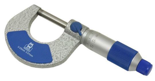

            #437524
            Journeyman
              @journeyman
              I picked up one of these Moore & Wright basic range (200 series) micrometers when at a show from Machine DRO.
              Current price is around £26.00 so quite affordable. All I can say is it works only odd thing to get used to is that the big blue collar on the barrel is the ratchet rather than the more usual small knob on the end. I must admit I find reading the metric mike more of a challenge than the imperial one. At least you don't have to keep putting batteries in it!

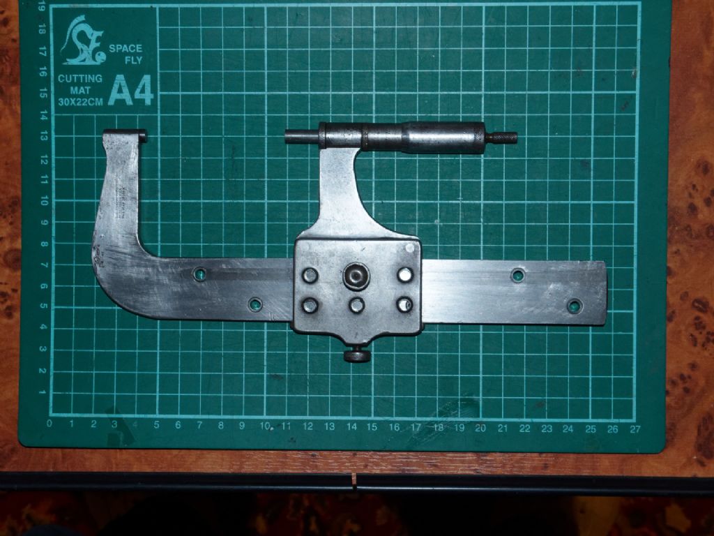

                          #437564
                          Enough!
                            @enough
                            Posted by roy entwistle on 16/11/2019 11:42:46:
                            I have 0 – 1", 0 – 2", 0 – 3", and 0 – 4 "
                            Not doubting you Roy (well, I guess I am a bit) but I've never seen those. A 4" long thimble must be a sight to see. Could you post pictures (or a link)?
                            #437590
                            peak4
                              @peak4
                              Posted by Bandersnatch on 16/11/2019 17:06:09:
                              There are varieties available which don't have a 4" thimble.
                              This Starrett works as a 0-1" through to a 5"-6", so almost fits the description.
                              0-6 Starrett Micrometer.
                              It's getting a bit tired now but is accurate at both ends, but the 2"-3" and 3"-4" misread by one and two thou respectively.
                              I don't know if it was originally supplied with a set of reference bars.
                              See also THIS LINK
