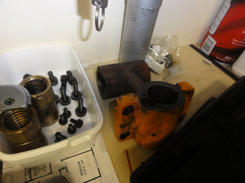

                Managed to dig out a photo of the yoke and the original split nuts (before I split them).
                BP clone yoke

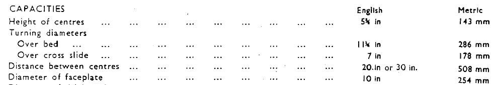

                My problem is that my ballnuts are about 1mm larger diameter than the bores in the yoke. Yes, the obvious question is whether I can simply mount them on the faceplate and bore them out with a boring bar. I really don't fancy making up a replacement yoke, the more I think about it.
                I'll need to be able to swing about 135mm radius for one of the bores and about 120mm for the other.
                Bantam capacity
                Looks just about possible, assuming that the saddle "ears" don't reduce the swing….
