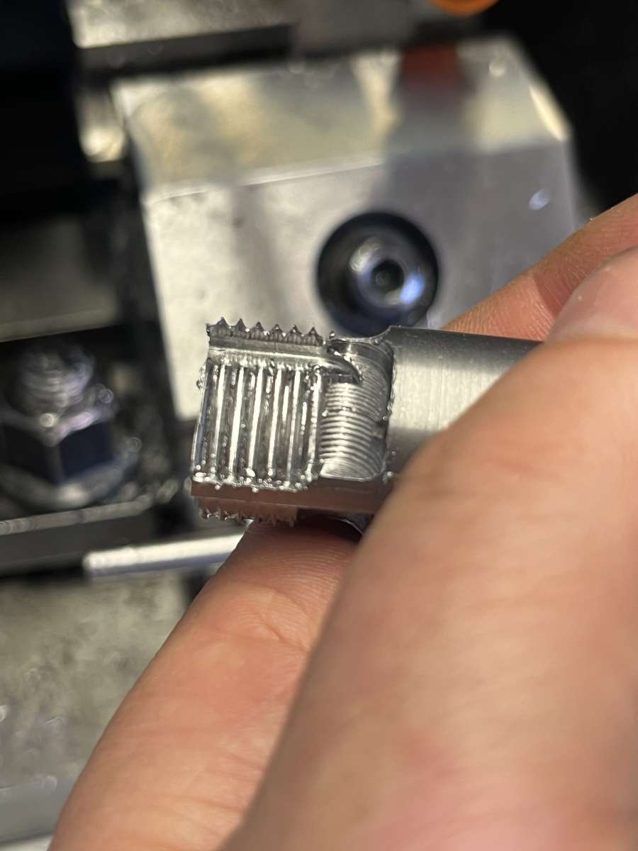

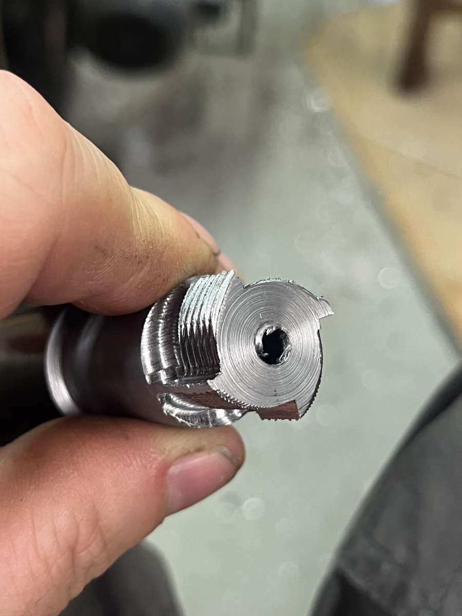

      I want to make some gears shortly, so I thought I’d try and make the cutter using my fancy new CNC 🙂
      This is a proof of concept, still got some bugs to work out, but thought I’d share incase it inspires anyone.

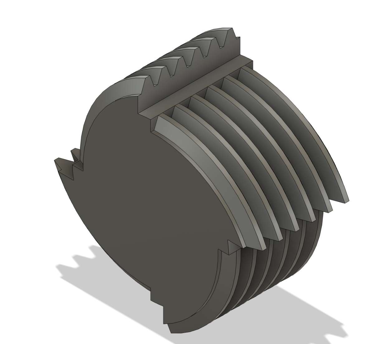

      Backstory – About 6 years ago I started a clock (no rush…). and for that I made a rack form gear cutter. There is a thread over on the Homeshop Machinist BBS (https://bbs.homeshopmachinist.net/forum/general/81473-making-a-gear)
      Some of the people over there where quite upset I didn’t have an relief on my cutter.
      So here is a 4 tooth, rack form, relieved cutter I knocked up in Fusion360:
      fusionmodel
      I didn’t model the shaft as the stock to make if from will just be that.
      IMG_7085IMG_7087
      Made it from some cold rolled I had lying around – horrible to machine, but for a proof of concept adequate.
      Ive only run 2 of the 4 index positions – hence the part formed teeth.
      Need to not snap the end off the V cutter for the finishing paths, but otherwise looks very plausible.
      Will do a few more tweaks then knock one out of silver steel, hardened it an give it a go.

        Did you use a 20° V-bit to cut the grooves and will the tool be used for gear hobbing?
        #802877
        Dave S
          @daves59043
          Yes.
          Roughed out with a 6mm endmill
          IMG_7082
          Then smoothed with a 3mm ball nose
          IMG_7083
          Which starts the top of the grooves. Then a 20 degree V bit for finishing. Thats the one which pinged off the end almost as soon as it started 🙁
          Might need to use a 1mm ball nose to remove more of the groove first, and certainly need to practice making v cutters.
          Not exactly hobbing, more Rotary Sunderland Gear Planing.(which is sort of 0 degree lead hobbing if you squint)

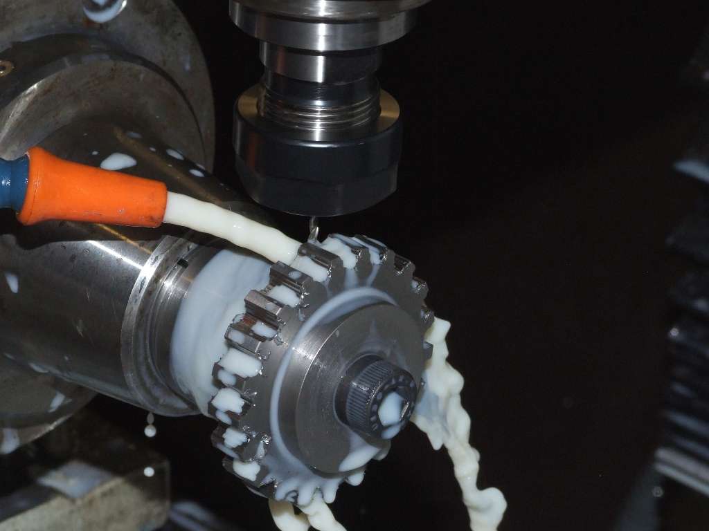

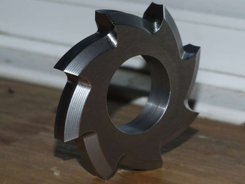

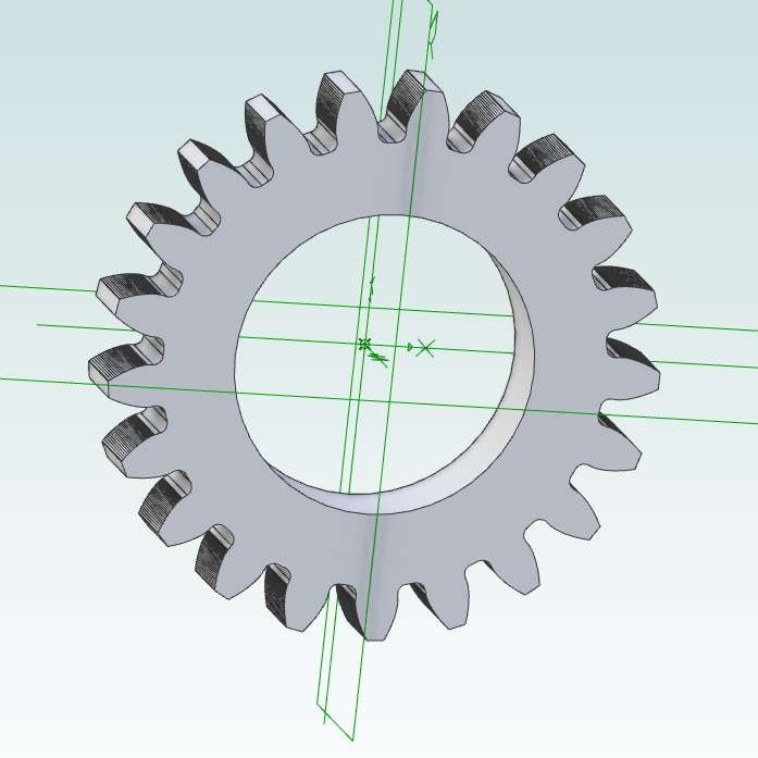

                Given that the OP has a CNC mill there are a couple of simpler alternatives. First, just make a form relieved cutter to cut a single tooth in one one as per commercial gear cutters. This cutter was made on a CNC mill, from gauge plate, for cutting a spline complete with form relief. Making one for a gear would be simple:
                2013_08260080

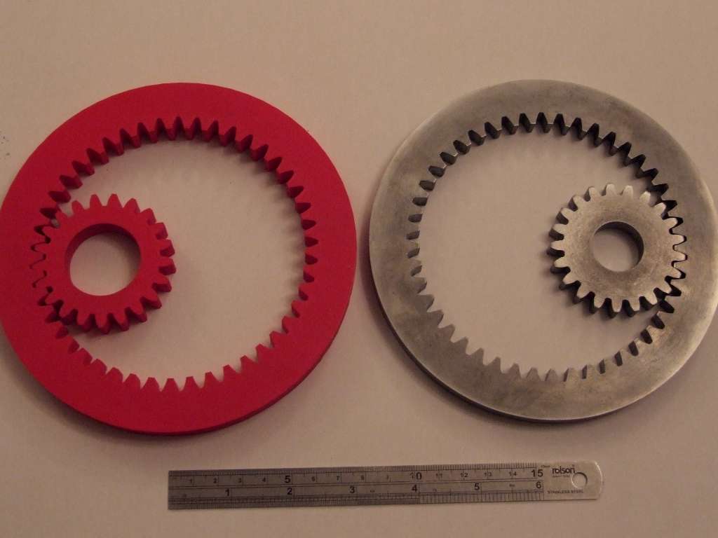

                Second, each gear could be designed in CAD, with the correct tooth form, and cut directly on the CNC mill; no need to make a cutter. The sequence is CAD model:
                Pinion 21 Teeth 10DP 20PA
                CNC milling:
                Pinion 21 teeth 20PA

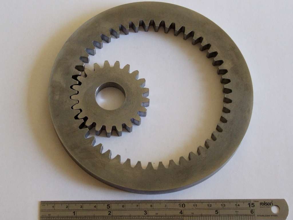

                Finished gear set:
                Internal Gear and Pinion
                For very small gears, or gears too big for my CNC mill, using commercial or homemade cutters is still the best choice. Otherwise I tend to cut gears directly on the CNC mill and cut out the middle man, so to speak.

                    On Huub Said:
                    Cutting gears on the CNC is “limited” (gear thickness) by the end mill cutting edge length.
                    I don’t understand that; I’ve never been limited by flute length?

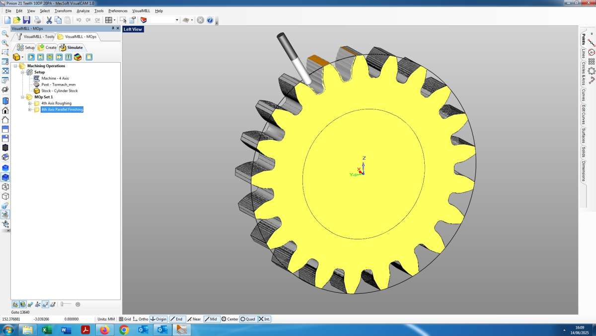

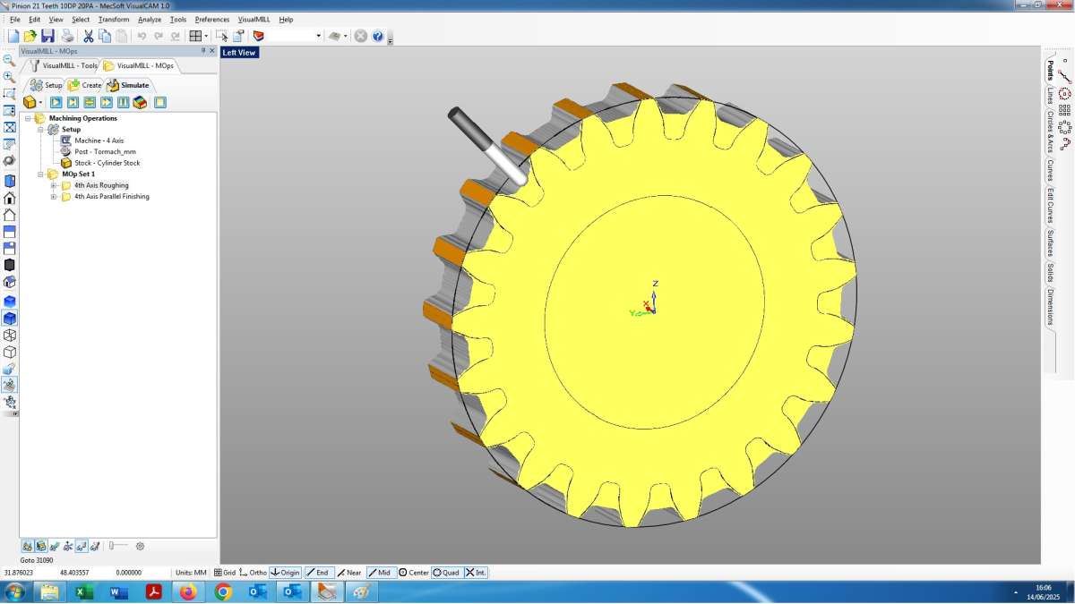

                    Since the involute form is curved, the complete tooth flank isn’t cut in one pass. The only requirement is that cutter can reach the bottom of the tooth gap while still clearing the crest. That is not the same thing as flute length. I use standard ballnose cutters. The main limitation on cutter size is set by the root radius of the gear.
                    The gear shown above was machined in two stages. First, a roughing operation going round the gear multiple times, stepping down a fixed amount at each pass to remove the bulk of the material:
                    Pinion - Rough Machining
                    Second, a finish pass which is profiling, going round the gear once:
                    Pinion - Finish Machining
                    I 3D printed the internal gear set to check that the profiles were correct, and hence that meshing was smooth, before cutting metal:
                    Internal Gears
                    Julie

                                I suppose once you have prooved the concept of cutting form relief there is nothing to stop you making cycloidal form cutters using the same method. And it could be done with a single set of teeth just as easily as multiple teeth, the multi teeth would just act as roughing cutters either side of the central one that cuts the full form so spreading wear over your homemade carbon steel cutters (provided it works with a rack). Just make one for the wheels and as many as you need for the lower tooth count pinion cutters. Got to be cheaper than £80 a pop for commercial cutters.
                                The advantage of a single cutter rather than rack is the form relief can be done with the cutter held flat to cut one side at a time and even with a smallish overall gear cutter dia the toolused to cut it could be a reasonable size say 2-3mm ball nose as you don’t need a tight internal corner.
