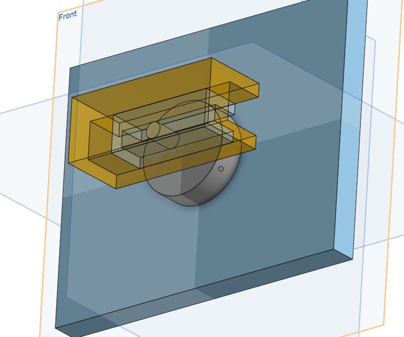

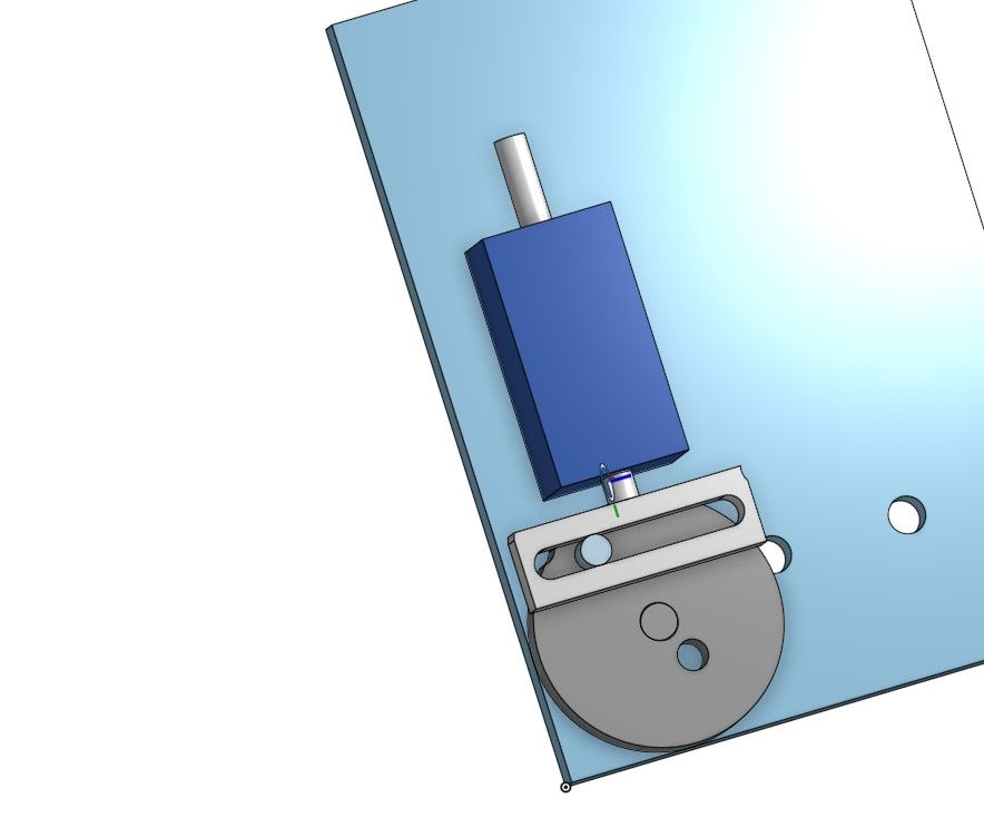

      I'm planning on making a die filer and wanted some advice on how to manage the eccentric.
      I have a Paralux motor with a DC speed control which runs at 150rpm max. I plan to gear that up to a max of 3 or 4 times that which should cover the speed range.
      My main target is small things like crossing clock wheels, but I would like to be able to handle slightly heavier work if need be. So one of the requirements I think I have is to be able to adjust the stroke (clock files short stroke, 9 inch bastard a bit longer).
      I've looked at various designs (and made some up) and would appreciate any input on which would be the most robust and reliable.
      Please be aware the sketches are just to get the idea across. there will need to be a bit more design!
      This is one of the simplest. A wheel with a button on which pushes the slotted bur up and down. Several holes in the wheel to allow different strokes.
      The next one is the same basic idea but the button runs into a bearing which pushes the containing bar up and down.
      I saw that one in a youtube build and wondered if the point was to reduce or spread the wear.

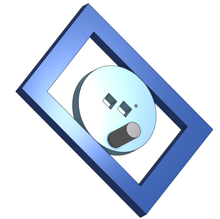

      Finally, and this is my own idea.
      In this case the axle is offset from the centre of the wheel. I thought that I could mill a flat on the end and remove the wheel and replace in alternate square holes.
      I think some of the commercial units (or kits) follow a design like the above, though only with one stroke and the wheel probably permanently mounted on the axle.
      Oh – my first thought was to build something a bit like a steam engine eccentric, but that adds a lot of height/length and would be more complex than the ideas above.
      I hope this makes a bit of sense and all suggestions and advice welcome!

          If the crank pin was running in a radial slot, the stroke could be adjusted
          #584039
            For the couple of scotch yoke options you show I would have the pin run in a hole in a rectangular block and then the block running side to side in the slot. That way you have a better contact area for the pin around it's whole surface not just two points
            Edited By JasonB on 05/02/2022 20:30:46

                The centre one is similar to some of the machines I use to work on one thing some of them had was a bearing on the pin

                  How about a variation on the bull wheel drive system as used on a shaper, turned through 90 degrees so that the resultant motion is vertical. An added advantage, as I see it, would be a slow cutting stroke in the downward direction and a rapid return on the upstroke.  The filing speed would be adjustable as well as the stroke.

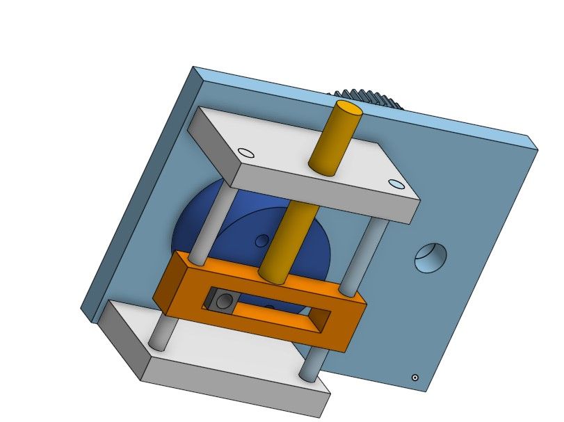

                          I've had a look at the quick return mechanisms and sketched half a dozen options and I think I've come up with the way I want to do it. My drivers have been ease of building, stroke length adjustment and compactness. Some of my sketches made devices which were far too high for comfortable use.
                          This should give the idea…
                          So we have a yoke suspended on two slide bearings (the rods). That's driven by an eccentric wheel where the stroke can be set through a pin (not shown in the sketch) on one of a set of threaded holes at different radii (radiuses?) in the eccentric. there's bronze (probably) bearing which connects the pin to the yoke.
                          round the wheel goes up and do the yellow bar rides. Simples.
                          Apart from any general advice and suggestions, I would like to ask for advice on material. Basically I would like to make it all out of steel, apart from the bronze bearing that drives the yoke.
                          My concern is that the rule is no similar metals on bearing surfaces (except cast iron).
                          The main concern is therefore two sliding bearing bars either side of the yoke and the yellow drive bar (probably all ground sliver steel)..
                          My view/ hope is that with a decent amount of grease, what is not frankly a huge load or speed and less than industrial usage that that will suffice.
                          I don't fancy cast iron for any of the bits both because of the relative fragility and the extra challenges of machine a bar to a nice parallel and fine finish. Something silver still provides for little cost (in this case I already have a bunch, so none).
                          In a pinch I could make the yoke of cast and perhaps put a lid on it to provide rigidity, but I'd rather not.
                          Please let me know what you think….
                          Iain
                          #586968
                            You could do the yoke from steel and fit bronze ( or even Oilite) sleeves either end to run on the guide rods. Then your square block could also be bronze which will run OK against the steel yoke and steel pin.
