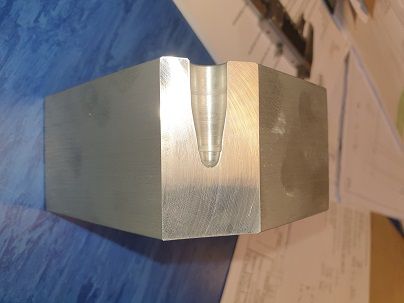

        I have an aluminum block with a 11mm dia. hole, 30mm deep machined in it.
        The problem is the hole is tapered towards the bottom of the hole which I am unable to measure.
        I am thinking of making a 'cast' of the hole so I can then remove it and measure it.
        Has anyone had experience of suitable casting material?
        I had thought of spraying the inside the hole with silicone spray, then pour in molten candle wax and hoping it will pull out in one piece!

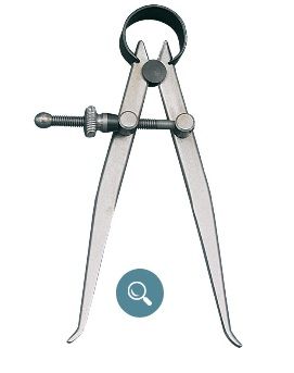

                You could use a pair of internal calipers as the hole tapers inwards towards the bottom. I mean ones like this:
                Not the measuring sort.
                Or ordinary silicone bath/kitchen sealant, after a light oiling as a release agent. How accurate does it need to be?

                      Thanks for all your ideas on measuring this blind hole.
                      Last night I found my self in the local supermarket buying a tub of Play dough and a packet of 'icing clay'
                      I got 'average' results after trying to stuff these products down a blind hole and removing it in one piece.
                      Today I was allowed to machine a hole in half which has made life a lot easier.
                      To give an idea of size, top of hole is 11mm. It now reveals that the hole was drilled in two, maybe three operations. I am going to see my local tool grinder company and ask if they can re grind a drill to do it in one operation.

                        Make a D-bit out of tool steel. Its what I do to make tapered holes for plug valves.
                        Search the internet for how to make a D-bit. They are not hard to make.

                            I am afraid that a drill, because of the way it cuts will not produce what you are looking for. A drill does not cut on the flutes which is what you want to produce a tapered hole. A 'D' bit is the way to go. Step drill the hole to remove most of the metal, then finish with the 'D'bit, make sure the component is securely bolted down as the cutting forces will be astronomical.

                                    I will have a go at making a D bit.
                                    The hole is used to hold a type of plastic test tube.
