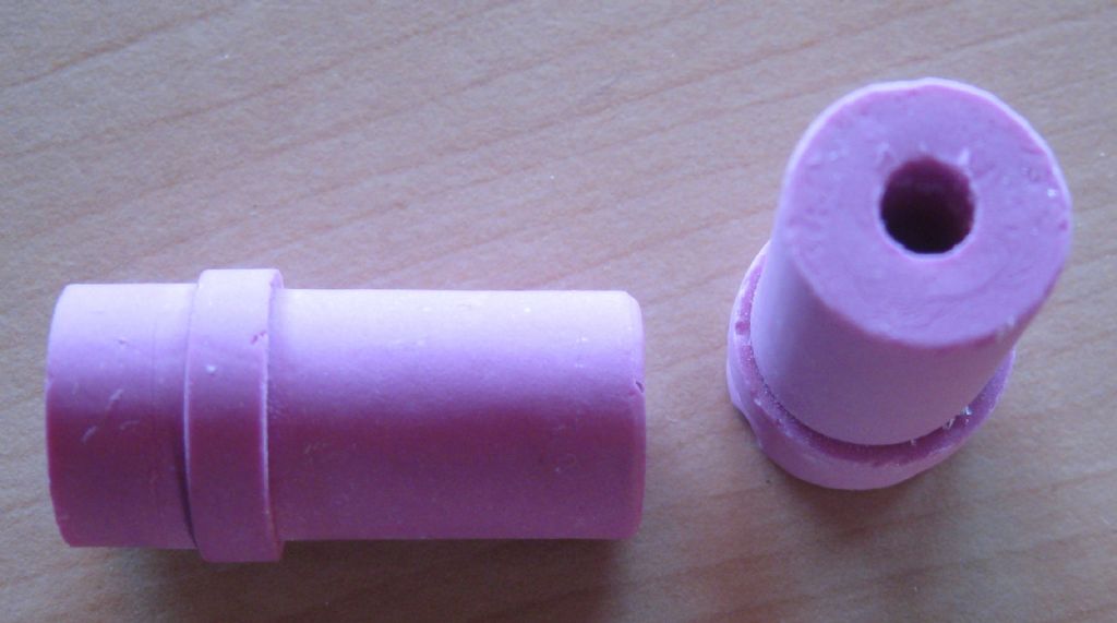

      I wish to enlarge the hole in this ceramic nozzle – it is actually a nozzle for a sand blasting machine, but going to be used for something else, unrelated. The nozzle is 35mm long, 15mm OD, with a 5mm through hole. I would like to enlarge the hole to at least 10mm. Does anyone know of a suitable approach?
      I have tried to find larger nozzles, etc – none to be found.
      The nozzle is the same material as the nozzles on TIG torches it would seem.
      I also looked at all the TIG torch nozzle types and sizes – problem is that they all have 'torch' style mounts, with screw threads, etc – making it awkward to pressgang into service the way I am trying to do!
      Thanks…
      Joe

          How about the cheap hollow diamond drills sold to drill ceramic tiles. These are readily available in various diameters from tile suppliers or the sheds, be prepared to queue!
          I hope this helps
          Paul

            Given the likely nature of the material, I think machining would almost certainly require diamond tools surprise
            [quote]
            Ceramic nozzles for blasting, spraying and casting
            Blast Noozles Spray Noozles
            Welding and Fine Jet Noozles
            Break Rings and Casting Nozzles
            Ceramic material composition:
            · 95%–99.99% Alumina (Al2O3) · Zirconia(ZrO2) · Boron Carbide · Silicon Carbide
            [/quote]
            It would be worth browsing what is available that might better approximate what you want:: **LINK**
            http://www.cerampart.com/product/Ceramic_nozzle
            Edit: Paul’s suggestion is probably the most practical approach to machining

              Michael is spot on.
              I spent a couple of months, 20 odd years ago, boring out some ceramic gears (made with under size bores).
              Diamond inserts were the only thing that worked.
              Jim

                Thanks very much chaps! Paul, your idea is excellent and seems the best option! I did find another process, but that involved raising the material temp to almost white hot, and then boring out…I think not..
                Thanks again.

                              You may find a diamond drill exerts an outward force as it goes down the nozzle and looking at your picture the nozzle with a 10mm bore will have walls only 2-3mm thick so breaking it may be an issue.
                              Should that be the case a diamond burr in a Dremel or similar, while it would take a very long time, might prevent breakage.
                              Supporting each part with a close fitting metal tubes or bushes (I reckon you would need a stepped one for one end and the thicker part and another for the thinner end) might preserve the nozzle while you work on it.

                                  Nick makes a good point. Some of the gears I had to bore out, were only half inch thick. We had bore half way and turn the part around, as boring through just burst the gear!
                                  Jim

                                        They only seem to be freely available in up to 7mm bore. That size would be a better starting dimension to use a diamond burr to enlarge.

                                          Hi Joseph, Just to clarify, the drills I suggested are hollow steel tubes of the approximate desired hole diameter,with diamond grit embedded in the cutting end,
                                          they grind their way through, thus cutting force is very low and no radial pressure as either the cutting action of a twist drill. However no self extraction of grinding debris, so peck and squirt with water for cooling and debris flushing is the way to go.
                                          You could possibly fit the item in a lathe Chuck and drill from the tail stock, as the forces involved are low, you can use a gentle grip in the chuck, but protect your lathe bed from the water and grit!
                                          regards Paul
