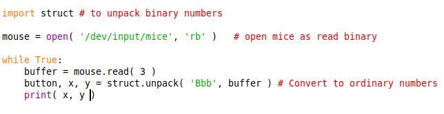

      A basic python program that just prints x, y as the mouse is moved:
      Whether or not an ordinary user is allowed to read /dev/input/mouse seems to vary. If not, run with sudo.

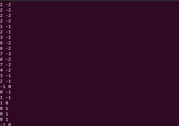

      The output is a stream of positive and negative numbers showing how the mouse is moving:
      Seems to work.
