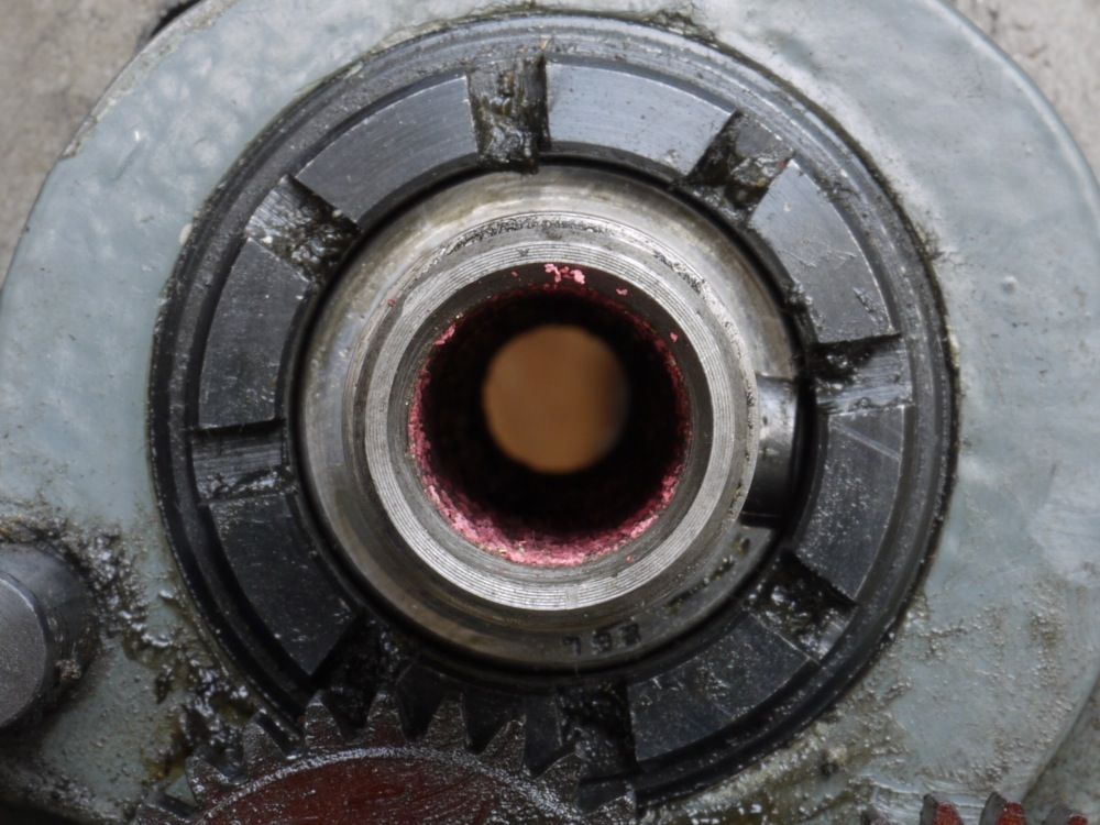

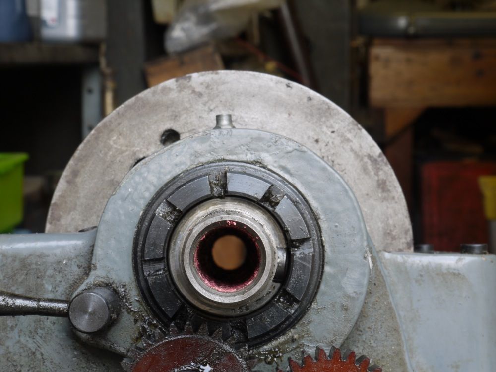

                                                      For your continuing amusement …
                                                      When I removed the collar and gear from the rear of the headstock spindle; I was surprised to find a rather loose-fitting Woodruff Key.
                                                      Closer examination revealed that the key was "hand crafted" from material about 0.077" thick [but about 0.087" at the high spots, where the edges are burred] … The Key should be 0.125" thick,
                                                      Presumably the original key had been mislaid.
                                                      Now: Have a look at this photo, which is the view into the rear bearing assembly
                                                      … There is something a little unusual-looking, just below 3 o'clock …
                                                      A little closer:
                                                      Edited By Michael Gilligan on 17/09/2014 21:36:20
