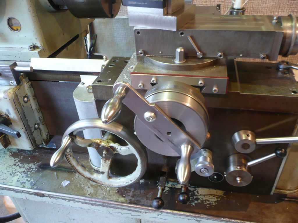

                            Has anyone mentioned the old idea of fitting a larger throw handle to the cross slide, etc? I have made up quickly-fitted extenders to both top and top slides for my larger lathe and find them helpful in obtaining better finish. I have power crossfeed on that machine and do use it but, of course, on a facing cut conventional PXF cannot give constant surface speed. Hand feeding in conjunction with judicious speed increase can give an approximation to CSS.

                                  Ega ; can you post a photo of your extenders please ? I have been thinking of doing something similar as the wheels and handles on my lathe are quite small.

                                      Here is a photo of the cross slide handle on my Willson slant bed. It's a simple piece of flat MS with a hole to slip over the standard handle and another hole to receive the extension handle; the latter came from Arceuro and was modified by having its rotating centre removed and being tapped for the retaining screw. My top slide handle is made on similar lines and I was prompted to make it by a need to improve the finish of tapers. The "inspiration" may have come from the late D H Chaddock whose Quorn book has several photos of his own similar device.
