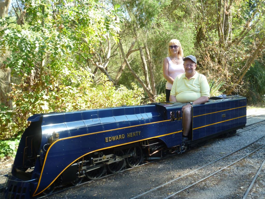

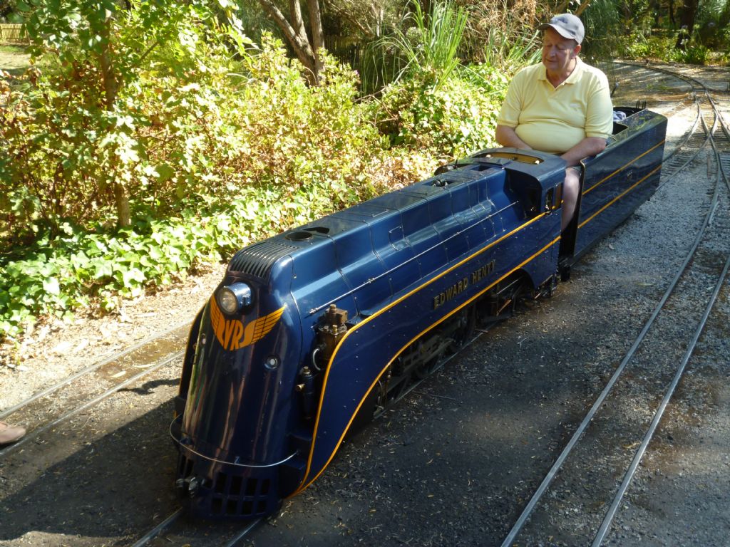

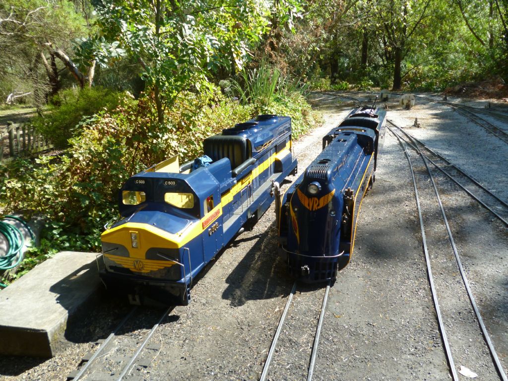

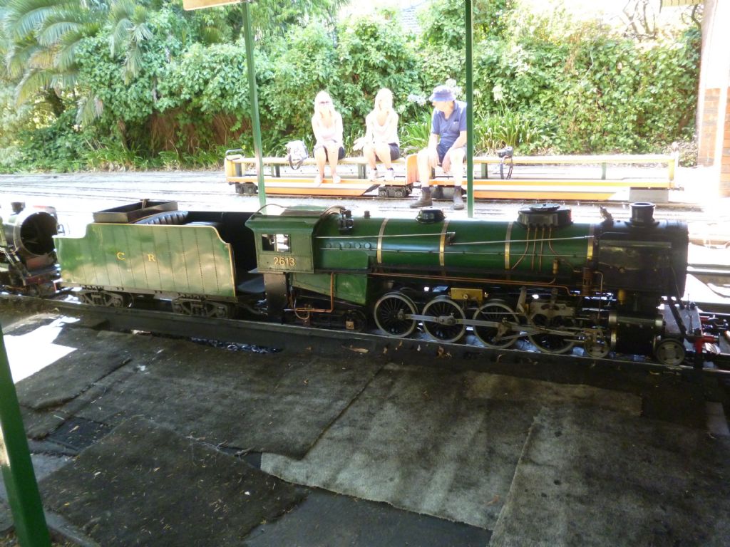

              Hi Dave thought i would share some shots of my friend Colin and Nancy Cambel from Melbourne Australia such nice wonderful couple with a 2 12 mile track in his back garden and runs every weekend.

                    A very impressive setup! Those are very big locos.
                    My father-in-law goes to a place in Qld where the bloke even makes scale bricks to make the buildings with, scale signals, etc.
