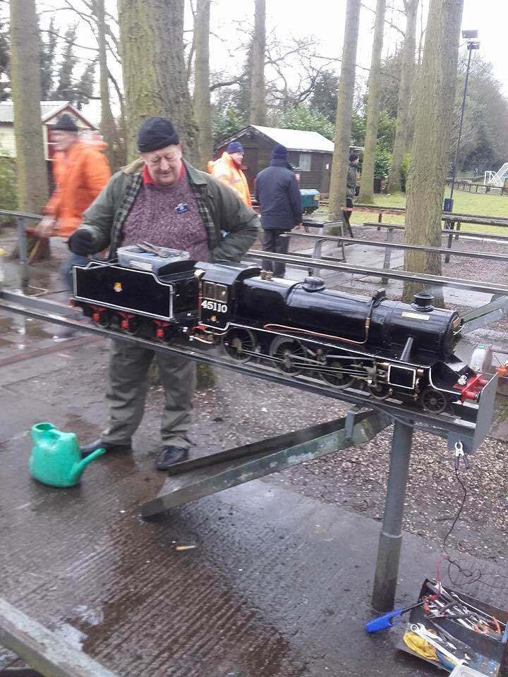

          #283980
          Ron Hancock
            @ronhancock63652

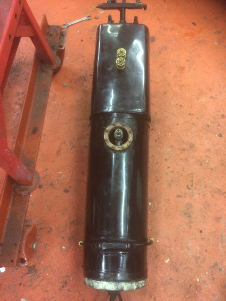

                                            Ron Hancock
                                              @ronhancock63652
                                              #284239
                                              Ron Hancock
                                                @ronhancock63652
                                                Posted by Ron Hancock on 14/02/2017 17:57:27:
                                                #284241
                                                Ron Hancock
                                                  @ronhancock63652
                                                  Well boiler off and filled with citric acid and hot water hoping it will get rid of the green gunk inside.
                                                  whilst boiler is of going to connect axle pump fed up trying to rely on injectors so will just useone injector one hand pump and axle pump.
                                                  It would be nice to just be able to run it without water problems.
                                                  If it does not work after this will take to B P Steam see if Ben can sort loosing patence after so many problems.
                                                  Wish i new why it's getting so much green gunk inside as its only run 4 times two of them never got out of steam bay.
                                                  I think it must be the green gunk causing the problems is their anything you can put in the water to stop it please
                                                  Ron
