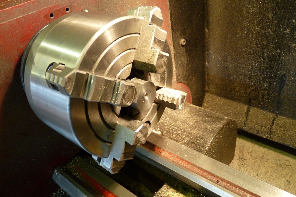

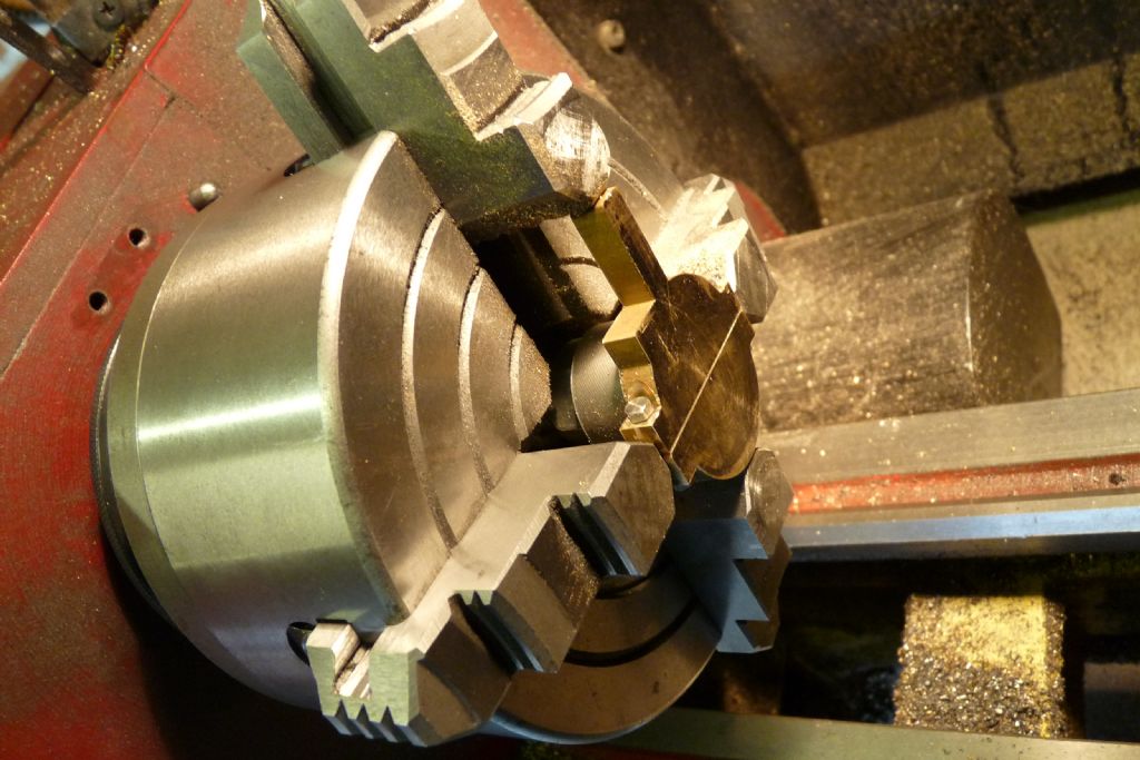

                    Using the headstock taper? Hmmm – how about this?
                    Used like this as a back stop –
                    For thin stuff –
                    Well that's another short article for Neil blown!

                          Posted by Steve Withnell on 07/12/2015 19:48:00:
                          For thin stuff –
                          Regards
                          Steve
                          I love reading threads on this forum. Everyday is a schoolday! Steve thats really practical and nice idea. Is that a Mill MT Taper with your little mod applied to it?

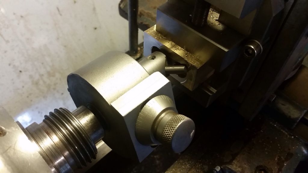

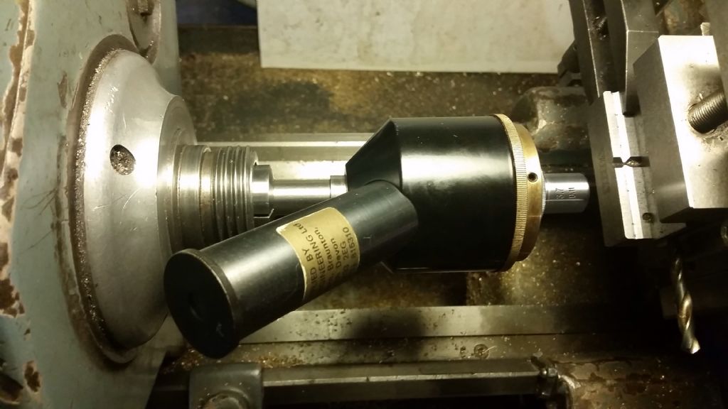

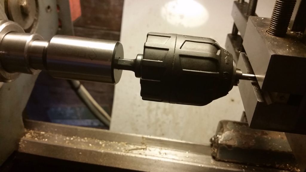

                                  I don't have a Milling Machine, so I use the MT3 taper in my Boxford headstock pretty much all the time. I've just spent a happy 2 hours in the barn swapping out an 'Optiset' centring microscope, a centre drill, a #50 drill and my crappy tapping tool 128 times, making the cylinder cover holes in four G scale loco cylinders.
                                  Optiset
                                  Optiset in a 1/2" MT3 collet. (Does anyone else have one of these? Got it off ebay ages ago)
                                  Threading
                                  Crappy tapping tool – just an MT2 blank arbor and a drill chuck from 'Princess Auto'
                                  Flycutting
                                  Another eBay bargain – nice little boring head, being used as a flycutter.
                                  If I ever get a mill, it will have to be an MT3 one, as all my tooling is this size.
