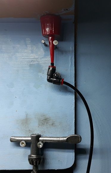

        Posted by Neil Lickfold on 02/06/2019 10:04:05:
        I set up a gravity oil feeding system to the ways on my Myford. I keep the oil pot full when in use. I lower the pot to bed level between using it. It keeps the ways wet, and I wipe it down with a paper towel often. Works very well.
        Your system sounds interesting. Might you post a picture? (If only to get the image of a pot *under* the bed out of my mind!)

          Here is what I set up.
          Re threaded the M5 to the ba # of the oil points. I found that the length of the tubes needed to be the same, or else the shorter tube side got most of the oil.
          Elevated to slowly feed down.

            Neil Lickfold
            Thank you. That looks both simple and ingenious.
            I think your point about tube length would also apply to car exhaust systems.
            PS I am a fan of Rocol slideway lubricant; expensive  in aerosol form but very effective.
