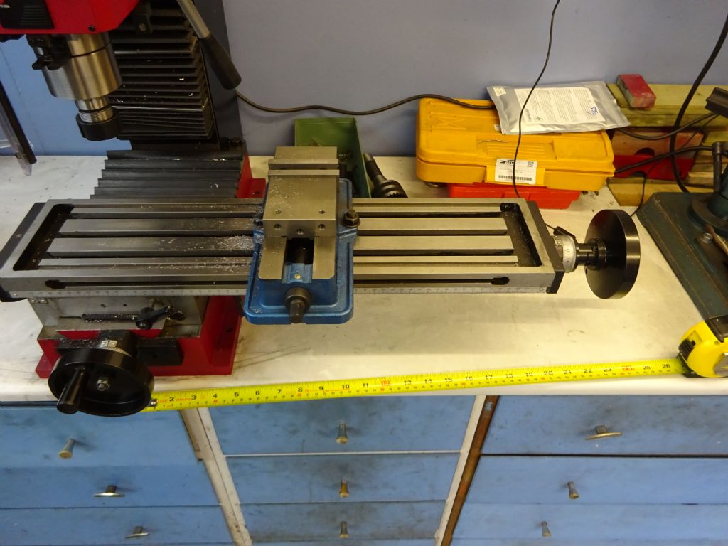

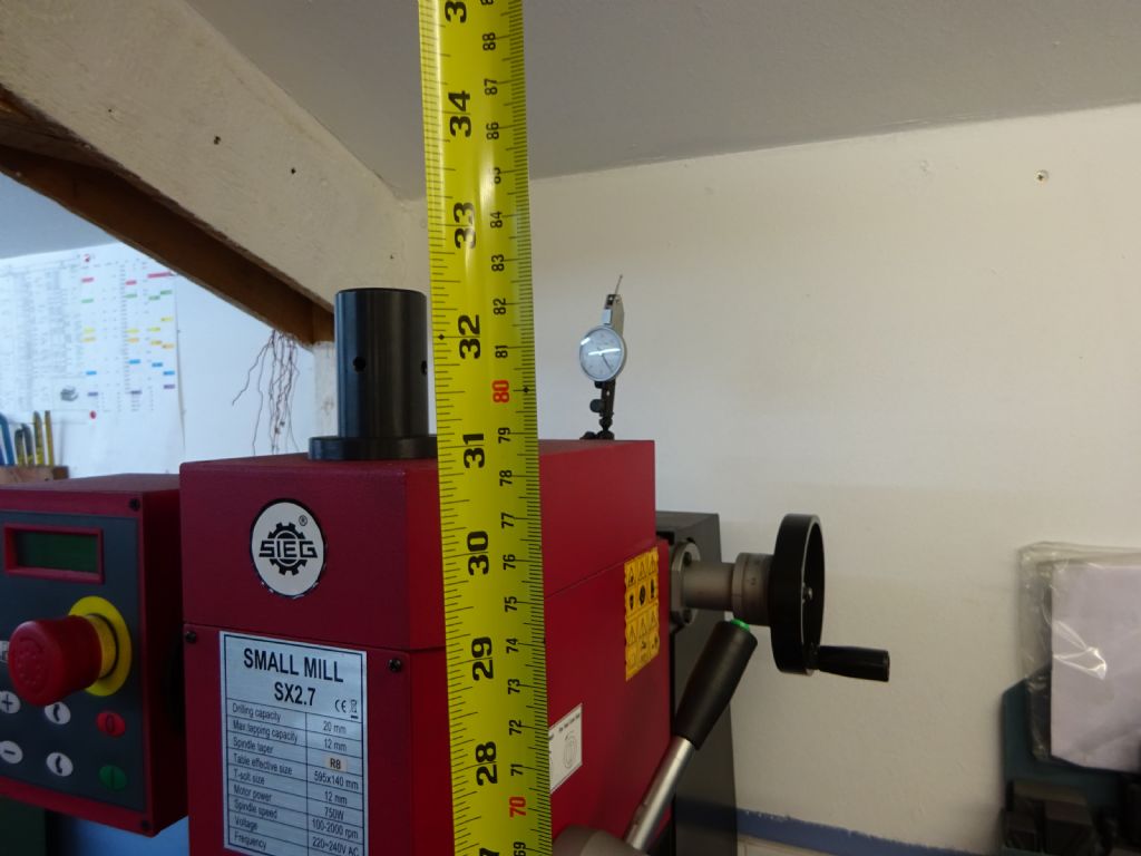

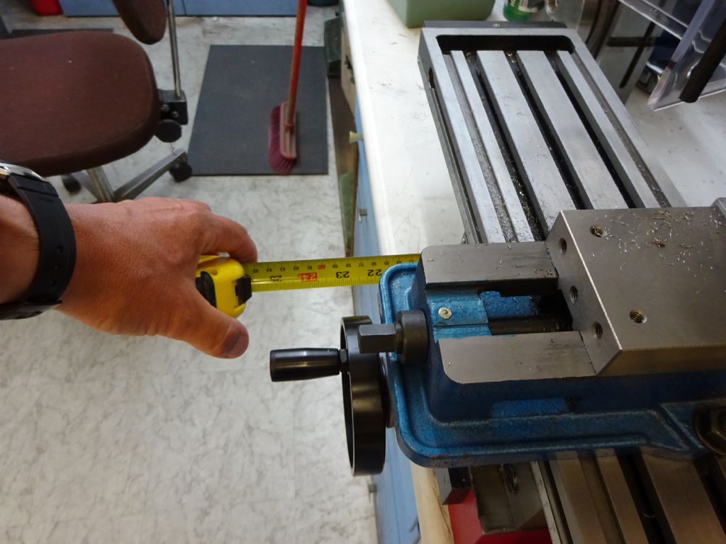

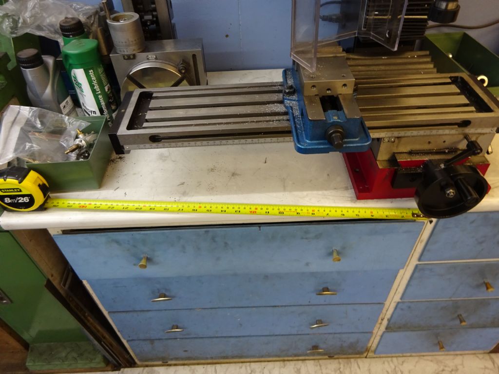

        #362701
          For the standard size table which is the more solid option you need min 650 to the right measured from the ctr of the machine but 700 would save some skin on your knuckles.
          On the left it only needs 550mm ftom Ctr as there is no handwheel
          The end of the Y axis handle sticks out 640mm from the wall, base 520mm from wall
          Height is 850 but you want a bit above that so the drawbar can be changed without lowering the head all the way down so 1100mm but given the bench/stand height that would be within normal head height anyway.

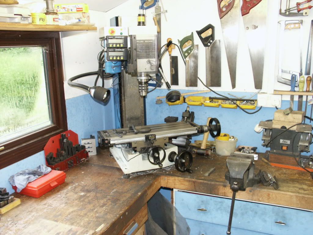

          If you put it across a corner then a triangle of about 1600 on its long edge would be needed.This is how I have my X3 setup.
          In both cases I have the machines on my own benches so you don't really loose any floor space as that can all be used and there is also bench space and wall space behind the table for storage of tooling etc. The metal stand may move the machine further from the back wall.

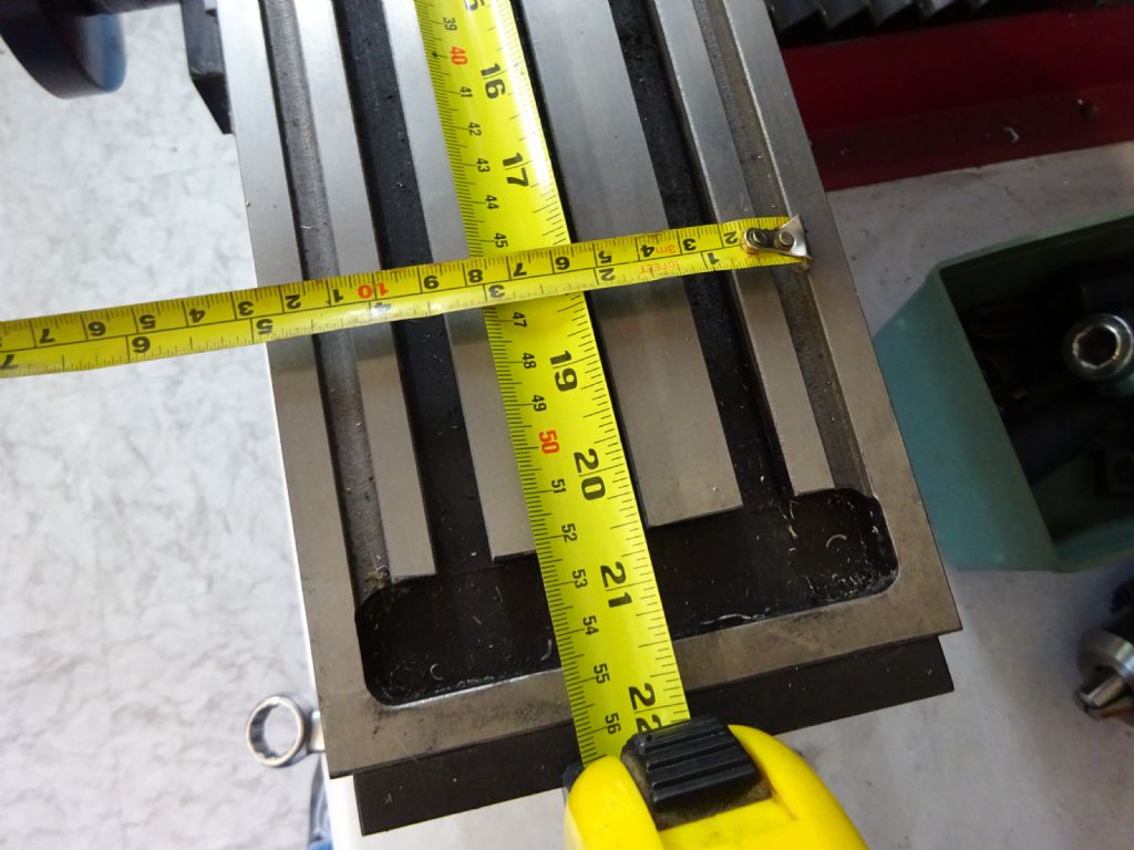

                  The dimensions are not clear on the arc website:
                  Table size 520x100mm.
                  Effective table size 595×100. ??does this include the handle or not.
                  A phone call would have done it – but is this type of thing the purpose of a forum? I would not have got such clear answers as given by JasonB over a phone.
                  #362748
                    The two table sizes are a bit confusing and neither would give you any idea of the overall work area needed to use the machine. I doubt Ketan has one mounted across a corner. I would have replied sooner but could not find the photos I took for another member who has now bought one of these machines
                    The 520×100 is the area within the drain grooves and not really of much interest to us.
                    The effective 595 x 140 is the overall ground area of teh table that you have available to use as a working surface
                    There are brackets at both ends of the table and a handle on the right which brings things upto the O/A width shown on the site.

                          Don’t back your mill into a corner unless you are absolutely sure you never want to work on long stuff. I have both my lathe and mill on the long side of my workshop. Only yesterday I had to turn down and then thread both ends of a 2 metre length of steel rod on my lathe. I’ve also machined the end of a long workpiece on the mill.
                          #362772
                            long lengths on the mill are not a problem with a corner machine if you have a window in one of the two walls, I can put what length I like through the window on the left. Also these mills are light enough to just slide round if you do on the odd occasion want to have them mounted lengthways.

                                When I first installed my vertical mill, in a corner, I checked out the positioning using a graph paper cutout on a scaled drawing of the workshop. Helpfully the manual includes a proper plan drawing of the mill showing the extremes of travel of the table, and ram, including the handles. The travels are tabulated according to table size and power feed or not. So it's easy to work everything out without needing to measure.
                                I've subsequently removed the lefthand handle, for three reasons:
                                1. When using power feed I don't want the handle catching me in a painful place, or hitting other machines
                                2. It gives me a bit more space
                                3. I use the lefthand end of the leadscrew to drive a dividing head for spiral milling
