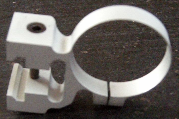

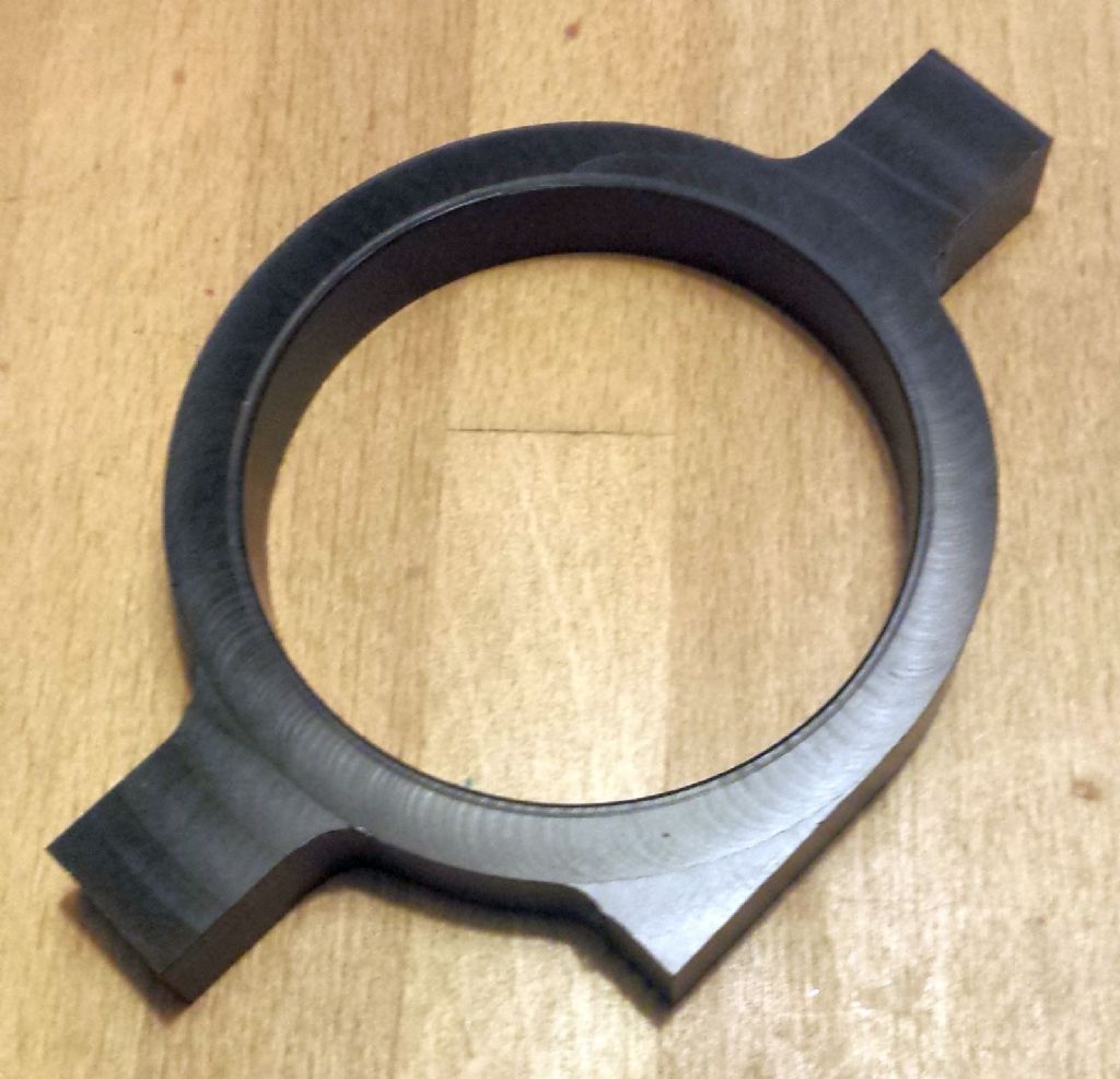

        I need to make several parts like the one shown in the picture and whilst I have used dividing heads many times I'm not sure whet the best or correct technique is to make something other than a conventional ring of holes.
        Given a choice (without CNC) would it better to have the X-Y movement on top of a rotating table, or as more conventionally with the RT on the mill table?
        I have a Vertex BS-0 which is great for indexing and its what I used to make the item shown, but its not really designed to revolve the job continuously whilst cutting.
        I centered the RT to the cutter axis and zeroed the DRO so I could easily cut the outer diameter and stop at the correct point (angles worked out in CAD programme) but whats the best way of then doing the straight cuts?
        For the above I initially bored the central hole and then mounted the part using a mandrel in the RT chuck.
        Is it best to make a straight cut direct to the start of one section of the OD and once the correct radius is reached, lock the slide and rotate the job cutting to the end of that curved section where the procedure is reversed.

          Usually a dividing head is used to position a part for machining. It is not usually used to rotate the job against the cutter. Mounting the part on the rotary table will give a more rigid set up.
          I would machine the central hole and then turn a location disc to centralise the part on the rotary table on the mill. Then I would machine the X & Y faces which if you have it drawn in 2d you can get the coordinates for finally machining the radius.

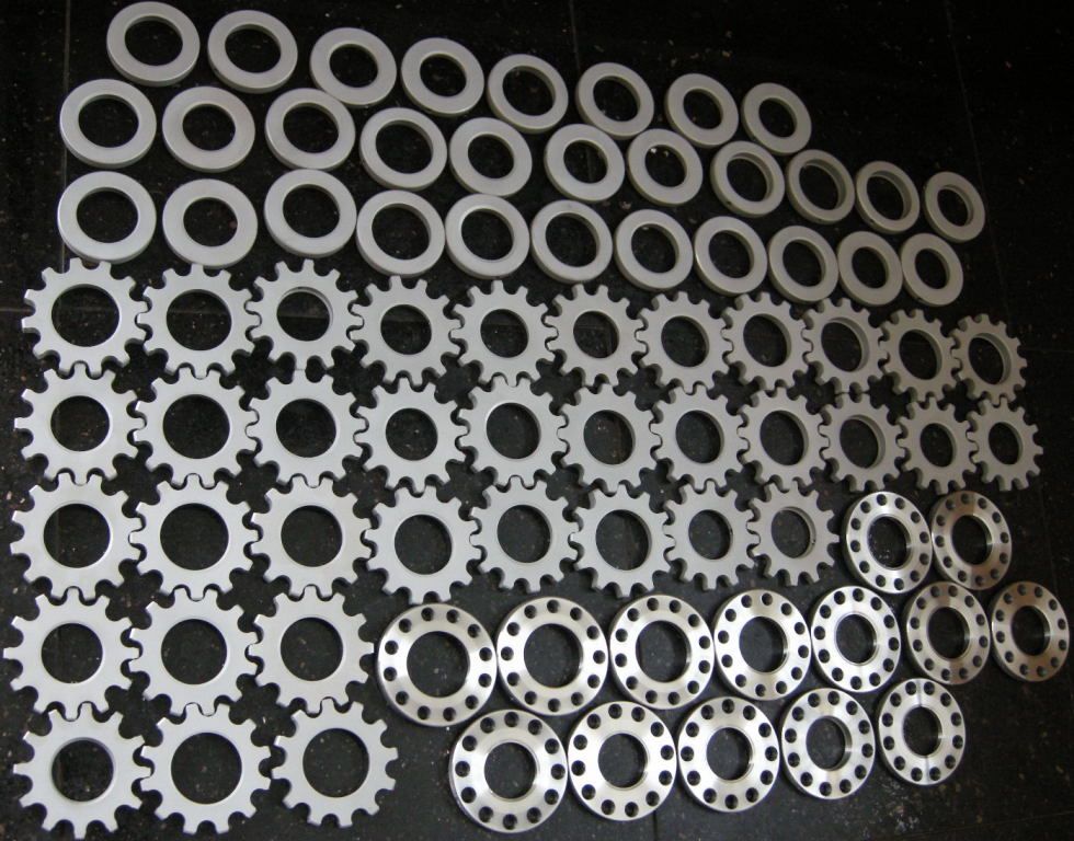

            I do stuff like that all the time in fact two jobs tomorrow a bit more intricate.
            Had to do one today 1" thick in 6082 at 30 degree angle meaning flute length in excess of 30mm, easy on.
            I do use a Vertex 8" RT with small 5 1/4" Bison drilled and tapped to RT, been in use since 1999 that much use the dividing plate holes are oval.
            The only thing I can see with making that is slippage on the mandrel. I would thread something up that would clamp against mandrel downwards. Most of what I do are clamp styles so can clamp cylindrically around the mandrel and at same time mill through excess screw length.
            Fine what you have done swing it up so horizontal, the cutter radius will leave those radiuses.
            Easiest plunge in leaving material for clean up and rough out in one. Have profiled out 1/2" thick in 6082 with only a 4.5mm long cutter, just feel for whats happening.
            Against the cutter take a finishing cut, leaves very little to clean up after for puka finish. Or in the case of that delrin no need to clean up.
            Angles best done in straight cuts down to desired depth leaving the profile to cut after. Also confirms your on the right track and can visualise.

              Here you go Ian one i did earlier for a chap in Estonia, didn't know I had uploaded this.
              Aluminium 6082 thickest and offset around 1", bands probably 3/8" thick leaving 0.72mm to act as a spring. **LINK**/

                The mandrel I made is shouldered and I have a thick washer and central bolt (bore is 50mm)
                On your part are you saying you drill and tap the clamp bolt before you machine the external profile?
                The single projection from my Delrin part is there so I have a starting face where I am going to drill and tap for an M3 screw which will initially sit in a deep counterbore, I will then return the job to the mill/RT and do the finishing cuts on the outer profile without the cutter contacting the screw.
                The reason I have the part on the Vertex is because of its tilting capability, as I can machine the angled faces that are needed on the 'ears'.

                              Jon, what I meant was, what method (very long drill?) to you use to drill and tap for the clamp bolt when the material is still just a rectangular plate. The lugs are still uncut so the point where the bolt will be, is still buried in solid material.
                              I would not rely on a grub screw to grip the mandrel for machining. The clamp screw on the ones I am making is a normal pinch bolt (on a chord contained within the ring thickness).
