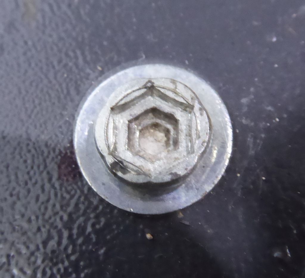

        Some years ago I installed a small safe which I bolted to the floor with a couple of the supplied screws. SWMBO says she would like it moved to a more accessible place, but I can't undo the screws. The photo is the best I can do, but it does show the type of thing. It has two shallow, concentric, hex sockets. The large one is 6mm AF, and the small one is 4mm. They are both very shallow – too shallow for a normal Allen key to get a purchase. I must have used a special tool to insert them, but it's so long ago I just can't remember; and I certainly don't have it now.
        I've tried using 6mm and 4mm keys, but they just cam out.
        After a good look at the (rather poor) photo it appears to have a 3rd, even smaller, hex socket in the middle, but I can't measure it.
        Any ideas folks?
        #358955
        larry phelan 1
          @larryphelan1
          Angle grinder ?
          #358959
          Mick B1
            @mickb1
            How hard is the screw? Drill for the largest screw extractor that won't interfere with the thread?
            Arc-weld on a bit of rod with a tommy-bar?

              Instead and despite the risks, have you not tried telling SWMBO it can't be done?

                If you have a welder, hold a, (non zinc plated), nut over the screw. Weld through the hole and unscrew with a spanner.
                I've had more success by deeply countersinking the top face of the nut first, so it's easier to get the mig wire down to the bottom.

                  Get a bit of silver steel and mill suitable hex sizes onto the end, harden and then use to fit the screw
                  #358965
                  duncan webster 1
                    @duncanwebster1
                    Are the heads hard? If not just drill them off, you've got a centre to start the drill. You'll need to sharpen the drill afterwards
                    #358966
                    David Standing 1
                      @davidstanding1
                      Use your 6mm hex key, but to stop it camming out, grind the end of the key flat, as if it is a decent key it will have a profiled end.

                        Unfortunately, there is no room in the small safe to wield a drill or an angle grinder. The best I can do is use a small Dremel type device, but I'd much prefer to get the special tool..

                                    Sharp cold chisel to try and 'spin' them out.
                                    #358984
                                    Hopper
                                      @hopper
                                      A dab of valve grinding paste on the end of the allen key sometimes helps it grip.
                                      Otherwise, Dremel tool is looking pretty good.

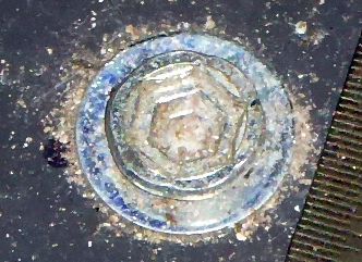

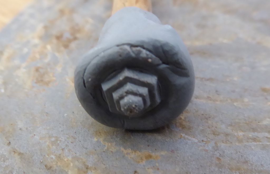

                                        I managed to get a better photo, and also managed to get a reasonable impression on a bit of polymorph plastic – the is the other photo.. Now if I could get a bit….

                                          From the later picture and the impression it seems the fancy hex forms are contained within a raised section; does that leave you enough room to get a grip on the outside of it with a pair of Mole Grips?
                                          Regards
                                          Brian
                                          #359004

                                            #359005
                                            Jon
                                              @jon
                                              Should be easy on plenty of depth there just find a good fitting allen key.
                                              No good if it has play in the hex, best found to date are the plastic covered Wera, fit hex better than anything else.
                                              I use shallow head sockets every day, feed allen key in square press down whilst giving it sum.
                                              #359006

                                                Could you make an epoxy version of your plastic impression, maybe cast the epoxy around a bit of square bar or a screwdriver to allow positive drive later? A bit of cardboard or plastic tube over the screw end, standing upright, could act as a form. It could be sealed with some CA glue at the base, to contain the epoxy. The idea is to make a closely conforming driver for the screw heads, if a steel; driver isn't available. Good luck.
