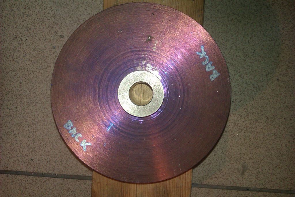

Here is the part already made:
As you can see, it is nothing particularly sophisticated and I bet you already know, how it was fitted…
@Samarsanda, Duncan, John Olsen:
Once brass bush from my ML 7 pulley fitted in old Myford (Nottingham) gone loose I have decided to add Loctite as an additional insurance in power transmission systems whenever practical.
@Mark Rand, Chris Gunn & XD351
Actually it went in nicely at 250*C @ 2thou per inch of interference. All what was needed was a mallet and wooden block, which was not really critical but applied to bottom it down to shoulder.
@Neil
I agree. Loctite is just an extra security here and worth using.
@not done it yet & Duncan,
I ofen use liquid nitrogen for precision parts but this one seemed unsophisticated and liquid nitrogen would not be compatible with Loctite – it would freeze it. I will one day test liquid nitrogen with loctite to confirm this belief, eg I will find out, how fast is freezes.
Duncan, I am not sure about about slower heat transfer in low temperatures – when you look on thermal conductivity tables it seems to go drastically up in very low temperatures. There must be something more to it.
@Hopper,
My freezer goes to -20*C so I can win 50*C, eg 0.5 thou per inch. Every little helps, particularly if you have plenty of time to waste and patient wife.
Anyway, excitement is over and job is done. I hate spoil my work and I have seen professional guy stuffed half way with hot pressed bush. I have seen some obviously messed up job in corner if his shop, asked what have happened (what was already rude perhaps). After bitching for a while he explained that cold bush didnt drop in like it usually does and press didn't square… more bitching followed.
