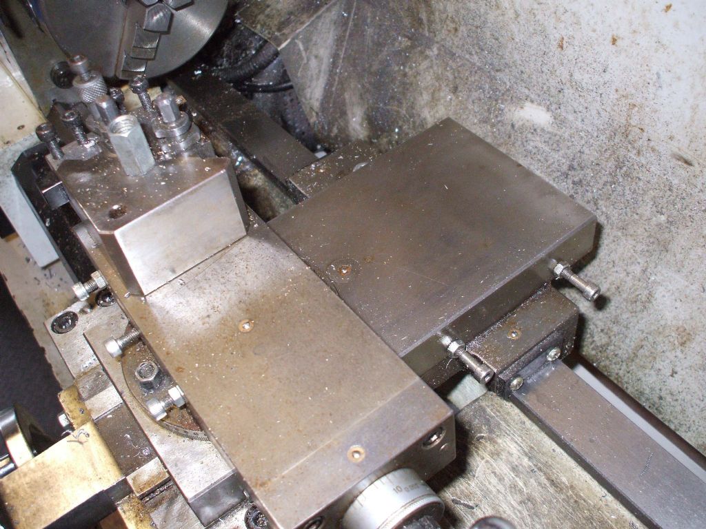

                                  It is possible to mill tee slots in the existing cross slide – IF there's enough meat in it to do so without significantly weakening it. I wanted to mount, specifically, my ball-turning attachment to the cross slide and later some other items for line-boring etc. In my case, I initially purchased a secondhand Myford cross slide and intended to modify it to fit my Asian-made 9×20 lathe. You can follow my progress throuh my album "Cross slide modifications" should you so wish, but to summarise:
                                  The original looked like this:
                                  Asian original cross slide
                                  And, having abandoned the Myford route ( for reasons discussed in the album ), I machined slots transversely thus:
                                  With the topslide re-fitted
                                  No doubt, there is some weakening of the structure of the cross slide, but so far – about four years – no sign of significant flexing etc. I make no guarantees that this will be suitable for your application, however and I made the modification knowing full well that it could all go horribly wrong – though I did make some carefully considered calculations (gambles!) along the way!
                                  The slots, by the way, are smaller (and metric ) than Myford ones but I consider them to to adequate to withstand the likely stresses that will be imposed upon them by the sort of work to which I intend to put them.

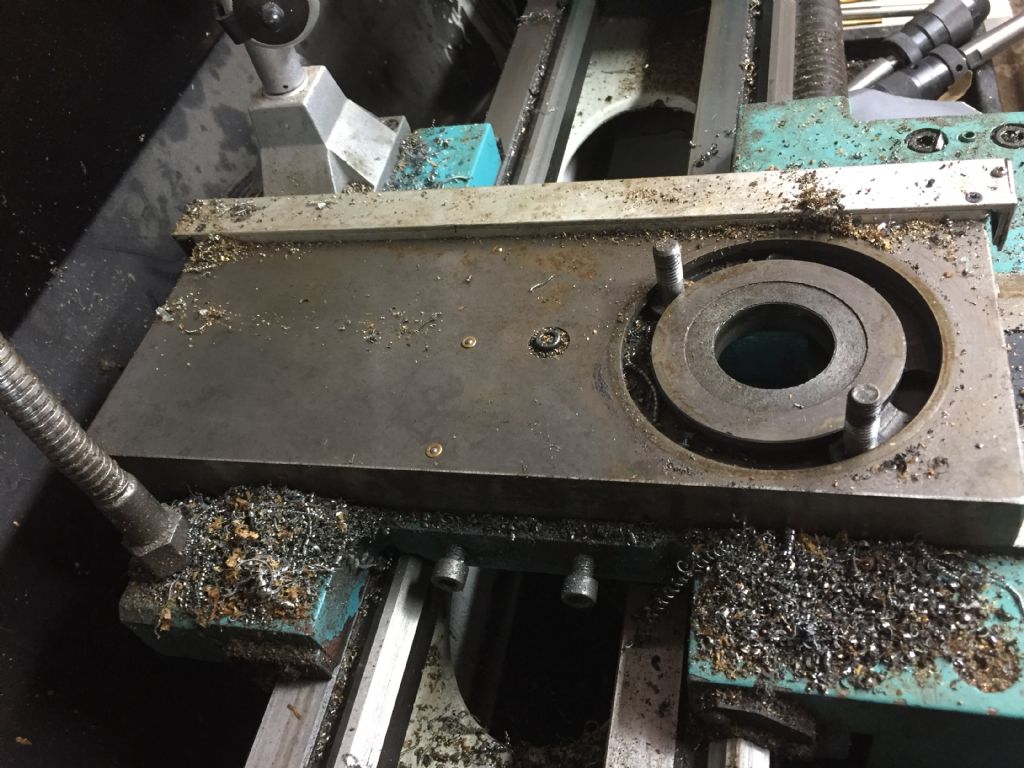

                                    boring bar.jpgI had a similar problem with my Warco lathe .I made an add on plate the full length of the crosslide just over an inch thick ,it is held with six 6mm cap head bolts ,holes for mounting parts are drilled as needed.If your lathe is similar to mine about the rear third of the crosslide is little more than a cast in cover and is quite thin in section so careful placement of the bolts is required.
                                    The topslide mounting ring will most likely be too far from the centre line of the machine to be of any use in holding work in any event to fit longer tee bolts you will probably have to remove the crosslide.
