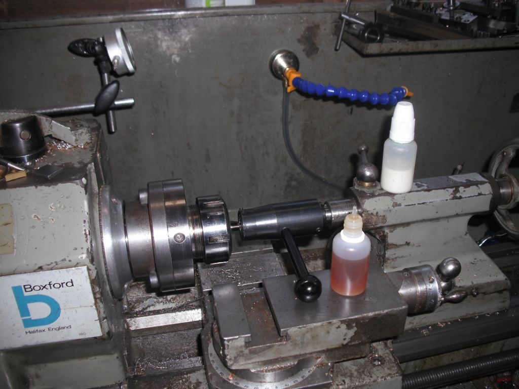

      Hi,
      I'm trying to work out whether I can make some small parts by milling on my small lathe. I am imagining holding an end mill, maybe 8mm to 12mm in diameter, in the headstock, and mounting the metal block to be machined on the cross slide. I can them move the workpiece on either horizontal axis using the slides. I will have to reply on making packing pieces of the required thicknesses to get the workpiece in the right place vertically.
      My question is, how do I mount the end mill into the headstock? As far as I can see my headstock has an MT1 taper (at least, it is 11.1mm diameter at the wide end, which is too small for MT2). The options that I can see are to buy an end mill with an MT1 taper (but I can't find one), or to buy some kind of collet or collet holder that will fit into the MT1 taper.
      This is assuming that holding the mill cutter in a chuck will be unsatisfactory.
      What do you recommend?
      Thanks – Rowan

          All the pundits will tell you that you can't hold a milling cutter in a lathe chuck. You can if you're prepared to take very small cuts with small (say 1/4" diameter or less) cutters. The danger is always that the cutter will "walk out" of the chuck and dig into your nice job. I've often gone the small cutter in a drill chuck route, but always been prepared for disaster. I've seen cutters walk out of chucks – it was a 2" diameter slot drill and I'd nothing to hold it with except the lathe chuck. Horrible idea,despite taking the smallest cuts I could… I used a different idea completely, .
          Alternatives for holding cutters is to make yourself a cutter holder; this can simply be a length of decent-sized steel bar with a grub screw to hold the cutter in the lathe chuck. You also need a flat that you've previously ground on the cutter for the grub screw to bear on. Not ideal.
          Best solution is to get (say) an ER16 collet chuck. They are available with parallel shanks, which can be gripped in a 3-jaw. You will only be able to hold relatively small cutters with that, but if your lathe is only 1MT that's probably all it will cope with.
          A cutter with a 1MT on one end should be axially restrained with a draw-bar to stop it coming out of engagement.
          It also sounds as if you could do with a vertical slide for milling!

            Dont try to hold endmills in a chuck, they are quite likely to slide in/out. An ER collet works, and is what I have been using so far, or there are end mill holders for standard size endmills.
            Easiest way to manage the y axis is with a vertical slide attachment.
            What is the lathe?
            Cheers, Colin

                Why is it better to make a holder or buy a collet chuck and mount this in the 3-jaw chuck? I would have thought that the whole caboodle would be just as likely to work its way out of the chuck as the cutter on it's own would. It seems to me that I need to avoid using the chuck altogether, and use something that fits into the morse taper. This is presumably either an end mill with a Morse taper all as a single tool (are these available?), or a collet that fits directly into the Morse taper, like this:
                MT1 Collet
                or some kind of collet chuck with an MT1 taper on the end.
                My lathe is a small Portass, probably made between the wars. I'm not sure exactly what model – it doesn't seem to have a plate on it.
                I'd welcome any further advice on the best way of doing this. For example, does one need to do something to take up the backlash in the cross slide to prevent chattering?
                Thanks – Rowan

                  FWIW obtain an ER collet chuck, and suitable collets.
                  Don't know of any 1 MT shank ER collet chucks, so you may need to buy an ER chuck with a plain shank, and then grip that in the lathe chuck. Which size of chuck, and collets, that you buy will depend on the size of cutters that you want to hold. ER11 will hold upto 7mm shank, ER16 up to 11mm shank,and ER20 upto 13 mm
                  DON'T fall prey to the temptation to holding a milling cutter in a Drill Chuck. The cutter may well "walk out" of the chuck, and you may damage the drill chuck.

                    I've been milling with endmills, slotdrills and boring bars (often used as flycutters) held in a 3-jaw for 20 years or more. If you tighten the chuck properly, they never pull out. It's much more important to lock the carriage to stop it getting dragged chuckwards if using spiral mills.
                    I'm using a Warco WM250V with a Myford swivel vertical slide for milling. I find an 8mm. carbide 4-flute endmill is particularly good – seems to retain sharp flute-lips forever. I've used it on mild and silver steel, brass, alli and titanium.
                    I think you'd be better with some sort of vertical slide to give you a proper third axis, but if you're reasonably careful and don't get too greedy I don't think there's any problem holding the mills in a decent 3-jaw.

                      The photo you show is a "finger collet" which would do the job fine, if you can get one with an MT1 shank. Aha! You can, the excellent Arc Eurotrade stock them here. Only however in metric sizes. Needs an M6 drawbar. Frankly if your lathe is small I wouldn't use over an 8mm cutter and probably 6 would be better.
                      The problem with holding endmills in the lathe chuck is that they are very hard, and will not deform slightly to take up any misalignment of the jaws. This means that if your chuck jaws are slightly "bell mouthed" due to wear the cutter can worm its way out of the chuck. Putting some soft material between the jaws and the shank would probably solve the problem, but you need to tighten the chuck very hard to make sure the material deforms enough.
                      If your taper was MT2 then you could buy an ER collet chuck to fit, which you would need to hold in with a drawbar. I haven't seen any of these with an MT2 shank though. You can get parallel shank ER chucks – see the Arc website for example – which you could hold in your 3 jaw. As it will have a longer shank of larger diameter than your cutter, probably it would be safe, also the shanks are softer and will deform a bit. Whether you want to go to this trouble
                      Milling cutters with Morse shanks are rare – morse shanks are really for drills and reamers.
                      You need to make sure that you feed into the cutter, so the cutting force pushes the work away from the cutter. If you do that the slide backlash should not be a problem. If the cutting force pulls the material into the cutter it will be a BIG problem. If you have space and the job isn't too big a vertical slide will make life easier – adjusting the vertical height of the cut by packing will be rather fraught!

                                    Some mini lathes do not have a full depth morse taper in the headstock but if yours has I'd opt for a MT1 ER 25 as the range of collets is larger than ER 16. My Boxford has an ER40 on a back plate but it is a bigger lathe.image00002.jpg

                                      If your lathe is small enough to warrant an MT1 in the spindle, I would personally opt for an ER11 collet chuck with MT1 shank. Like this:
                                      Link to ER11 chuck.
                                      That way you can use cutters up to 7mm diameter without fear of overstressing the lathe. Anything bigger and you will be tempted to take deeper or more aggressive cuts which exceeds the equipment's capacity.

                                          I did consider an MT1 collet chuck but it adds yet another weakness into the system in a high stress scenario on a hobby lathe
                                          On the plus side, it's far more convenient and more flexible
