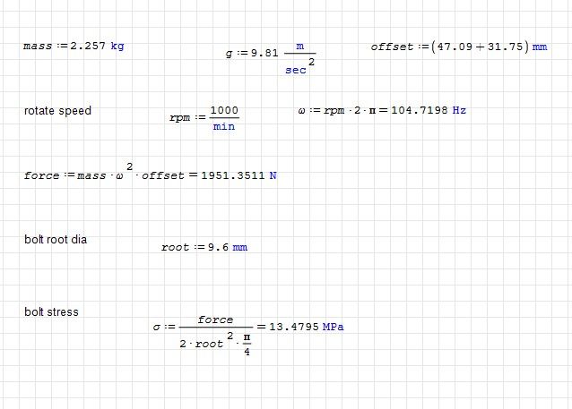

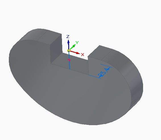

                          So in the absence of any volunteers, I've applied my lack of skill to produce a 3D model
                          The dimensions on the drawing don't quite work. If the 3.75 rad is centred on the top line and you use the 1.5" rad, the overall width is ever s slightly less than 6.375. This has properties thus
                          and then done some sums. I arbitrarily used 1000 rpm, is that fast enough?
                          13.5 MPa is 0.87 tons/sq.in, so we are into congealed monkey snot territory ( as a previous section leader of mine would have put it). What puts a different complexion on it is the 3/8 sq drive dog. Torsion of non round shapes is a bit involved. I've got to take the dog out now, I'll see if I fancy some more sums later. However, this result is not entirely surprising for a scale model, Linear dimensions are halved, so volume and hence mass of weight goes down by factor 8. Radius to cg goes down by 2, so for the same speed, force goes down by factor 16. Bolt diameter is halved so area goes down by 4. Hence stress goes down by factor 4, we are certainly not into grade 12.9 bolts.

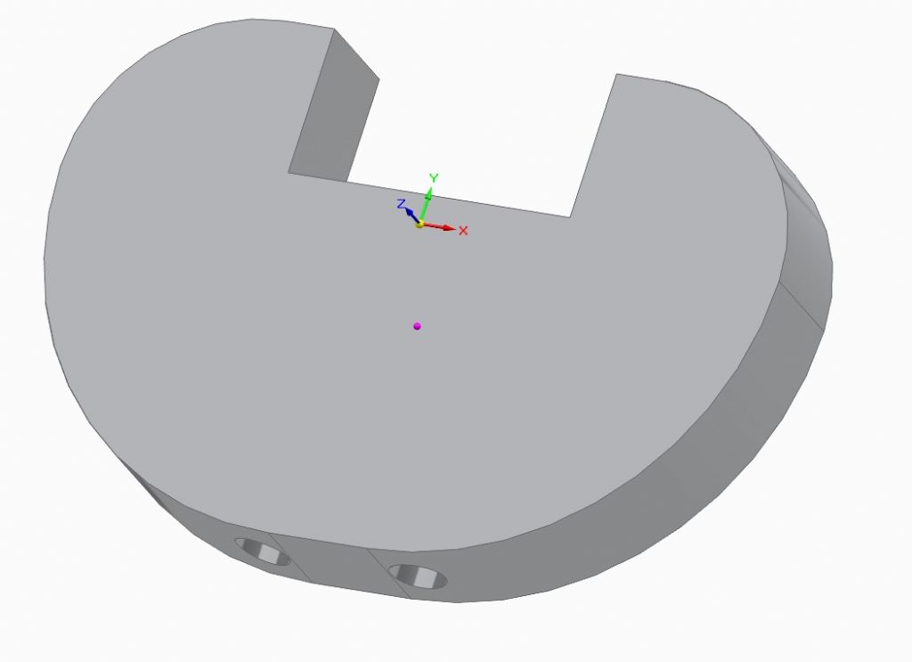

                            All in favour of 'weight of a round cow' estimates, but the counter-balance shape is more complicated than Hopper's simplification, and once the model is created the CAD package does all the necessary maths.
                            Assuming I drew it correctly the weight is:
                            Told the material is StCst10 GOST 1412-85 cast-iron, Solid Edge says the mass is 2.086kg and the volume 306741 cubic mm.
                            The centre of mass is shown by the purple dot. It's at coordinates X=0, Y=-17.04mm, Z=-12.70mm
                            PS.  Duncan got did first while I was typing.  Relieved to see our weights are within 200g.  The difference is because we've drawn the weight differently.  One or both of us has misinterpreted the 2D drawing – I expect it's me…

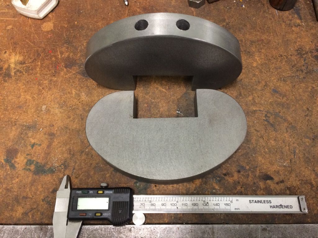

                                I'm not sure about RPM but I agree that 500 sounds like a maximum. I must put my rev counter on my 4" and see what that does, though I never rev it hard in neutral as I am sure it would go faster than I feel comfortable stood nearby!
                                I have drilled the weights for M12 but not yet counterbored them. If I was using cap screws the head size would be 18mm diameter so I guess 11/16 is about right.
                                The weights are a meaty lump, I put one on the kitchen scales and it is 1723 grams.

                                  you put the holes in, I didn't, on the basis that the holes would be full of bolt which is also going round. Perhaps I'm not as useless as I thought

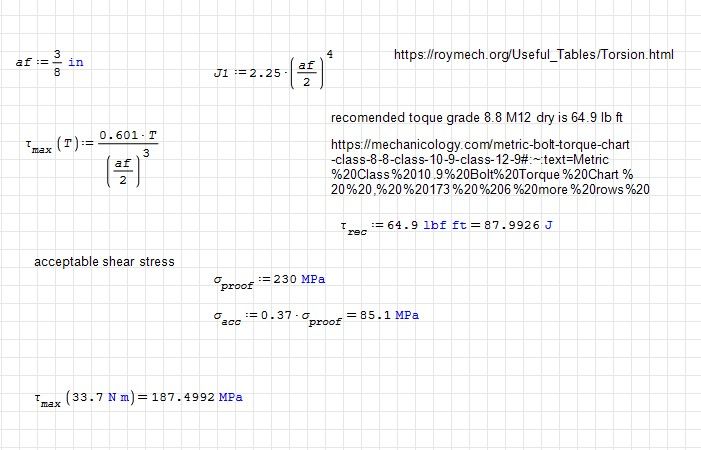

                                      Now I've done some more sums, easier than I thought. According to this, grade 8,8 M12 bolts have a proof stress of 600 MPa, recommended torque 65 lb.ft (88 Nm). EN1a has proof 230 MPa, so recommended torque would be 88*230/600=33.7 Nm. Applying this to a 3/8 square drive gives a shear stress of 187 MPa, which is too high for EN1a by a long way. There's no need to tighten them this tight obviously, 15 Nm would be OK
                                      I'd still use M12 capheads, drill and tap say M5 concentric with the hex (not necessarily concentric with the shank, been there), make an adaptor with M5 spike, the 10 diameter to fit the hex socket, then 10 square (or 3/8 if you're really picky). Then you can tighten the capheads with a proper key, and screw in the dummies with a dab of low strength loctite. If you really want solid and a higher torque, use EN16 and adjust tightening torque appropriately. Limiting feature is still the square, 33 Nm is OK
