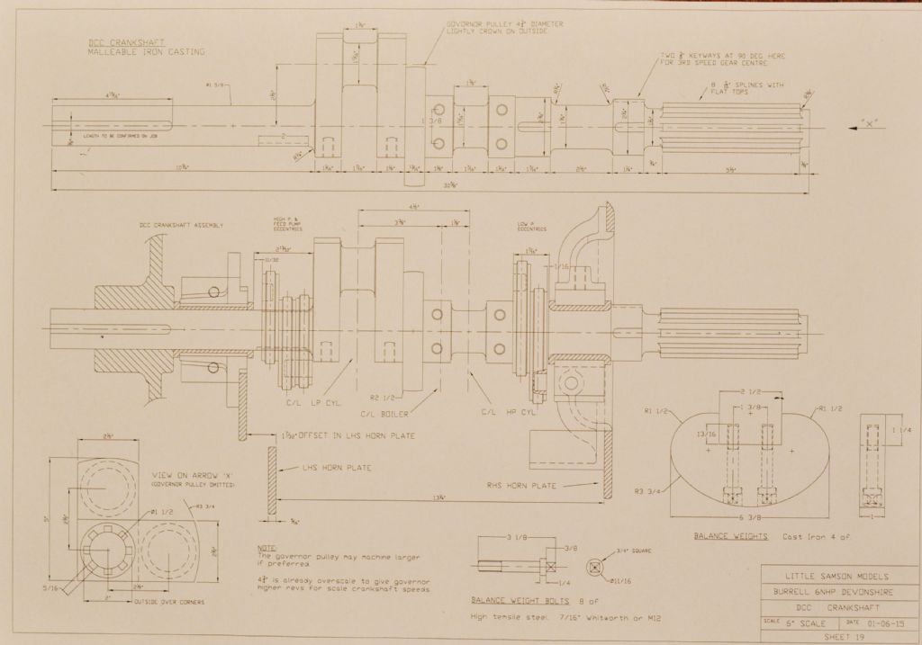

      I have to make some special bolts to hold the balance weights on my 6" traction engine crankshaft. The drawing says to use "High Tensile Steel". Normally in this situation I machine down some tensile bolts. However, this time the shape of these bolts is outside the scope of modifying an existing bolt. I will have to start with some steel stock.
      Photo of crank drawing with bolts bottom right.

          So come on you 3d cad men, save me some tedious sums and work out the mass and cg of the balance weights
              Don't worry about the holes, they will be full of bolt.

                    Can't you just get a bolt who's shank is large enough to get the biggest diameter out of and cut the whole thing from that, square head and all. If you want a spec then EN19 or 24 should be OK
                    Though as these bolts usually had the hole filled with lead afterwards you could just use cap heads and fill with soft solder or JBweld for a similar flush finish. Also a lot easier to do up than trying to get to those square heads.
                    Edited By JasonB on 27/12/2022 07:08:31
                    #626254
                      Duncan, us CAD users need a drawing where we can read the dimensions, I don't think any CAD system can second guess it.
                      Also what to do about the part of the hole not filled with bolt but possibly lead

                          Squinting at the image … I think that would require Qty.8 … 3/4” high-tensile bolts

                                I think the smallest single item his required bolts will fit into is M20 x 120 (74mm plain shank, 12.5mm head). In single item quantities from Orbital Fasteners, they are £1.94 each. Box of 10, £12.94. That might be more post-friendly than longer items.
                                It would be interesting to work out the best combination of standard bolts which would produce what he wants: eight 'blanks' which give one bolt each or fewer blanks which have more than onen bolt inside them.
                                With shorter blanks, you can chuck on the threaded part of the parent item. With a longer blank, you can only do this once, so some of your stock is wasted. With the 300mm long item, the unthreaded length is 255mm, so with some considerable head scratching you might get four finished items out of one bolt. Orbital list these at over £7 each, so two bolts already exceeds the box cost above.

                                      Normally I would use cap heads but the square heads are very visible and in this case not easy to fake. Plus I don't want the rivet counters to get me!
                                      I think the 3/4" dimension is an error. I think it should be 3/8" square with 11/16" diameter head.
                                      I am tempted to go for the M20 by 120mm solution.
                                      The square heads are easy for me as I have CNC mills.

                                            It is only the 11/16" part that necessitates M20. If it would work with 5/8", M16 bolts could be used.
                                            You might be able to forge the head of a standard M16 bolt (volume = 24mm af hexagon x 10mm long) to make it smaller but longer to accommodate say 3/4" diameter x 3/4" long.

                                              Well until Duncan can work out the forces we won't really know what strength fixing is required but having seen many a model traction engine balance weight held on with mild steel straps with mild steel threaded extensions welded or silver soldered into place I would think 8.8 is fine.
                                              You can also get those bolts in 400mm lengths which will comfortably give you your 8 parts for about £1 more each
                                              If the thread is given as 7/16" Whit or M12 then the OD of the flange must be more than 11/16"

                                                      This problem can be boiled down to three questions:
                                                      1. What tensile strength is required to resist the radial force from the rotating weight at max rpm, times the relevant safety factor?
                                                      2. What shear strength is required in the square heads to resist the required tightening torque? Bearing in mind that an increase in torque (to meet the need in 1) means a reduction in tensile reserve.
                                                      3. Does it matter what the bolts look like in detail? ie: would a hex socket serve? Or could the square heads be a bit bigger?
                                                      Which all depends on – for 1 – what the max rpm is, and how accurately and how permanently controlled this is, and what is the proper factor? And for 2 – What size spanners are carried with the vehicle, and is there a way to check torque with the size selected?
                                                      And a further factor: Off the shelf high tensile bolts tend to be much more reliable than home made fittings.
                                                      My guess is that at the rpm at which small steam engines run, the answers are not super-critical. But it also depends on what (if anything) surrounds the rotating crank, and how strong it might be to stop a flying bolt should the worst happen.
