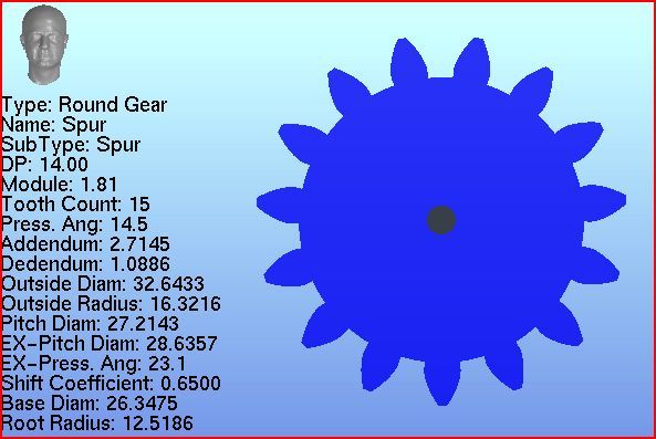

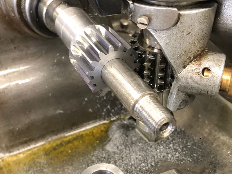

          It makes perfect sense because I fired up Gearotic and generated a 14DP gear, added in some profile shift to bring the OD up to your 32.64mm which gives us a root diameter of 25.04. Your measurements of 32.64-7.4 = 25.24 is only 8 thou different from that so I guess it's fair to say that your gear is in fact a standard 15 tooth 14DP pinion, generated according to the long-addendum info in Machinery's Handbook.

            So just to clarify, I will be able to cut a replacement gear with a 14 DP number 7 involute gear cutter.
            Depth of cut =3.8.
            Philip.
            #412127
            Pete Rimmer
              @peterimmer30576
              Sadly not. The profile-shifted gear must be hobbed, or else you must make a cutter to suit.
              #412129
              Philip Sewell
                @philipsewell33761
                So it's fly cutting with a cutter ground to match the unworn profile of the gear.
                Could you explain the term hobbing please, how is it different from cutting with an involute cutter.
                #412155
                Pete Rimmer
                  @peterimmer30576
                  Hobbing is the process of generating a tooth form by rolling a blank in time with a cutter having (normally) straight-sided teeth. The rolling action generates the involute profile, rather than the profile being ground into the cutter. The advantage is that only one cutter is required for a given tooth form. Disadvantage is the machine and hobs are expensive.

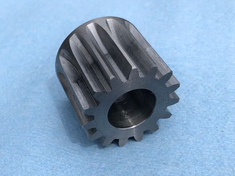

                      #412217
                      Pete Rimmer
                        @peterimmer30576
                        Posted by Nigel McBurney 1 on 02/06/2019 09:36:25:
                        After all the theory…
                        Comes the practice
                        Hobbing a 14dp pinion
                        Send me your address Philip and I'll post it on. You'll have to trim the length to suit.
                        #412236
                        Brian Wood
                          @brianwood45127
                          That looks like a very professional job Pete, it should fit nicely
                          Brian
                          #412239
                          Philip Sewell
                            @philipsewell33761
                            This is a lovely surprise Peter, really kind thing to do.
                            I have pm'd you re address details.
                            Many thanks for everyone's help.
                            Philip.

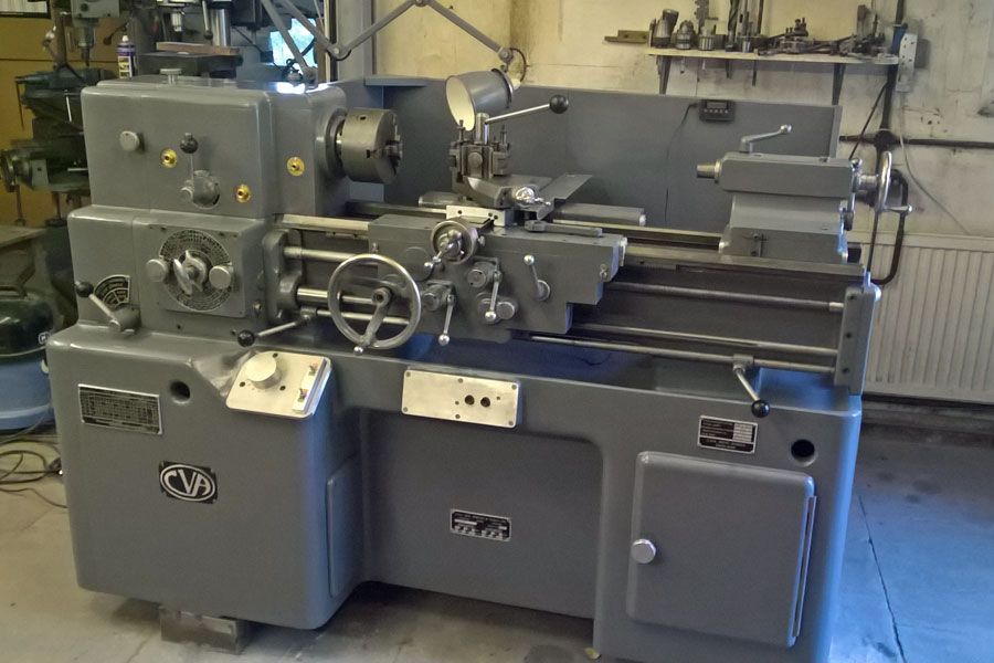

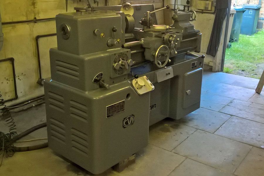

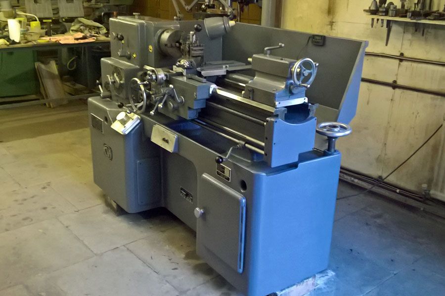

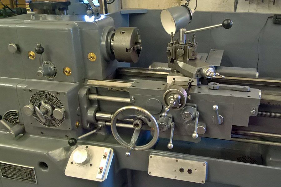

                              lathe5.jpglathe4.jpglathe3.jpglathe2.jpgJust to give some context to the gear thread I've posted some images of the lathe the gear is fitted to, now I've finally finished doing it up. The gear works very well by the way so thanks again Pete.
                              I'm not an engineer so I've learn't a lot about how a lathe is put together. As the gears in the gearbox were pretty mashed up I decided to lock the box into one speed (I put different pulleys on as well) and fit a VFD. I mounted the potentiometer where the change wheel for the gearbox would normally be. Nearly all the original switches etc have been removed although I've kept the one for the suds pump.
