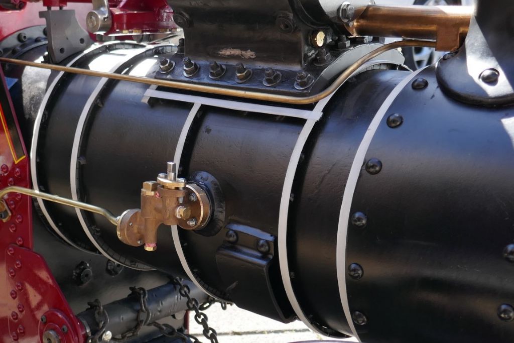

                Not sure what you mean by " insulation inside the copper tube" but on my traction engine boiler I looked at various products, most of which I found would absorb water and cause a possible rust problem ( including fibreglass, I have a steel boiler). Instead I decided to just use an air gap between the boiler shell and the cleading. Air is an excellent insulator if trapped in a cavity. Spacers were used to separate the cleading from the boiler but as the cleading is just wrapped around the spacers, any water can leak through and not remain in any insulation. Adhesive, silicon impregrated fibreglass tape was then applied to the spacers to insulate them from the cleading. The tape is water resistant and good for 280 degrees C. (similar to the insulation tape used inside electric motors).
                Paul..
