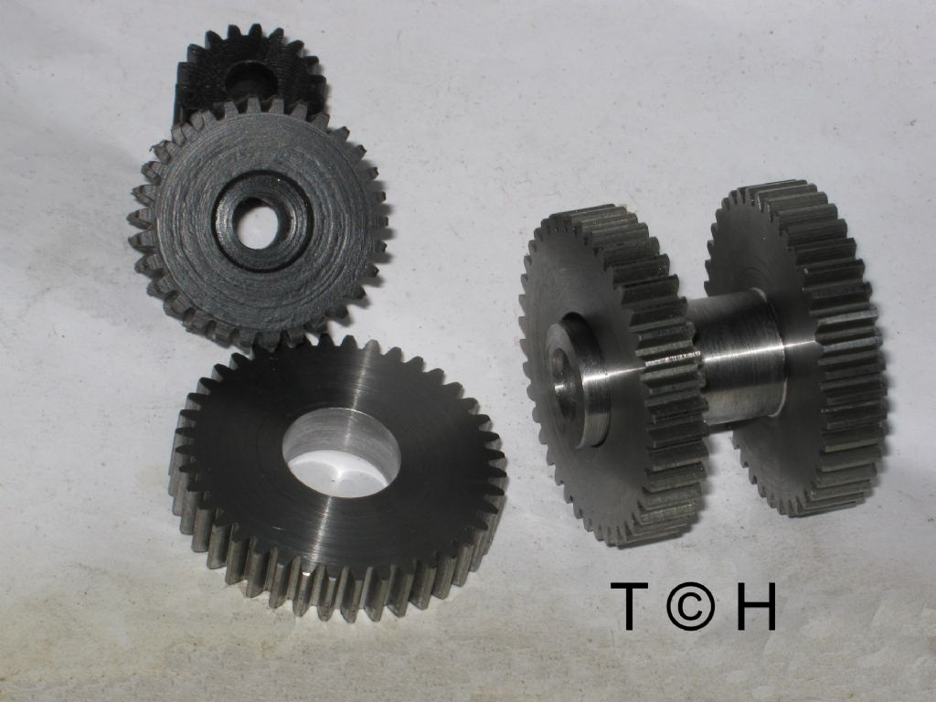

      My resolution for this year is to work patiently on something more complex than anything I've tried before. I would like to make a simple orrery and have set myself a target of 600 hours over the next year for the project – I have no idea if that's realistic, all I know is that jobs which are ten minutes in my head take at least two hours in reality … Time will tell!
      First thing on this path is to learn to cut gears, so I'm looking for recommendations for books/tutorials etc which might help – I have Ivan Law's WP series book which is great in some respects, but doesn't really tell me what tooling/machinery I need within the limitations of my workshop.

          A horizontal mill is good for gear cutting, it normally has low spindle speeds and geared table feeds, most have 1" arbors.
          You will also need a dividing head preferably with a centre support, the head will have means to divide most of the gear teeth numbers required.
          The gear cutters are available as sets or individual if only cutting a few gears within the range of the cutter, more details of the cutter numbers and gears they can cut are well explained in Ivan Law's book.
          Gears can also be cut using a vertical mill if that's what you have or intend to purchase, you do need low speeds for gear cutting especially if cutting the larger tooth sizes in 1 hit.

            For machinery you will obviously need either a lathe with vertical slide or a milling machine, and a dividing head. For tooling you will need an arbor to hold your gear cutters and some gear cutters. You can buy gear cutters from RDG, or you can make your own. I have made my own gearcutters, I also made my own dividing head. To hold the gear blanks I made an arbor with one end fitting into the MT mandrel of the dividing head, the other end fitting the hole in the gearc8gears_0568.jpg blank.

              You can get gear cutters fairly cheaply on the internet
              this is an interesting site http://www.helicron.net/workshop/gearcutting/
              This page https://makezine.com/2010/06/28/make-your-own-gears/ shows you how to use Inkscape which is a freebie drawing package that has a gear generating module and you can generate lots of different gear profiles to see the difference between different pressure angles and DPs and Modules
              single point cutter is an option but gear cutters seem to be so cheap you would only do single point cutter for the experience
              I've cut a few gears with a single point cutter in a vertical mill, piece of HSS, grind it to the same shape as the gap between two teeth in a matching gear, using a primitive paper disk as a dividing head. See photos in my album called dividing. You can get by without a dividing head.
              Use this web site to generate "primitive paper disk" https://www.cgtk.co.uk/metalwork/reference/divider
              Neil has discussed making an Orrery and gear making in some of his threads and they would be worth finding.

                I dont know of any other books than Ivan Law's that apply so well to the home workshop. It contains most of what is needed.
                Re range of equipment needed, for the small brass gears in a typical orrery, you could probably use a lathe fitted with a vertical slide and small dividing head (or rotary table fitted with index plates etc). It seems that sets of metric module gear cutters are more widely available and cheaper than their imperial DP counterparts. For cutting a few brass gears the cheap sets from China might do a turn.
                Depending on the size of lathe you have and the size of gears you want to cut, you might need a spacer under the vertical slide to lift the gear blank up above the cutter held on an arbor in the lathe chuck. Myford makes one of these. Not sure about others.
                Otherwise, it could be an excuse to buy a small hobby mill such as the Sieg X2 etc. which others on here can tell you firsthand about.

                                    Since you are making smallish brass gears in the main you don't need a milling machine or a dividing head. You preferably want something running faster than a horizontal mill anyway.
                                    Aim for an indexing system for your lathe mandrel; there are lots of techniques discussed before on this forum all a fraction of the price of a dividing head.
                                    Then do the cutting with a clockmakers cutting frame and a flycutter or gear cutter if you find some. You don't even need a vertical slide since you can make the frame to mount in your normal toolpost at the right height from the start.

                                        As you already have a vertical mill I'd be more inclined to use that, it will happily spin a typical clockmakers size cutter at 1500rpm or so. You then just need to come up with a way of dividing, a rotary table would be the more versatile in the long run and get more use in the future.
                                        This guy goes into quite a bit of detail about making his on just small Sherline machines, you can do it without the electronic dividing though it does look more appealing than winding a handle round and round

                                              Thanks for replies. I do indeed have a small vertical mill (WM14) and also a Vertex HV6 rotary table, but no tailstock or dividing plates as yet. The HV6 is too big for the mill really, but has proved useful – I might be able to fit it all together for gearcutting.

                                                Considering the diameter of some of the gears you have to cut you will need to pack up a smaller rotary table so may as well stick with the 6".
                                                Debateable if you really need the tailstock, with a stout arbor and backing plate you could cut those without tailstock support.
