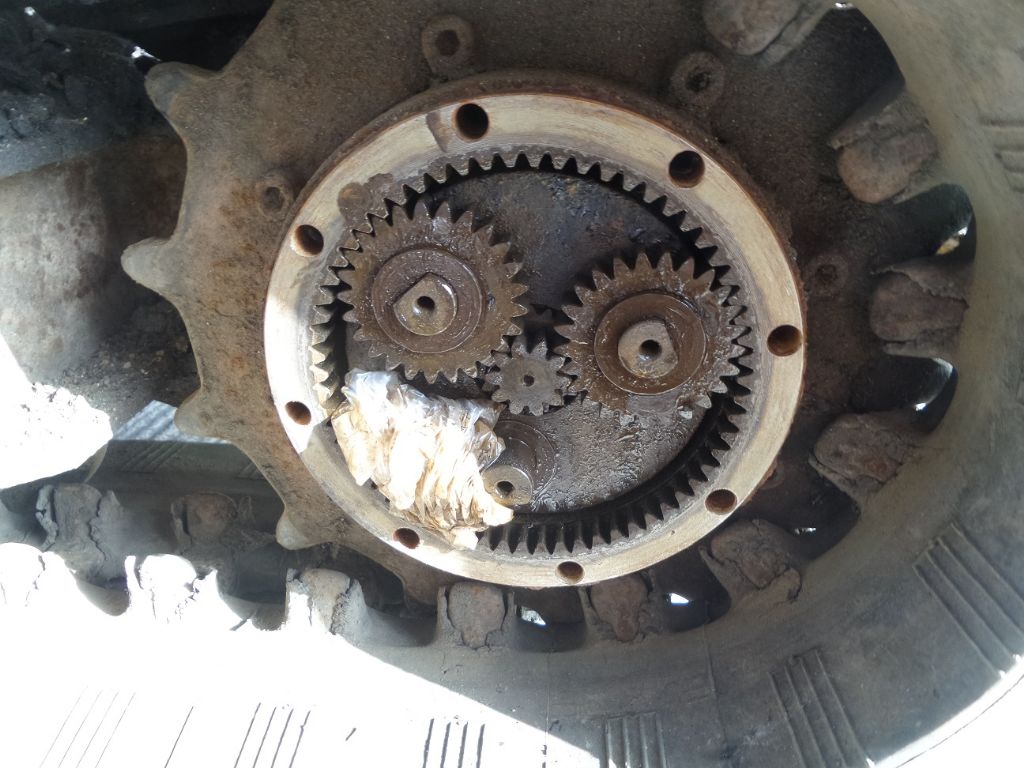

      I'm trying to rebuild a mini digger and 1 of the track drives is missing a few gears. I've searched for the digger manufacturer (CME) and the drive manufacturer (Oildrive) with absolutely no luck, so my only options seems to be, buy a gear and machine the bore to suit or make the gear, which I'd perfer not to do as it probably needs to be hardened in some way.
      The gears are on the final stage reduction and it's missing the 3 planet gears. I've took the other drive apart and measured the gear, and I got a overall diameter of 62.8mm with 25 teeth, it's also 12mm thick. Plugging these numbers into some online gear calculators seem to suggest a mod number of 2.37?
      I have a copy of Ivan law's "Gear and gear cutting" and now I'm even more lost! I seem to require the "PCD" dimension but I've no idea how to measure that. The sun gear is also very worn , so I'm unsure about taking any measurements off that. Any advise you could give would be greatly appreciated.

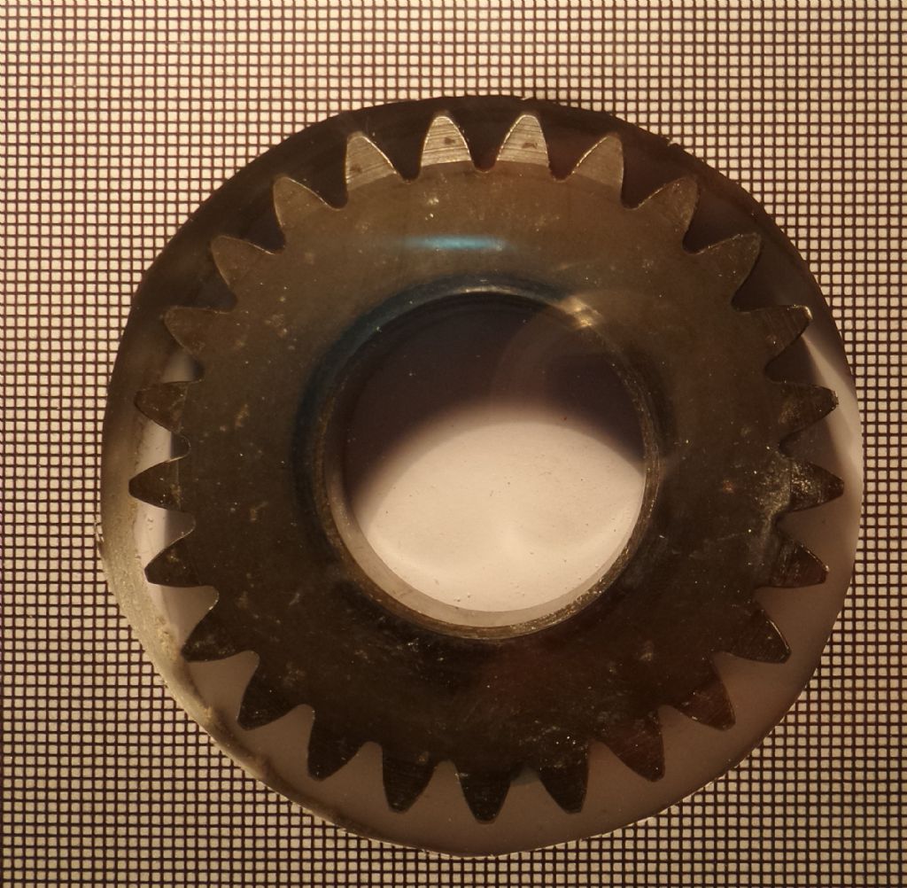

                  I have attached a picture of the gear, I don't have a flatbed scanner so I printed a 1mm grid and placed it around it. I've also attached a picture of the drive to show where they go.
                  I take it that I'm unlikely to be able buy a straight replacement? Is this something that I can get made? Laser cut? Small specialist gear manufacturer? A new drive would be over £1000 so I would really like to get this working.
                  As to why they are missing, I suspect that the drive actually has another fault somewhere and these gears were removed to allow the track to roll, why they then didn't stash them away on the machine somewhere I don't know! I also haven't tested it because it's pointless unless I can get these gears, and the engine needs a few bits sorting, it hasn't run for 6 months.

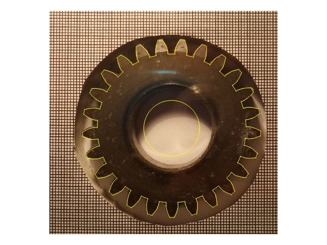

                          Just for fun, I "fiddled" around with GearDXF and scaled your original photo in QCAD, then roughly overlaid the outline of a 25 tooth gear generated by GearDXF. The other parameters – for no good reason apart from that's what the program worked out, given the number of teeth – were pressure angle 20°, tip diameter 64.022mm, pitch diameter 59.8mm. These figures give a MOD of 2.371. It gives an approximation, within the limits of the photo, thus:
                          The yellow line is obviously the gear outline from GearDXF. It doesn't quite match, but it's close, if you take into account parallax, etc.
                          Good luck with your search.

                            Cutters can be got for both 11 dp and 2.25 mod which will be very close to Johns theoretical 2.371 MOD. With suitable attention to the addendum or dedendum one of these cutters would almost certainly fit well enough to work for a reasonable period of time. I imagine any error could be made less than that intrinsic to using B&S type cutters where one cutter covers a range of tooth numbers. The other gears will be a little worn anyway so as new fit isn't going to happen.
                            If you have access to a shaper any odd size gear can be cut. Slow job but it works. I imagine that using one of the other gears engaging in a short rack would work just as well as the wire on PCD usually specified to rotate the gear during feed. A row of pins ought to work just as well as a proper rack.
                            If you do go the shaper route maybe a rack cutter grinding pattern could be made by coating a steel stub with bodyfiller or other rigid but soft enough to shave material to make a slighly oversize rack form. Running it against the standard gear should shave it to the correct shape needed to exactly replicate the original. If that worked the exact specification of the original is irrelevant as the cutter will simply duplicate the original. I'd probably do an intermediate step with an aluminium "cutter" to verify the exact shape.
