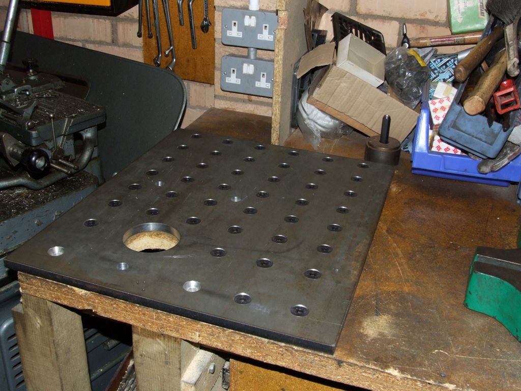

        Good morning all,
        I need to build a bench to hold my No 5 Denbigh flypress.
        I am thinking something about 24×24 inches about 36 inches high using 2x2x1/4" angle with gussets at the corners and a tray lower down to hold tooling ect.
        Would this section material be suitable ? The top surface would be a sheet of 3/16 or 1/4 "
        Any and all advice welcome. I know some of you have been there ,done that !

          Looks very much like Andrew J’s – he’s just reinforced his bench, so that post might give you some clues? He used a 15mm thick plate!

            Sounds about right size but even so I'd reccommend attaching it to the wall as security against it toppling, Either directly or by a strap or chain. Or bolt the feet to the floor.

              Hi Larry don't forget to leave a hole under the press centre to alow longer parts to be pressed on or off. As already stated it must be fastened down and bracket to the wall helps as well. I would use a thicker plate on top at least 12mm thick.

                Sounds a bit light to me. I'd use 2"/3" square thick wall tube and heavier plate. I'd also use proper diagonals, not just gussets. To save the trouble of searching here's what I did to repair my broken bench, note the hole to match the hole in the flypress:
                And with the flypress in place:
                The bench is on 3×3 uprights with cross bracing all held together with 3" coach screws. The rear of the bench is also bolted to the wall behind. My flypress is #3 and I still managed to crack the bench top. Although that was after closing several hundred steel rivets.
                Andrew
                NB: The hole in the flypress base is currently filled with a blank to support the rivet fixture while I'm riveting my traction engine wheels.

                  My thanks to all, this is exactly to kind of info I was looking for. Never thought about such a thick plate for the top. I did think about leaving a centre hole to deal with those odd jobs. Good advice regarding bolting down and fixing to the wall [ there goes another piece of my wall ! ]. The thought of that thing tipping over is scary !

                    Make the stand as heavy as possible. Plenty of diagonal bracing. Maybe some concrete (slabs?) in the base to stop it moving about. I would aim to make it free standing, a vigorously used fly press can generate some considerable forces, wouldn't want those transferred into a lightly constructed, for instance, garage wall.

                                  Been there, done that. Ok for light work, like punching out small brass patterns for brackets to hold thermistors on battery terminals. But once I started using the flypress to its capacity cracks starting appearing; mainly in the bench top. Make any stand solid and then add more bracing and weight.

                                      Many years ago I worked in a metallurgical laboratory. There were 4 fly presses, all mounted on very heavy wooden benches. These benches had long (4ft ish) 3/4" bolts pulling the benches together, these required occasional tightening. These benches were not bolted down but were allowed to come up against a piece of 4" x 4" x 0.5" steel angle bolted to the floor
                                      The presses were and still are used for stamping out tensile test specimens from a variety metals, typically something like 1mm thick and 125mm long. Easy work in brass and aluminium, a bit more oomph needed for mild steels. Then there was maraging steel, a two balls job! We found that we could safely hang a second ball from another press on the "arm", still took some effort to get through!
