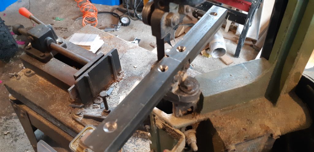

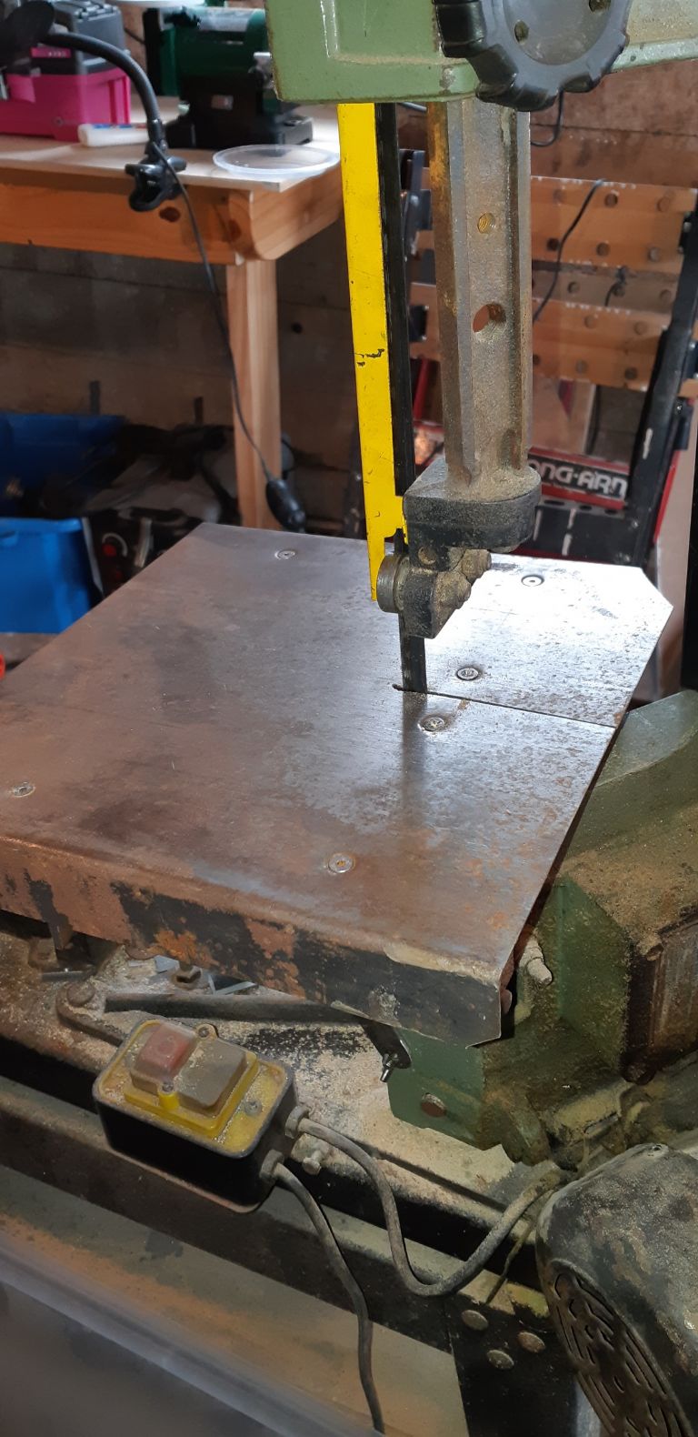

                                          20190331_151540_resized.jpgI have an old warco 6" metal bandsaw. It's not the 'standard' one that everyone sells, but it has a swivel feature for cutting at angles. It also came with a small table for use when the machine is vertical. I lost the original table in a house move ages ago, so I made a new one. I think it might be possible to modify the more usual non-swivelling type. I have more pictures in my album.20190331_151205_resized.jpg
                                          I remember having to machine the end of the casting to make sure the table was square to the blade once the table was on. Apart from that it was fairly easy. Apologies for the really crappy workshop.
                                          Hope this helps
