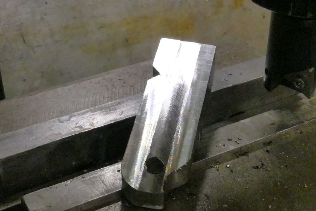

                          This is a "Little Hogger" Ø25 two insert milling tool. The inserts are as plain as you can get with a flat face. The workpiece is just a bit of scrap mild steel. This is what correct feeds and speeds does.
                          RPM 860
                          Feed 150mm/min
                          Depth of cut 0.5mm
                          Machine is the much maligned round column mill/drill.
                          Martin C

                            So this is my 40mm one running at 800rpm, feed of about 200mm/min, 0.5mm DOC doing a full width pass on some 40mm wide EN3. Bit of gear noise from the head at the end of the cut as the engagement falls off and does not quite pass the Sharpie test but not too bad a finish, would benifit from a finishing pass at about 100mm/min.
