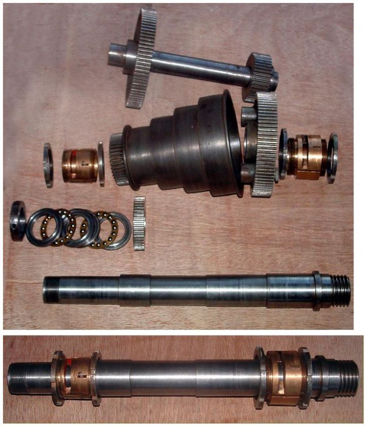

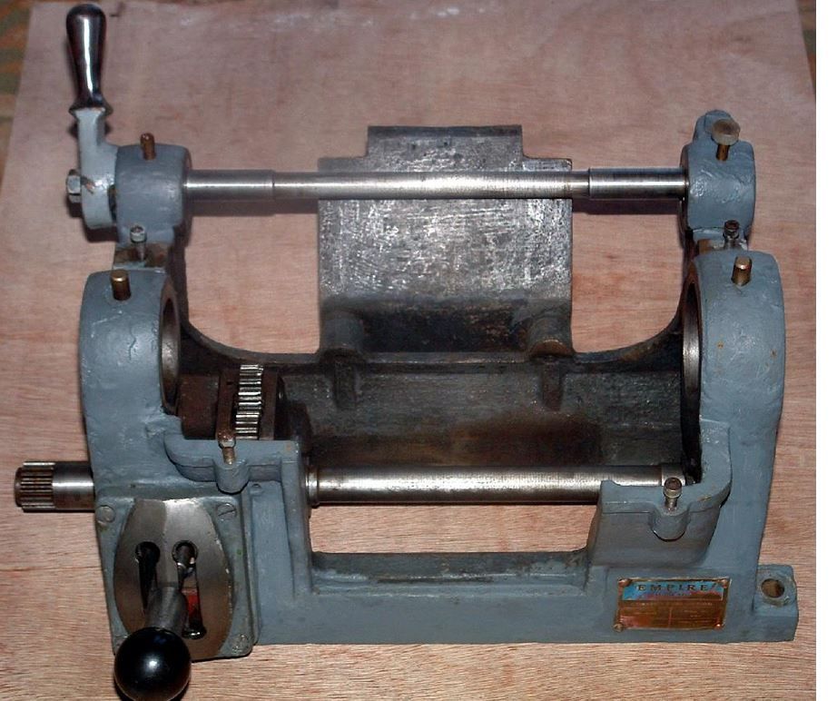

          mark smith 20
            @marksmith20
            empire 2.jpgempire.jpgFrom the Tony Griffiths site , they appear to have a slight taper on the MKI lathe the MKII had timken roller bearings and a more robust headstock..

              As Marks pictures show if your Empire lathe is the same as the one here :- **LINK** there is not enough metal in the plain bearing headstock to fit taper rollers. In such sizes taper roller bearing OD will probably be approaching 2" greater than the bore size.  Were it that easy the makers would not have produced an entirely new headstock for the taper bearing version.
              If you really want to change to anti-friction rolling element bearings, adjustable plain bearings are quite thick so there might be room for a needle roller assembly. SKF and other brands do high quality combined needle roller and ball thrust bearing units that should more than adequate for home workshop level lathe uses. Probably wise to be sitting down with glass of suitable restorative to hand before asking the price tho'.
              In a practical world a step too far given that the Empire was made as modestly priced, modestly specified but none the less effective machine of its era.
