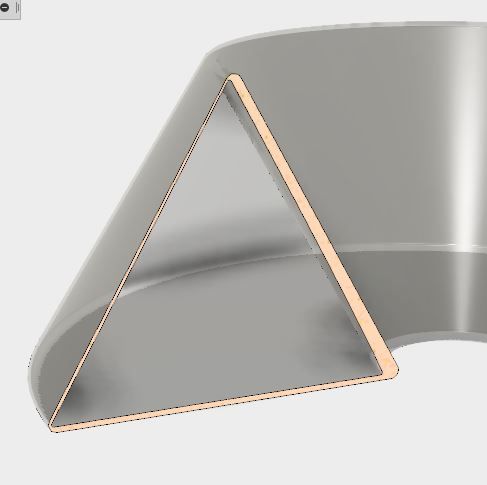

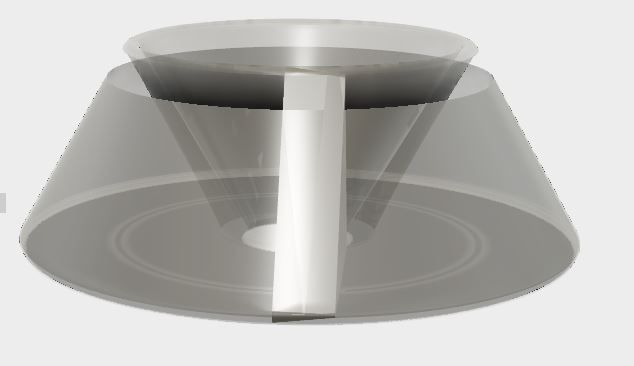

          In the interests of science and to test my Fusion 360 skills, I made a 3D model of the insert and used it to produce a revolve extrude (using the front cutting face of the insert) and made a circular sweep cut (using the trailing face – they are offset by 2.38mm). The shell formed by these operations shows the clearance at the trailing edge and if this reached zero there would be burnishing. You can clearly see that there is a small gap. Fusion's measuring tool doesn't seem to offer any means of measuring the thickness but the large (outer) chamfer radius is 0.4mm for scale.
          Sweep shell
          I hadn't realised how large the tool was. The length of the cutting edge is about 19mm for a "11mm" TPGT insert and there appears to be about 8mm between inserts, making the overall major diameter about 44mm(?). Fusion 360 struggles to report any useful measurement as things stand. Hopefully they will improve that aspect soon. However, playing with the position of the insert it seems that until the radial distance between the inserts goes below zero, the clearance is finite. Once you go to a single insert and start to bring the inside edge of that insert within and past the centre line, the clearance will become zero. That means you can't reduce the overall diameter below about 3.5 times the inscribed diameter (11mm here) with a TPGT insert.
          This would have been easier in Solidworks, Solid Edge, Inventor etc but I thought I'd explore Fusion and also my own capability.
          Hope this is vaguely interesting!

                Haha, silly me again. I couldn't understand why the Mitsubishi insert I downloaded seemed to be too small. Now I know why:
                The ISO system defines the "11" as referring to the edge length for this insert, noting that a "TCXX11" insert has an inscribed circle of 6.35mm, yet a CCXX06 tool of a similar size is defined by the inscribed circle of 6mm. Go figure – I'm sure it made sense to the authors at the time. Anyway, it caught me out. Something useful came of it!
                I was able to use SE ST7 for a while due to my daughter having a full licence for her studies. Very nice – preferred it to SW I must say. I'm exploring F360, partly due to the full 3D CAM that comes for free (it's HSM Works) and although it still lacks a few features, they are on the roadmap. I believe sheet metal is about to be released and they already include FEA (thermal, stress etc) and surface modelling.
                Murray

                    When I corrected the insert and cutter dimensions (11mm between apexes, 2.38mm height for TNGT110204, 26mm across widest point >> centre line rotates on 7.5mm radius), it looks more lifelike, although I now get a contact at the top of the cutting path. I think it may be time for me to move on….
                    corrected insert size - 11mm edge 7.5mm centre radius

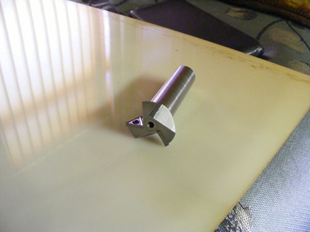

                      #254024
                      Raymond Anderson
                        @raymondanderson34407

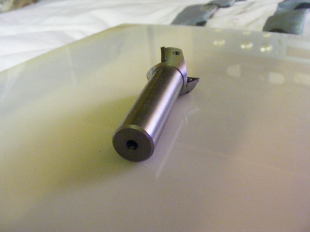

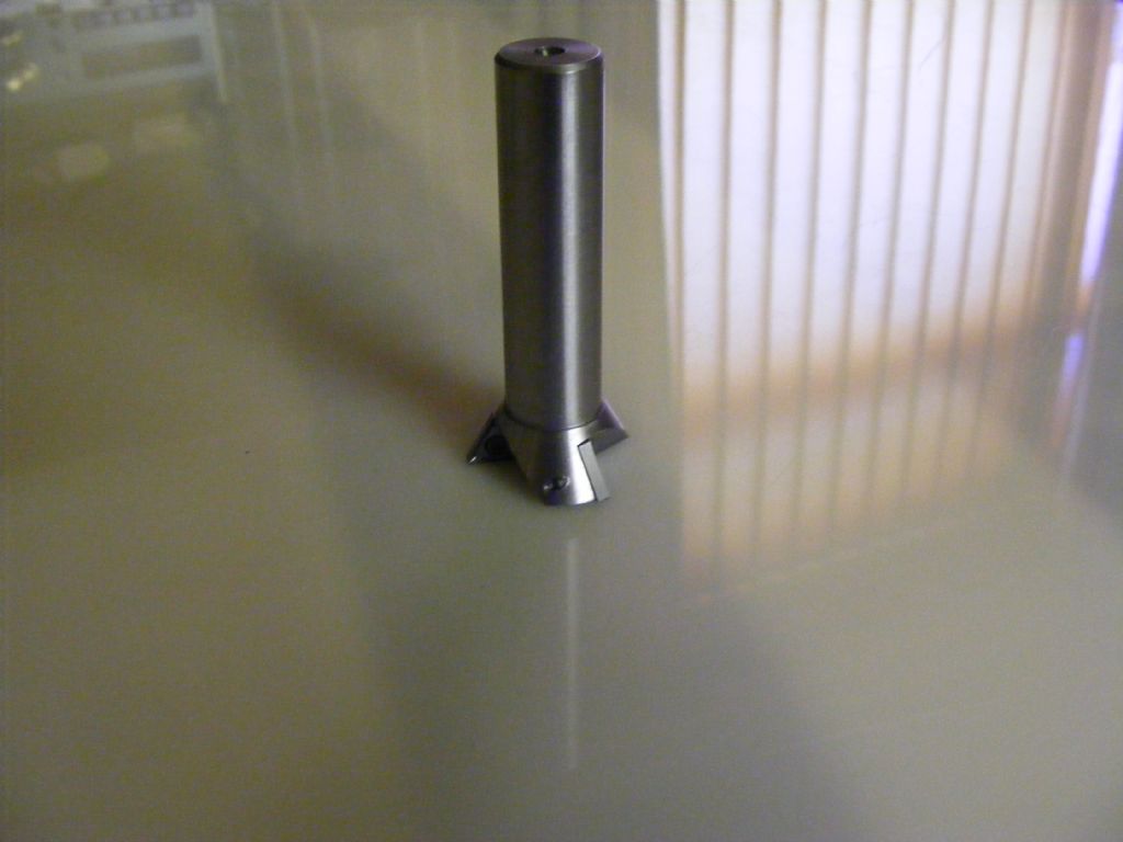

                        4.jpg3.jpgAs promised here is the 3 insert version. Cuts like a dream [ even better that the 2 insert version ] This one is not EN24 this one is from a bar of Ø 30mm Silver steel. I put it between the bench centers and I have gotten slightly closer in matching the inserts to each other. 2 insert one was 0.005mm 0.007mm, this one is slightly better giving 0.004mm 0.006mm. Very "soft " cutting action. Ah but alas, there is a boob which I never noticed until I was almost done !! Can anyone spot the "boob " ? Needless to say if it hadn't worked so good I would have scrapped it and started again. 2.jpg
                        #254034
                          Posted by Raymond Anderson on 04/09/2016 11:23:13:
                          Looks fine, provided the mill runs sweetly in reverse.
                          Edited By Michael Gilligan on 04/09/2016 11:56:47
                          #254040
                          Raymond Anderson
                            Gold star Michael,star I set the dividing head up the wrong way. Just as well the collet chuck has drive dogs. so I can run it in reverse without the drawbar loosening. What a "buffoon I am ".
                            Cheers.

                                #255097
                                Raymond Anderson

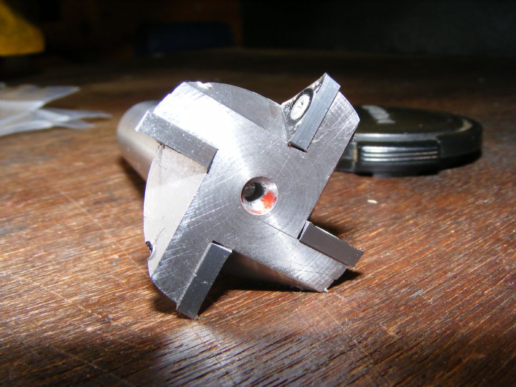

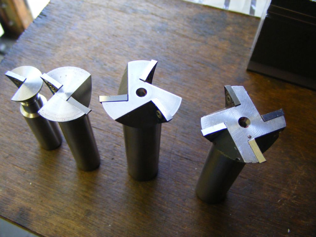

                                  Finished the 4 insert version made from Silver steel. Tested it on the same piece of 4140 that I used for testing the 2 and three cutter versions. Result, Cuts sweetly, very, soft action. Ignore the blemish at the top of the dovetail, as that was where I tested to see how deep a dovetail I would get with a 09 insert gets 9mm, that blemish was from trying 9.25mm. Have stuck a few mpre pics in the Album Dovetail cutter.dovetail cutters 027.jpgswarf type.jpggang of 4 b.jpg
                                  #255113
                                  Rainbows
                                    @rainbows
                                    At what point can a man say he has too many dovetail cutters?
                                    Is the only thing that keeps the inserts located the screw?
                                    #255121
                                    Raymond Anderson
                                      Different size of inserts, The single , 2 and 3 insert versions use 1102 inserts that can give a 11mm max Dovetail. The 4 insert one uses 09 inserts and will give a 9mm max dovetail. I think thats enough for me now. Yes, it is only the [ correct size ] screw that holds them in. If you are ACCURATE in the mounting location, they can never move.

                                                Hello capnahab, Thanks. Yes I did Watch the video you mention. The cutters work a treat [even the one that I have to run in reverse because I set the dividing head up wrong ] I was at a bit of a loose end and had thought about making a 2 insert one, then got carried away a bit and ended up with 4 smiley. Enjoyable little project [filled in a couple of hours ]
