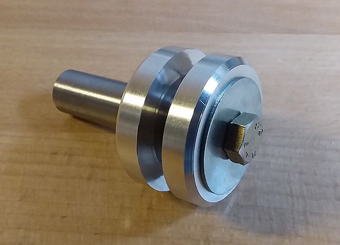

        This is just a quick 'show and tell' about this honing setup I just completed for my Myford ML10.

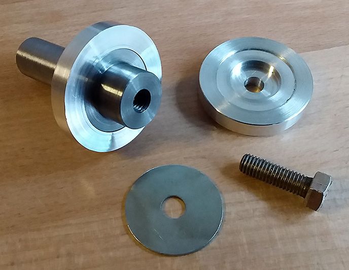

        The inspiration for this project came from a recent video I found on Youtube. This video showed an arrangement for mounting a mandrel in a collet chuck to hold a diamond cup wheel so as to enable one to grind and/or hone lathe cutting tools. Naturally, a support table of some sort is also required. In this only do I really differ from the design I copied, opting for a different approach which will be shown in the photos below.

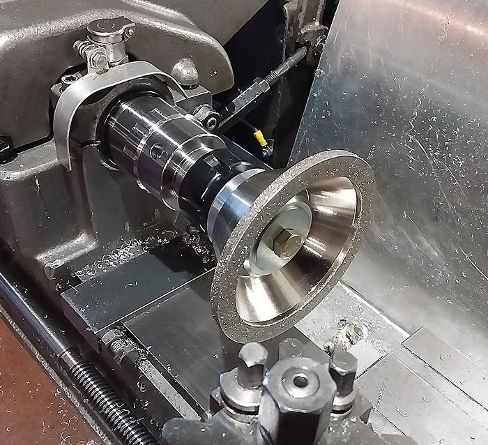

        The first requirement was a mandrel to swing the cup wheels. I turned this out of a bit of leftover steel from the scrap bin. The shaft is 16mm which is the largest diameter that the ER25 collet system on my lathe can grip. The stub mandrel itself is 20mm in diameter to fit the holes in the diamond cup wheels I bought.
        As the steel shaft wasn't really wide enough to support the diamond cup wheels to my satisfaction, I used some Loctite 638 to bond on a section of aluminum rod which was then turned to suit. The clamping plate is also turned from this same aluminum. Sections of steel might have been better, but the ML10 doesn't turn that fast (max 845 rpm) so that this connection won't really ever be under that much stress.

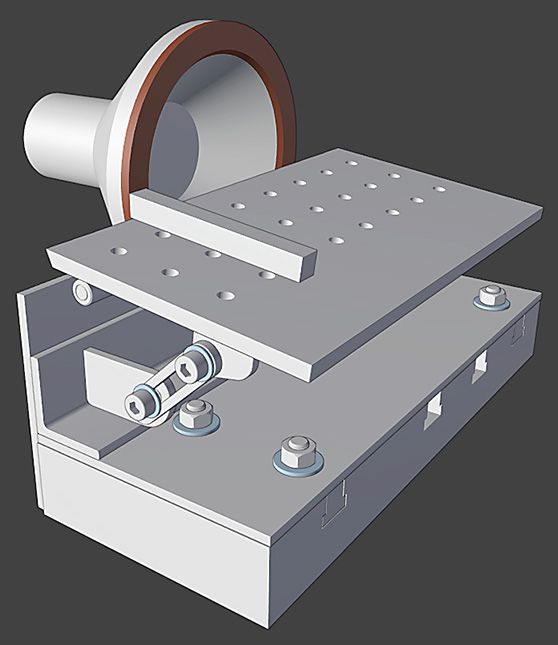

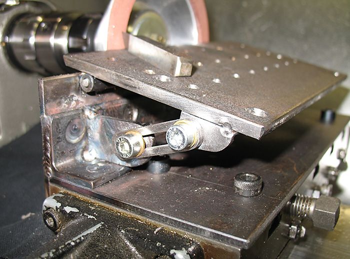

        The finished mandrel worked a treat, so it was time to get on to the business of making a support table. The original design was just a long plate of steel bolted to a wide bit of rod, which is held in a massive chunk of steel which mounts to the cross slide. That design works but didn't offer quite the range of angles I wanted.
        My own table design was (again) somewhat dictated by what I found in the scrap bin, ending up being a conglomeration of hot rolled steel plate and bar stock. I then used the freeware 3D program Blender to visualize what I wanted to create.
        My chosen method of construction for this support table was to cut and mill the parts to form after which I joined it all up with the TIG welder, then milling the parts again as required to remove (some of) the inevitable distortion from the welding process. It pretty much worked out as planned.

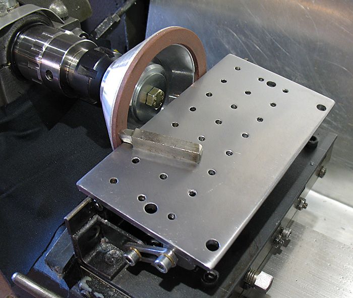

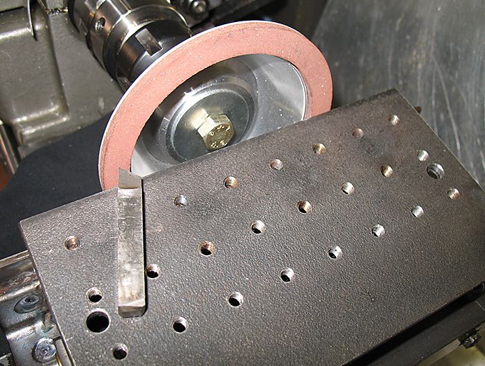

          Just below you can see the finished table.
          It is not really so good looking as the computer model (what ever is?), but it functions quite well. The small holes in the top of the table are tapped for M5 screws in case I ever feel the need to clamp down parts or guides. The larger holes in the top of the table were an afterthought to allow an allen wrench to poke down through to tighten the cap head bolts in the T-nuts that secure the unit. As a construction note, I chose to drill spaced holes along the length of that bit of L-channel and then made plug welds in each one to join it to the plate(s)
          I should note that I also used the Blender 3D program to 'animate' the action of the table so as to determine if the little slotted support was long enough (before I made it), but also to check that it had no interference in operation.
          The front vertical plate of the table design extends down to (somewhat) protect the T-slots from grinding dust. Of course, anyone who decides to do honing on the metal lathe is well advised to cover everything and make liberal use of a vacuum cleaner and rags to clean up after any grinding operations.
          I've already put this table into use and it works a treat. It isn't perfect, but it serves quite well and was worth my time and trouble. The only things I might change: (A) It would be nice to make some sort of screw adjustment for fine setting of the honing angle and (B) I think I might lightly mill the top of the table as that hot rolled plate is not completely flat.
          Hope this inspires some of you. wink

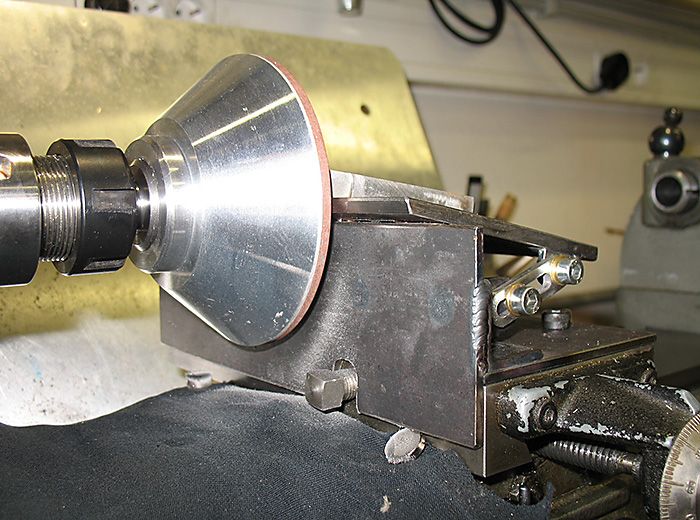

                              Just thought to post this last image of the honing support table in a more finished condition.
                              I spent quite a bit of quality time ( probably way too much time ) cranking this support table back and forth on my little milling machine. The whole thing took simply hours to finish, mostly because I was doubtful of how secure the clamping of this part was. As a result I took only very tiny passes ( 0.5 mm ) to accomplish the task. Even then, the part was a bit wider than the travel of the Y axis on the milling table would handle and so the last 4mm of the edge farthest from the diamond wheel was skimmed off in the bench vise using hand files. The final finish was obtained with a series of flap disks, sandpaper, ending up with a Scotch-brite wheel.
                              The actual functionality of the support table has not been improved so very much relative to the time I put in, but the tools to be honed can certainly be moved around more easily. And, of course, there is that warm, fuzzy, good feeling of having a nice, smooth surface.
