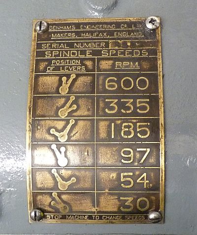

              #160100
              John Baguley
                @johnbaguley78655
                Hi Steven,
                Thanks, I'll have a look tomorrow. I did have a quick look earlier tonight but couldn't see anything obvious.
                Re the brass plates – do you mean those on the various control levers? If so, I can take some photos for you.

                #160173
                John Baguley
                  @johnbaguley78655
                  Hi Steven,
                  Ok, found a number but it's pretty much worn away. The first two digits are 10 and the third looks like a 6. According to Lathes.co.uk that would put it around 1958 but I'm wondering if I'm reading it upside down. It must be earlier than that as it has a plate on it saying it was reconditioned in November 1955.

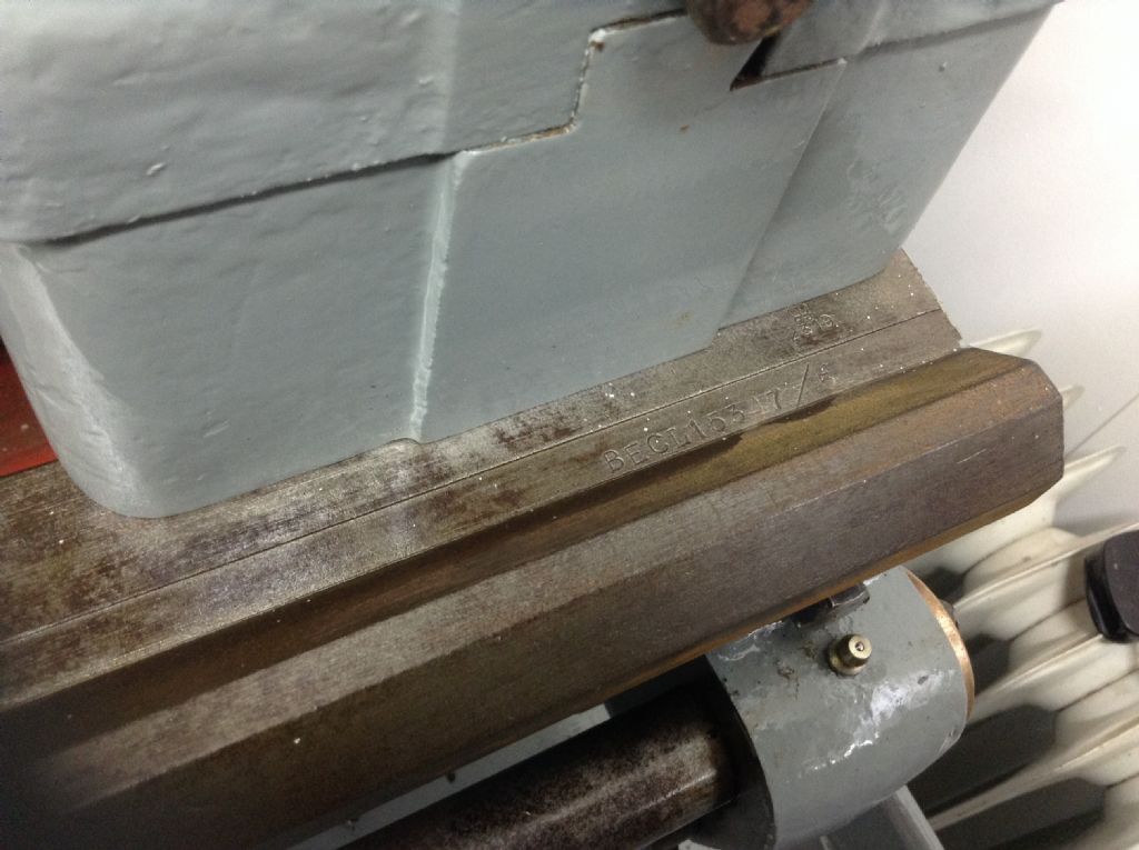

                      #160207
                      Steven Durnford
                        @stevendurnford68413
                        SerialThanks for that John, much appreciated. Here's the serial number position on mine, quite clearly stamped.

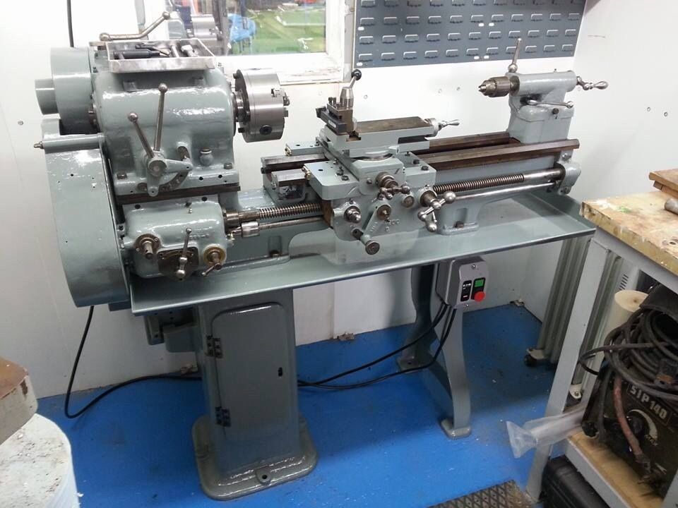

                        #160289
                        Steven Durnford
                          LatheHere's mine at the moment, just a few small detailing jobs left to do now. The only differences That I can spot between ours is that mine has a slightly longer saddle, (I have a lead screw cover missing on the left but would like to make a lead screw indicator dial to fit here), I also have a 1" plate that is under the headstock gear assembly gearbox to increase the swing, I'm pretty sure that this is a factory modification because the end of the plate looks like it was from a casting and that the tail stock base casting is an inch taller to compensate.
                          As I said, when I got it the whole cross slide assembly was absolutely horrible, totally wrong. I managed to get the present cross slide from a scrap yard, but I needed to mill out the dovetail in width, make up a gib strip and machine up a new bronze cross slide nut. The lower worm screw assembly in the saddle gearbox was seized up due to rust, this was an absolute nightmare to get out, lots of head scratching on that one, but got there in the end and the power feeds work fine.
                          #160316
                          John Baguley
                            @johnbaguley78655
                            HI Steve,
                            That's looking very nice indeed smiley I remember I had a right job to get the saddle gear box etc. to pieces! That extra centre height would have been useful on mine as I could have then used some big indexable tool holders that someone gave me. As it is they are too thick.
                            I'll collect my camera on the way home from the pub tonight and get those photos for you tomorrow.
                            I notice that your workshop floor is blue as well so I don't feel so bad about mine now!

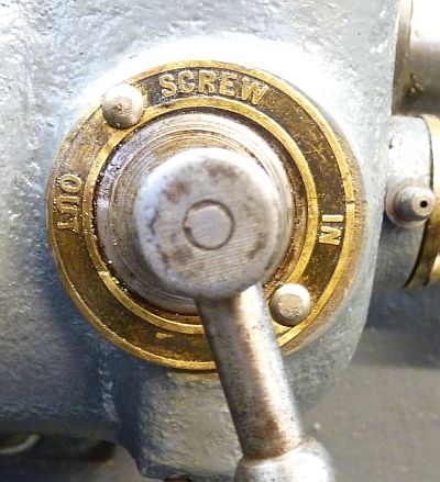

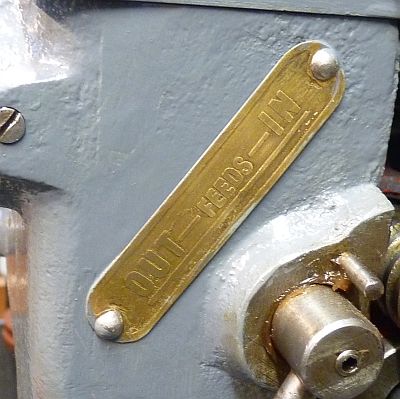

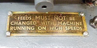

                            #160402
                            John Baguley
                              @johnbaguley78655
                              Hi Steve,
                              Right, here's some photos:
                              I realised as soon as I took the photo of the speed plate that the serial number is on this plate! I would guess that the serial number you have found is not the Denham number but a Ministry of Supply. MInistry of Defence, or similar number. The crown would suggest this. Mine's got a brass plate on the door which says Ministry of Supply with another number on it.
                              Mine is 8205 making it 1943 which seems right to me.
                              Anyway, hope the photos are of some use.
                              PS must clean those plates up!
                              #160468
                              Steven Durnford
                                Many thanks for the pics John, very helpful. The only plaques that I have on it are Carriage Direction, A-B-C, Feeds In Out, and one on the top end belt guard showing belt direction. The only other witness holes from other plaques are on the front of the lower front guard, the left hand side of the headstock cupboard, top right above door on headstock cupboard, and the one on top of the lead screw gearbox. So if the number stamped in the bed isn't the serial number then I can't really date mine. The chuck speeds were faster than the legends on your Spindle Speeds plaque, so I've sourced a slightly smaller motor pulley, just as well because there was a bit of belt rub inside the guard so I guess it needed it anyway. I've attached a pic to show the 'height adjustment' plate under the headstock gearbox.
