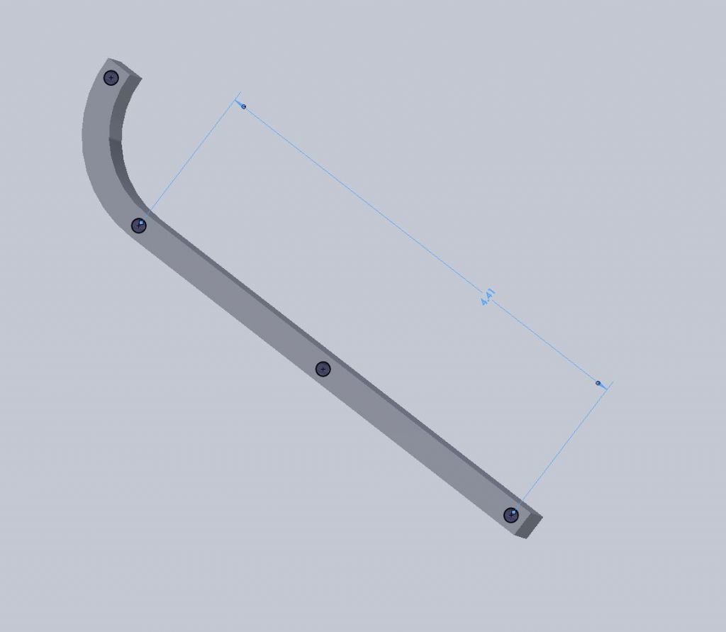

      Hello
      For manual machining, how do you go about choosing what materials to buy when looking at a project, and how do you make the most of what you do buy? Is there a proper method for determining the best stock shapes and sizes to acquire to create the parts most effectively and economically? How do you minimise waste when machining odd shaped pieces?
      For example if I have this part (quick measurement for scale is in inches):
      I am guessing you would start with a rectangular piece of flat stock the same thickness as the part, use a rotary table for the curved parts or get clever with mounting the stock on an 'axle' and rotating the part against the mill, and then mill the straight edges?
      However, even if you solve the 'curves' problem, you are left with an odd shaped offcut and potential waste.
      Is this all just part of the black art of machining? Finally, any recommendations for good value materials suppliers in southern UK?
      Cheers!
      PS apologies for any improper use of terminology, please do let me know if there are more accurate terms I should use and I will update the ol mental lexicon

          Hi Ross it would depend on the use of the item. If it was mild steel l would possibly use a strip of steel slightly bigger than finished sizes heat the bent end and bend it round a bar in a vice and machine to size after. If it was to be made from ground flat stock (gauge plate) l would machine it as you say but save the waste to make something in the future.

            If the specified material is nothing special, obtain some black steel flat bar not smaller than the required cross section. Heat and bend the portion that requires to be bent. Drill and counterbore/countersink (as required) the holes. The last thing I would do, quite honestly is to machine the part from a piece of plate, that's a huge waste of money, time, cutters etc etc

              I should have said, its going to be aluminium, so perhaps the bending idea is the way to go.
              #340126
                You buy someone else's offcut from e-bay and then sell your smaller offcut to someone else on e-bay.
                In reality the offcut goes into stock and gets used for a future project., if you are making more than one then nesting the parts will help reduce overall waste.
                Certainly would not be machining it all away, couple of saw cuts will remove most of what is not needed from flat bar or plate then you will have a minimum amount to waste as swarf and little cutter wear.

                    • Minimise the material used – your example this could be bending, or angling the work to fit in a smaller rectangle.
                    • Maximise the size of the remaining offcut.
                    • Find something in the scrapbox that suits.
                    When buying or cutting off material I always assume I will need some extra for holding the workpiece. I always try to allow enough so I can use it for some other purpose.
                    When I buy cheaper materials (e.g. mild steels) up to about 1" I buy it in 3m lengths cut into 1.5 or 1m lengths.
                    #340136
                    Mick B1
                      @mickb1
                      The first thing I'd do is look at the function of the component and see whether I could either use a cheaper and more easily worked material, or redesign the shape to suit the facilites I have.
