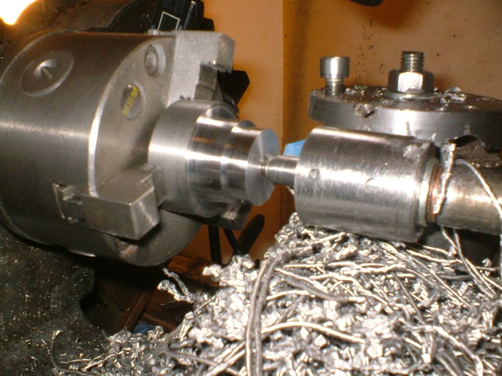

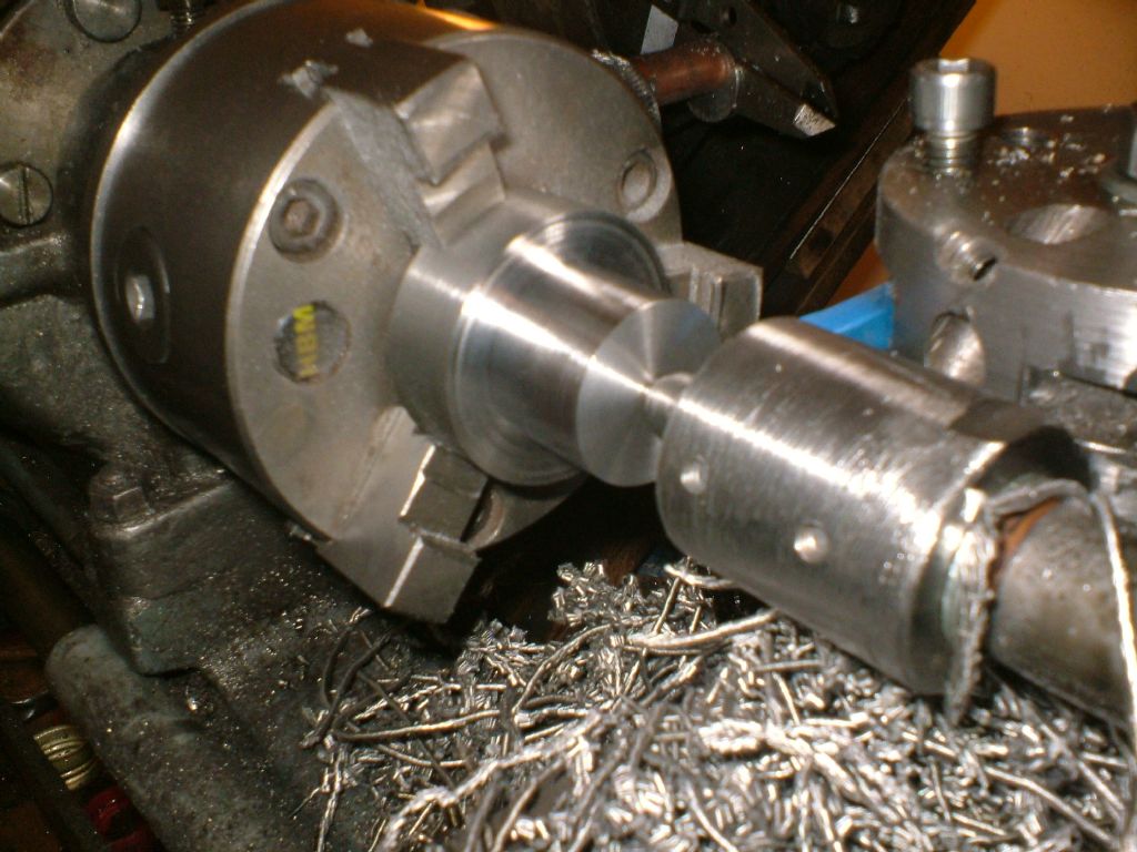

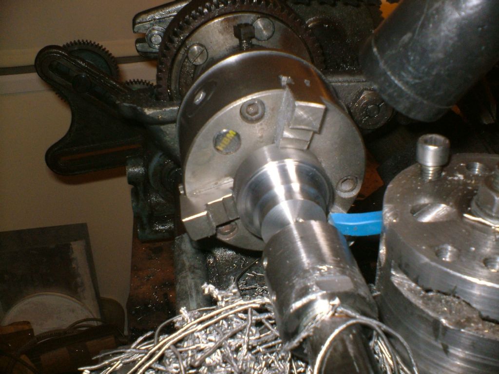

                        Carbide can be great once your hobby lathe is set up properly and you sharpen the tips up.
                        I created a bit more stiffness by tightening my thrust washer a bit more and no longer have any chipping issues, now I need more power and am after a better motor
                        This is a 2.3 mm cut on a 50mm bar so I can hack off nearly 5mm with each pass(8mm shank carbide tools), you can see the step in picture 2
                        The great thing is they can do a huge amount of work between sharpening, I am cutting from the back so the roughing down mess doesn't spray all over me (well most of the time anyway), the lathe is a 70 year old Drummond M series
                        Once you get it sorted out, carbide is fabby, so don't ever write the stuff off
