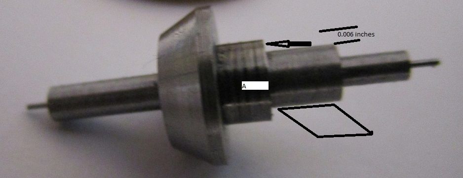

      staff showing undercut.jpgHi, I have been learning to use my Sherline lathe whilst simultaneously attempting to make a balance staff for a platform escapement off a clock. I have now largely succeeded as you can see from the photo of the first one i made from mild steel for practice. I have been using quality brazed carbide cutters upon recommendation and founfd this advice largely holds as the cutters have held their edge and no chips can be seen.
      So why the post well if you look at the photo one of the things it is necessary to produce is an undercut shown with the arrow. Baring in mind the cutter has to enter the shoulder without reducing the shoulder length on A you can understand with only a few thou this is delicate work. I would add I do this machining under optics otherwise not possible. Various questions arise as to possible improvements to cutters used as follows;
      1. The cutters I have used are termed super carbide as they resist chipping and hold their edge, they come pre-sharpened. However they are U.S products (Micro-100) do we make anything equivalent?
      2. Posters have argued that aluminium inserts could be used to machine silver steel that being the case I have been wondering if the 35 degree aluminium rhombus in a suitable holder would be suitable for machining the undercut having a sharp angle. I realise that sharper angles wear more quickly just wondered if only used for this small usage whether it is suitable. If it is can anyone suggest a holder for the V shape rhombus for something usable on the Sherline. The Sherline comes with 1/4 inch tool posts but there are 5/16 and 3/8 posts which I also have.

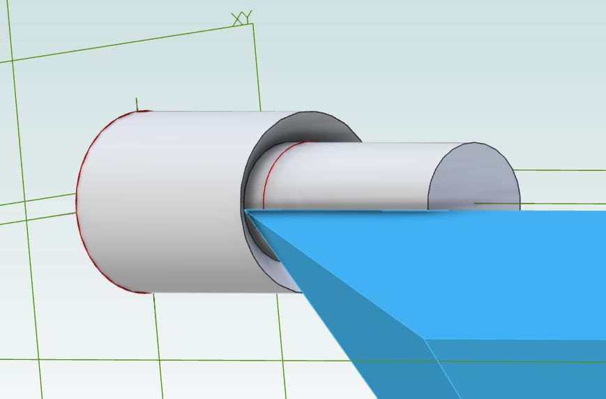

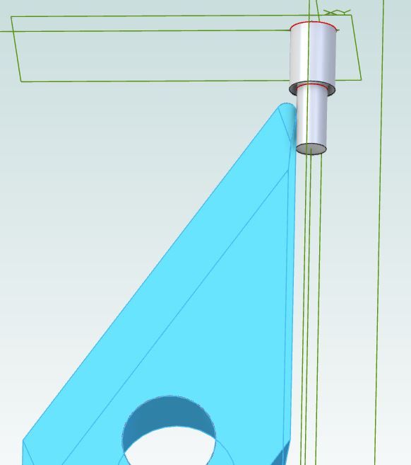

                            Forget using an insert, the most pointed you will be able to get will have a 0.2mm tip radius so not a chance in hell of that being able to undercut 0.006"
                            Even if you went for a Warner ground HSS insert which may have a bit more of a point the edge would rub.
                            So do as suggested grind a special, use a hand graver or ask your expert.

                              Thanks Jason, Your drawing demonstrates how difficult it is to machine such an undercut. However having now pursued both advocats of the traditional jewelers lathe verses the machinist route I now have a pretty good basis to air an opinion.
                              Firstly if using a jewelers lathe then you would need a graver or suitable cutter fashioned to a very fine point held against the shoulder and with light pressure so as not to break its tip an undercut could be made without damaging adjacent material.
                              Secondly using a lathe such as the Sherline you would have to either use a hand tool rest which there is one for the Sherline or possibly fashion a special tool / tool holder capable of holding such a thin cutter.
                              Finally it has been suggested to me that possibly the undercut whose purpose is to aid metal to be rivetted to fix the balance wheel on is not critical…this is a contentious point but that is the debate, as yet beyond my grade.

                                        To clarify the undercut is best explained by a photo. The idea of the undercut is to leave the top part of the shoulder with thinner metal that can be staked so using it as a rivet to hold the balance wheel on. I thank you for your idea of using a piece of round bar in my tool post as a rest…really simple cool idea.
                                        Another idea I have modified is to gring a 3mm tungsten drill into a cutter and mount this in a 1/4 square mild steel bar with grub screw held in my tool post. if I can get a suitable approach angle this will do the job.

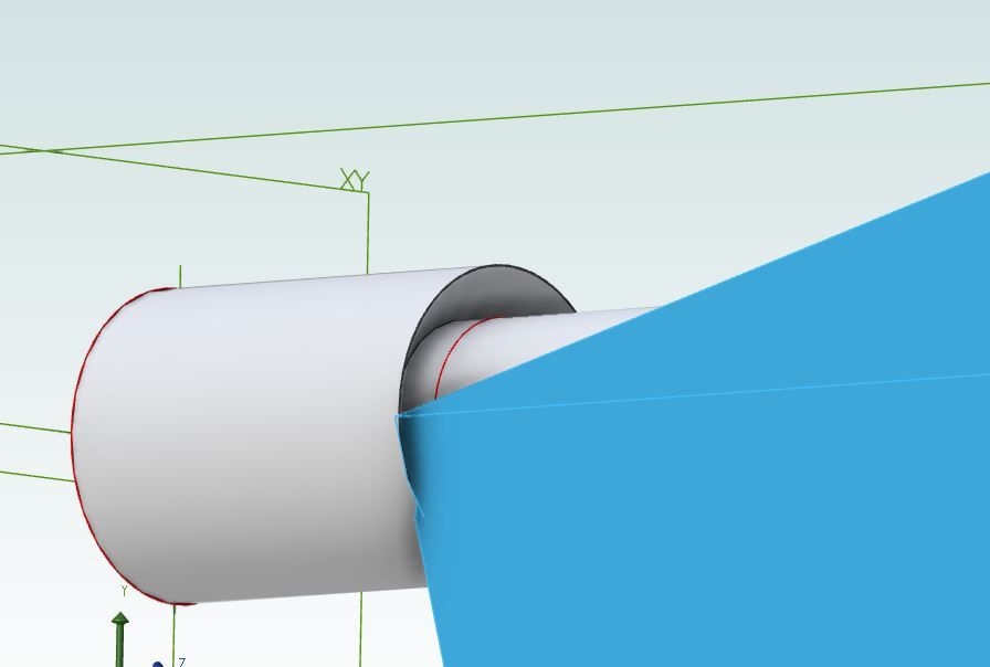

                                          Yes it's that angle that you need to watch.
                                          This is the same insert that I drew above but going to a point, these generally have a 7degree angle which would rib, assumed a 45degree undercut of the part
                                          Increase that angle and it will fit ok, I went with 27deg

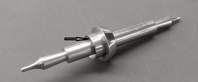

                                              These have been made by watchmakers using hand held gravers for more years than I care to think about. Many driven by a bow.

                                                However mass produced watches had turned parts with just as fine, if not even finer, than could be made by hand, with not a graver in sight.
                                                If the OP is wanting to make more than a few of these balance staffs then as good as Sherline is I cannot help feeling that there may be a high reject rate. The hand graver method has a lot going for it.
